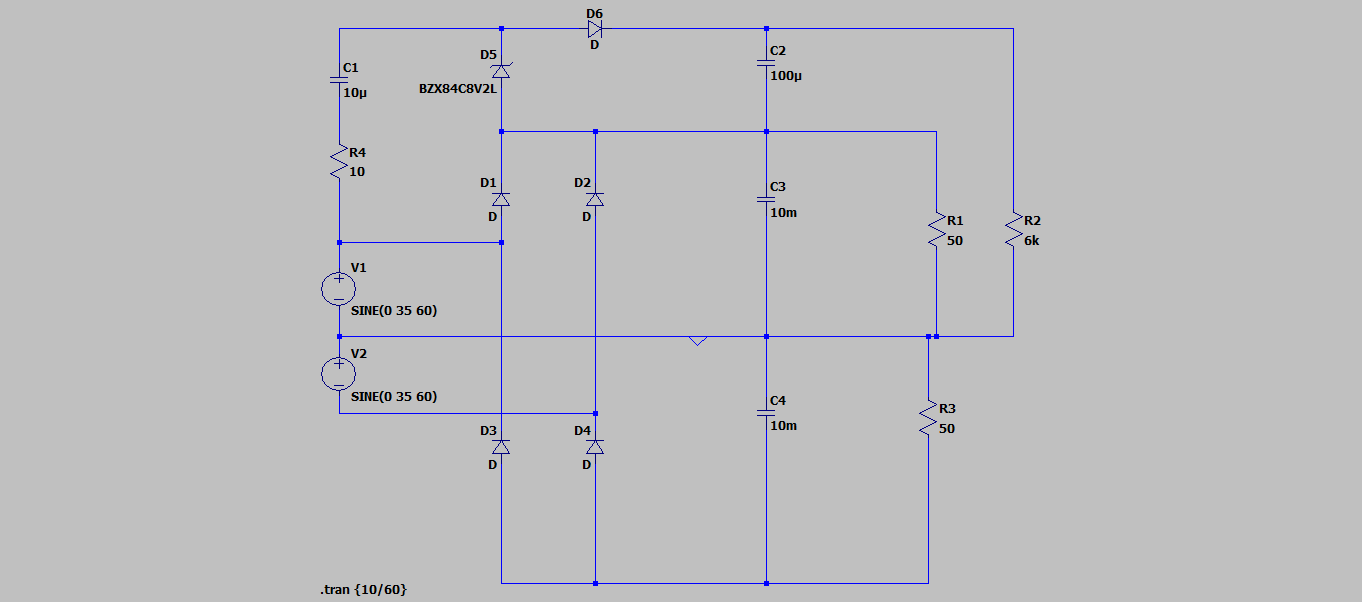

Usually there are better alternatives. This circuit uses a small AC capacitor to drop the main secondary voltage without generating a lot of heat. It's not isolated but usually that's not an issue. And there are alternatives such as using a phone charger (cheap).
Thank you for circuit. I'm trying to increase secondaries about 6.5 volts in order to get 28.5V AC from 22V transformer.
