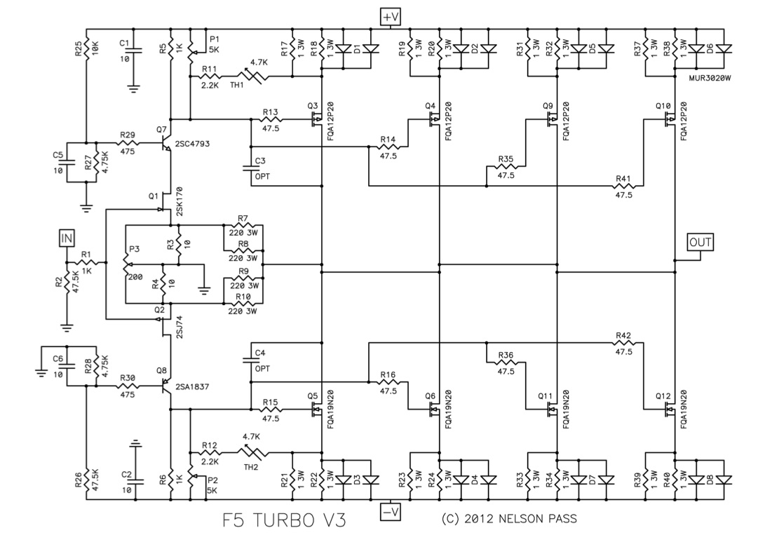

But have you used a TO 264 .... in general what is the way to overcome the capacitances.... Just increasing the driver idle current will suffice?

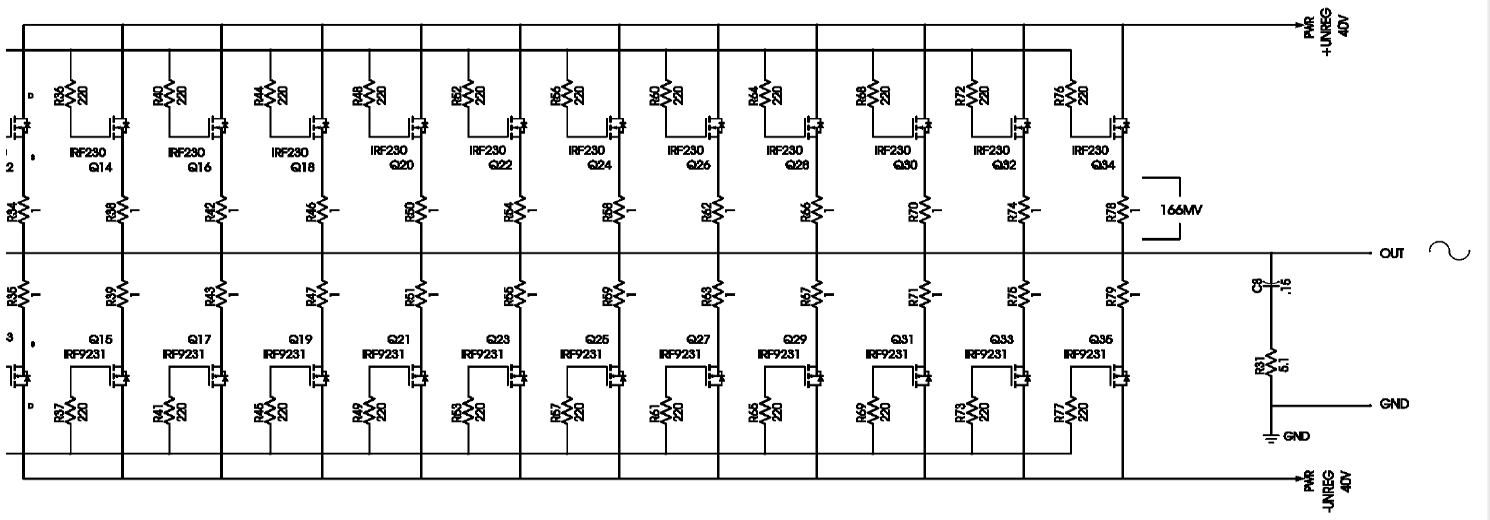

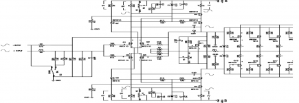

How do we overcome the effect of Cgd. Consider a 100W or 200W F5 to be built as the current F5 Turbo has got about 4 pairs of mosfets and I believe they are driven by a toshiba To220 package transistors. How many mosfets in total a 2sc4793 can drive without any issues. Secondly how is the stability wrt oscillations when paralleling 10 or pairs of mosfets.
The bipolars in the F5 Turbo are cascodes. In my book they only count
for shielding the Jfets from voltage, and don't really affect the drive to
the output devices.
But your question nicely segues into another point worth making -
"How do we overcome the effect of Cgd."
Cascoding is an excellent way to remove Cdg and Cds. To the extent
that Vds, Vdg are held constant by a cascode, you are not charging
those capacitances.

then we need alot of output devices in that case way too higher but is it the way its implimented in x1000?

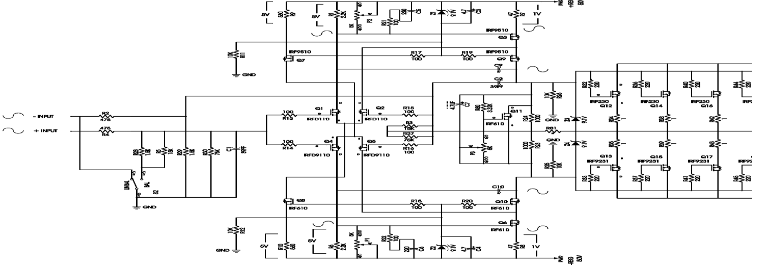

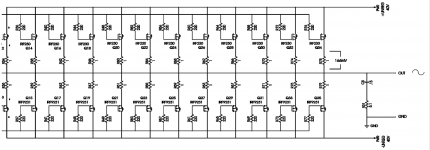

Looking at the A75 amp the massive output stage was driven with IRF9610 and IRF610 were they sufficient to drive them?
What is your criteria for "sufficient"?
Well produced 100Khz Squarewave instead of distorted because of unable to drive the non linear capacitance from OPS. Not by the IPS or VAS.

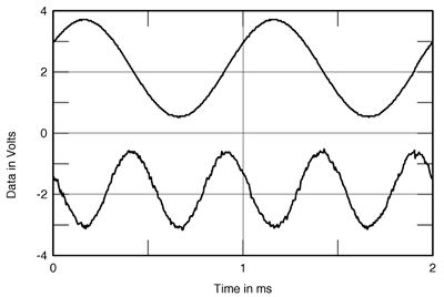

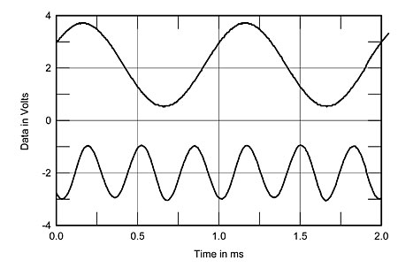

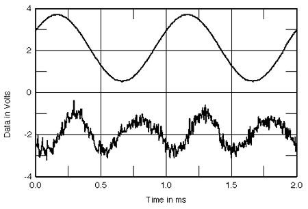

When looking at Fig. 4 (distortion and noise waveform with fundamental notched out) under
Pass Labs X1000 monoblock power amplifier Measurements | Stereophile.com
I note the following:
Despite the superimposed noise signal (possibly due to an older measuring system), it is noticeable that only every second curve has a sine wave character, while the first, third, fifth etc. has a triangular character. What is the reason therefore ? Maybe the kind of VAS-driver stage ?
When looking the same measurements (with fundamental notched out) of aleph 3 (mainly H2) and XA30.5 (mainly H3), there are no such effects and the sine wave character remains - go to the attachments and to the reviews under

Pass Labs XA30.5 power amplifier Measurements | Stereophile.com
Even while listening tests the X1000 always seemed a bit more crispy and harsh to me.
Because I haven't a detailed circuit diagram, follow question rises up:
Is in the front-end only one gain stage in use (folded cascode) according the simplified schematic under
PassDiy
or operates an LTP-stage together with a push pull VAS stage like in use at X250 according the schematic in post #37 under
Pass X250 repair
(according the owner's manual of X250 there is also a folded cascode in use - obviously there are even various versions of X250 on the marked without ".5" and ".8" suffix) ??
The front end stage and output stage are completely different between the two series amplifiers. Starting at the input stage with fet vs mosfet and the type of bias in the output stage and configuration of the transistors. The X1000 also had no global feedback so the amps are very different.
