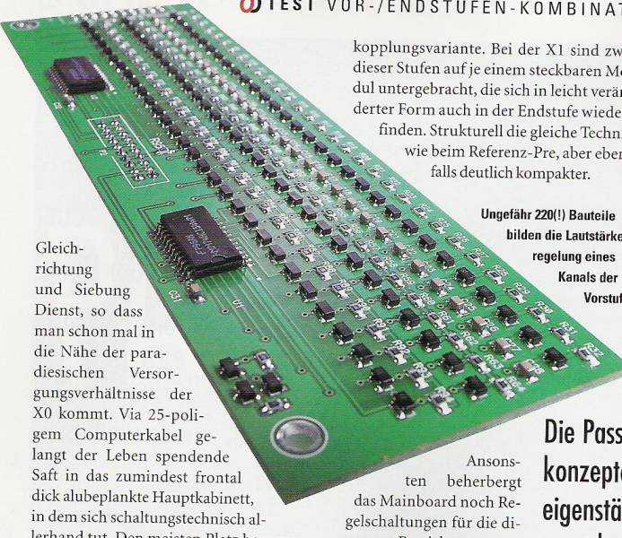

I've been looking and i see a few products now with a digital volume pots and stuff. I'm wondering how they do it.. i can see from pictures they use surface mount transisters one transistor per step with a resistor to change the volume out put. Does any one know how this could be done. Maybe with a rotoray control of some how ect ect. to turn on each transistor. Id like to try and build one.. So far i have seen the pass labs pre-amp and the conrad johnson pre-amp's and a few others.. Any one got any idea's. ? I don't want to step on any toes but it would be a good project and be able to hear silence when turning up the volume instead of relay's..

it's "just" a ladder of resistors, you change the "bottom" resistor in the ladder by turning on or off a transistor in series or parallel with a resistor..... simple system really - in theory.... the problem is getting it to work without noise from the switching..and getting rid of the noise from all the large resistors... you should go SMT IMHO to minimize the size of the thing

I guess ill have to wait ? I dont want to patent any thing i just want to build it and learn 😀
What do you think of this type of circuit nelson. What would you prefure a pre amp with all them transisters or a nice alps / DACT pot ?
Ok I found it. Id like to build this.. SMD i know what the small signal transistors are but i dont know what the digital ic is to turn each transistor on one at a time..

Ive got the "schematic" i'm working on it right now.. Just need help now to desifer the chip that turn's each transistor on one at a time. I presume the Voltage ? audio signal goes through this chip and is then gone through a ladder resistor then to the output.
The reason i wanted to build this was to A gain experiance in SMD part's and more eagle board layout time. B to build my OWN pre-amp board's..
