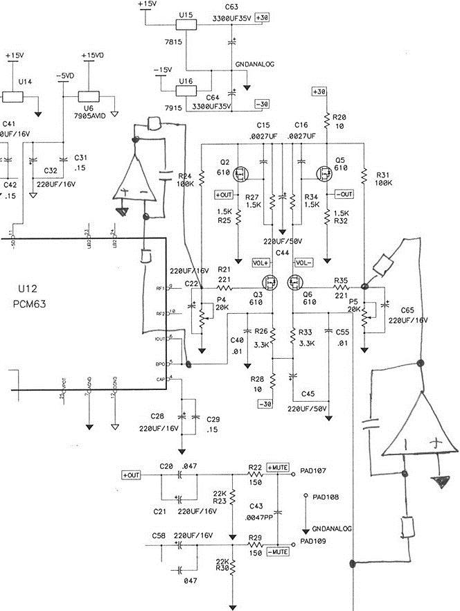

Hi folks,
By looking in the PCM63 DAC datasheet and datasheets of many other PCMxxxx DACs from Texas (= Burr Brown today),
I can see TI recomends connecting the current output, Iout, to a virtual zero voltage.
Would it be a good idea to add a (very slow regulating) DC-servo to the D1 I/V circuit, to ensure the potential at Iout to stay at zero volts ???
Please refer to attached draft.
