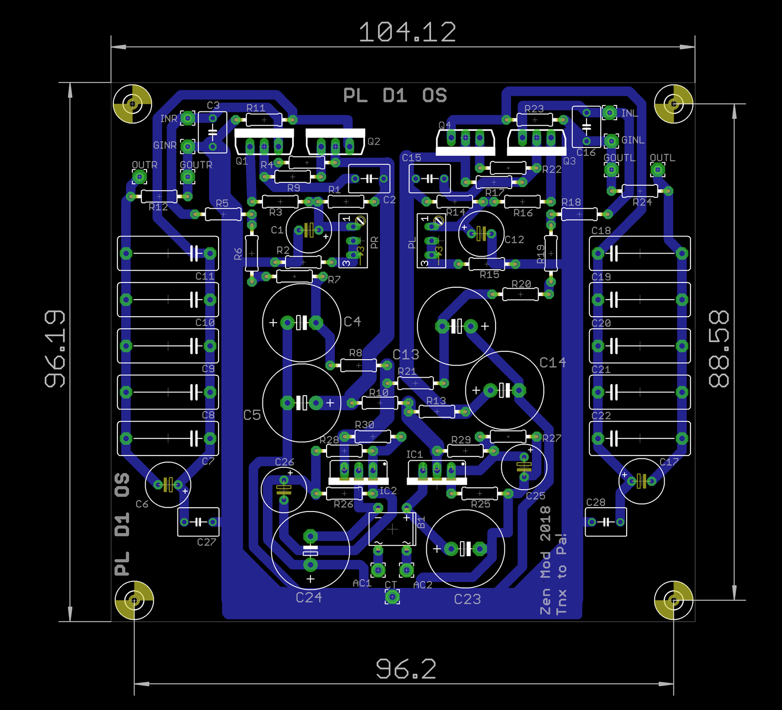

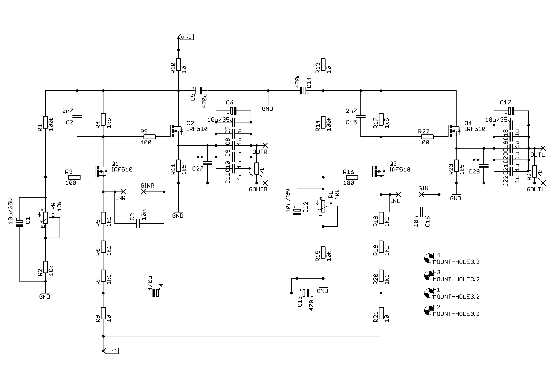

Let it be known that my idea was only moderately greedy.
Pop has already published the schematic for the Zen I/V, and the store has matched JFETs. We would just need a good PCB done up.
(I'd settle for a gerber if anyone is holding)

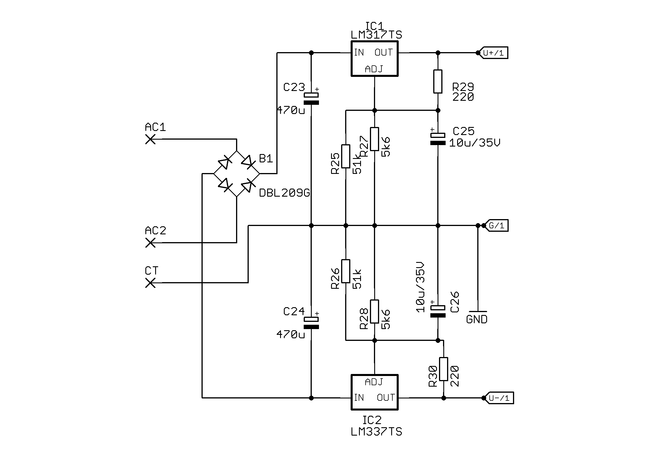

read datasheet of LM317/337, compute by your self from evident resistor values, curse me for a day that I'm Pompous Bstrd, and I'll reply tomorrow
Ha all good! I have the datasheets open, but I don't know how to identify I Adj from the schematic - the resistor values are pretty easy to find though of course
((R1/R2)+1)*1.25
freely ignore Iadj for calculation
take care that you have two in parallel for R1
resistor numbers taken freely, no connection with nomenclature in actual schematic
(((51K//5K6)/220)+1)*1.25=29V92
meaning - you need hefty 35V at reg input, even in case of mains sag (10%)
