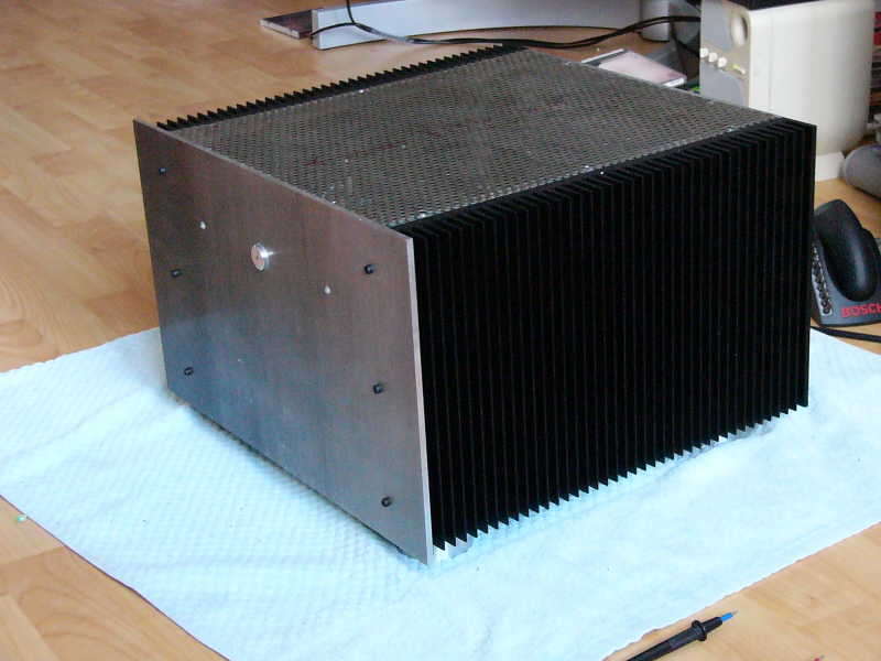

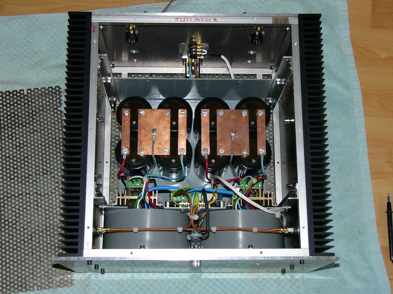

My Aleph 4.0 adaptation uses concept of two mono blocks in common enclosure with independent power supply for each mono block. There is only one common part – power supply soft-start control and input filter.
Currently finished parts are: enclosure, whole power supply and I'm waiting for powerstage components. Oh, and I forgot mentioned that IRFP240 are already matched to 4 groups with 6 pieces transistors (I have 50 pieces population of IRFP240). IRF9610 remains to matching very soon.
Here is look to inside of enclosure my PassLabs Aleph 4.0 adaptation:

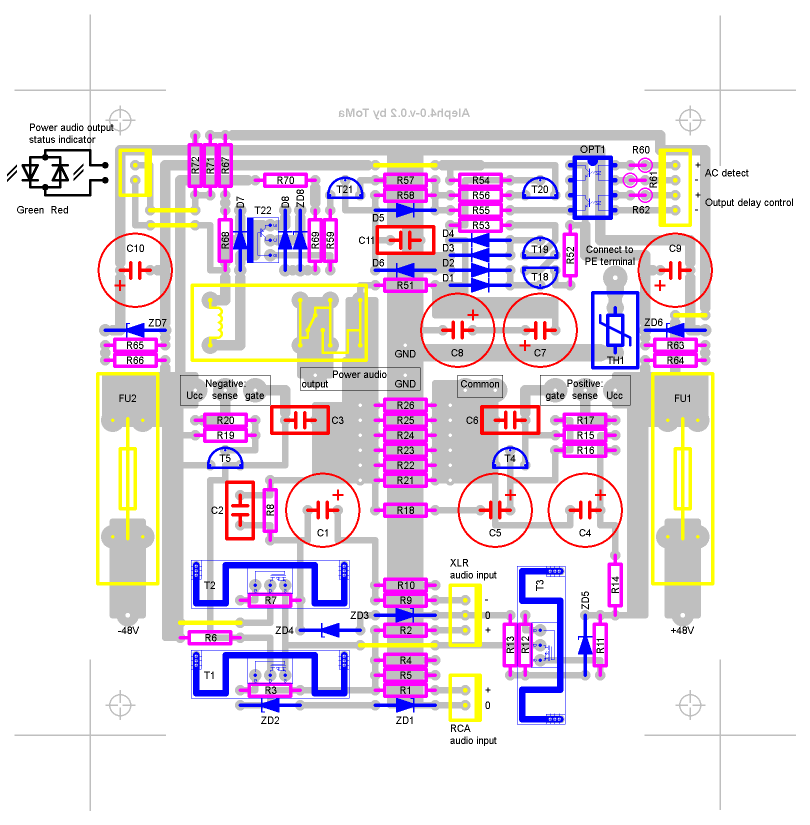

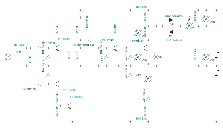

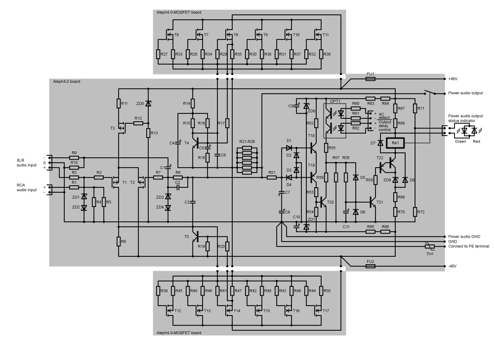

Audio part is Aleph 4.0 without any modification except replacement IRF244 by IRFP240 and my own PCB design. Power supply (with soft start – on/off sequencer) and speaker protection circuit are my own design. I prepare schematics in better quality and attach here.
Protection circuit must be part of each kind audio power amplifier without output capacitor. I follow this rule and it save my speakers many times. I also prefer delayed switch on amplifier output.
I didn't publish values because protection circuit is tested only in TINA simulator and not on real/physical circuit. So I can't 100% promise that this schematics will work without any modification. So, anyway. If you are interested here is exported schematics from TINA simulator.
Few notes to components values/types are here:
switching transistor controlling relay is replaced by TIP117 – TO220 in physical circuit
R13 (connected to emitter of TIP42 ) presents relay internal resistance - FINDER 40.61S, 24V/900R,One pole
zener diodes Z2 & Z3 1N3022 is replaced by BZX85/C15 in physical circuit
zener diode (connected to collector to TIP42) is replaced by BZX85/C24 in physical circuit
bidirectional dual color LED diode is BL-BHG234
switch SW-SPST1 in simulation circuit is replaced by LTV826/DIP8 in physical circuit
C1 47uF in simulation circuit is replaced by two 100uF capacitors C7 & C8 in physical circuit
Expected issues:
circuit sensitivity (too big)
insufficient current over dual color LED
