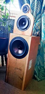

Just thought I'd update a little. I made a pair of 'bass modules' using RS225 sealed in about 28litres. Repurposed Wharfedale Laser 100 I bought cheap. Enclosures are span 90 degree to how they are as a Laser, and 12mm MDF added down each new side. Noico'd, foamed and stuffed with batting. No braces as of yet.
My initial thought is I'd like to try some OB mids and highs. I don't think I will manage OB bass. So I stared with a SB15 and an SB29 tweeter.
Funnily enough my playing in XSim with admittedly factory curves gave me some components remarkably close to the stock Wharfedale XO....so I had a go!
Sounded very decent although needed the highs attenuating...maybe the mids too. This is by ear BTW.
And then I recalled my RST28s and WG300 sat doing nothing. So I mocked this up. Again the values what XRK simmed for this WG design is close to the Wharfedale so I plugged in the RST28 into the XO. (4.7uf and 0.3mh) Sounded very nice. I did one at a time and the highs with the 28f seemed more subdued than the SB29RDNC. And I had attenuated the SB by 6db on that XO.
All pie in the sky without measurements I know. But interesting.
So one of these has 6.9uf and 1.5r series/ 3.3R shunt attenuation. The other is stock Wharfedale with 4.7 horrible old lytic and no attenuation. As a pair sounds very nice!
The RS225 is 2nd order 3.7mh and 25uf
So there is mileage in this 225/28f WG design!
Time tomorrow to swap out the old 3.7mh with some new much lower DCR jobs and to replace more of the old caps
