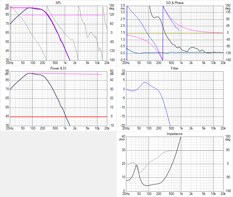

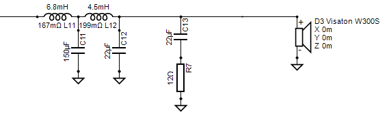

Doing a little more experimenting I came up with a slightly more practical resonant peak filter. This is probably doable. (all inductors are erse laminated core 16awg available at PE) The tradeoff for smaller inductor is bigger cap. Won't be cheap though.

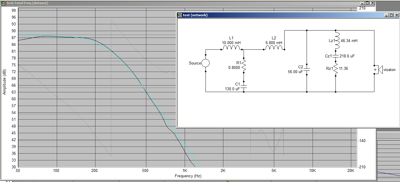

After playing around in Vituixcad with a notch here's what I came up with - similar to yours, which I hadn't seen until later - although mine has a zobel which changes the stop band response significantly and therefore all the other values as well:
attachment.php
The notch has a Q of exactly 1.0, centre frequency of 49Hz, and flattens the impedance curve perfectly. The blue line is the filter response, the red line is the response with the peak with the notch disconnected, and the purple line is the target response which you almost can't see because it overlays so closely even below -50dB.
attachment.php
Minimum impedance is still 5.4 ohms at 22Hz, but rises significantly above that and is above 6.8 ohms above 37Hz)

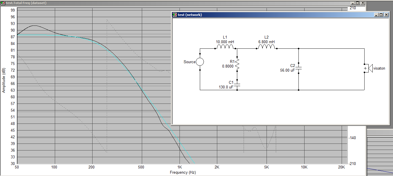

It's interesting to consider that not only is the filter applying a 4th order low pass response, baffle step correction (rollover point 230Hz) is also built in with no additional components just by retuning the low pass filter from the theoretical.
When I tried to do the same thing with a 2nd order filter I was only able to get a rough approximation not the very close match I get with 4th order. It just goes to show that the more degrees of freedom you get with a higher order filter can be put to good advantage in shaping the response. 🙂 (I made use of that shaping ability extensively in my last design)
So it's certainly possible to achieve the target response passively but 363uF and 28.9mH are quite daunting and would require a (by-passed) bipolar electrolytic and laminated iron core inductor to achieve in any reasonable space. While I don't mind a laminated core inductor (the series coils for the woofer will be laminated iron anyway) the bipolar cap is more problematic.
I have no idea what kind of current rating and ESR would be typical of a bipolar electrolytic in the 300uF range, and the prospect of increasing ESR and decreasing capacitance with age isn't that appealing.
Interestingly though because the notch is very low Q the capacitor value isn't particularly critical - it can vary all the way from about 300uF to 500uF before the response changes by 1dB. So a small amount of error in the capacitance value over time wouldn't be that critical. And up to an addtional 2 ohms of resistance in the string of cap/coil/resistor can be tolerated before the response goes out of shape by more than 1dB.
With a maximum input of 28.3v (100w referenced to 8 ohms) the notch string would peak at 1.8 amps at resonance at 49Hz. Is that something a ~330uF bipolar cap could cope with or is that pushing it too hard ?
Power dissipation of the resistance in the notch filter string (mainly coil and resistor) with 28.3v input would be a maximum of 35 watts at 49Hz. Feasbile, especially when you consider that 100 watts at that frequency would be a very, very loud noise, and well above any normal sort of playback level.

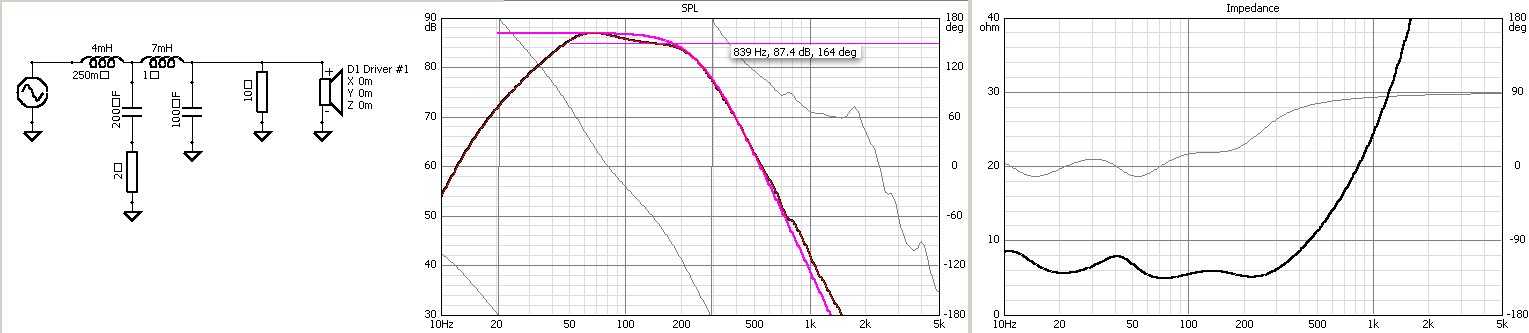

I'm notching the hell out of those bumps in the bass region.

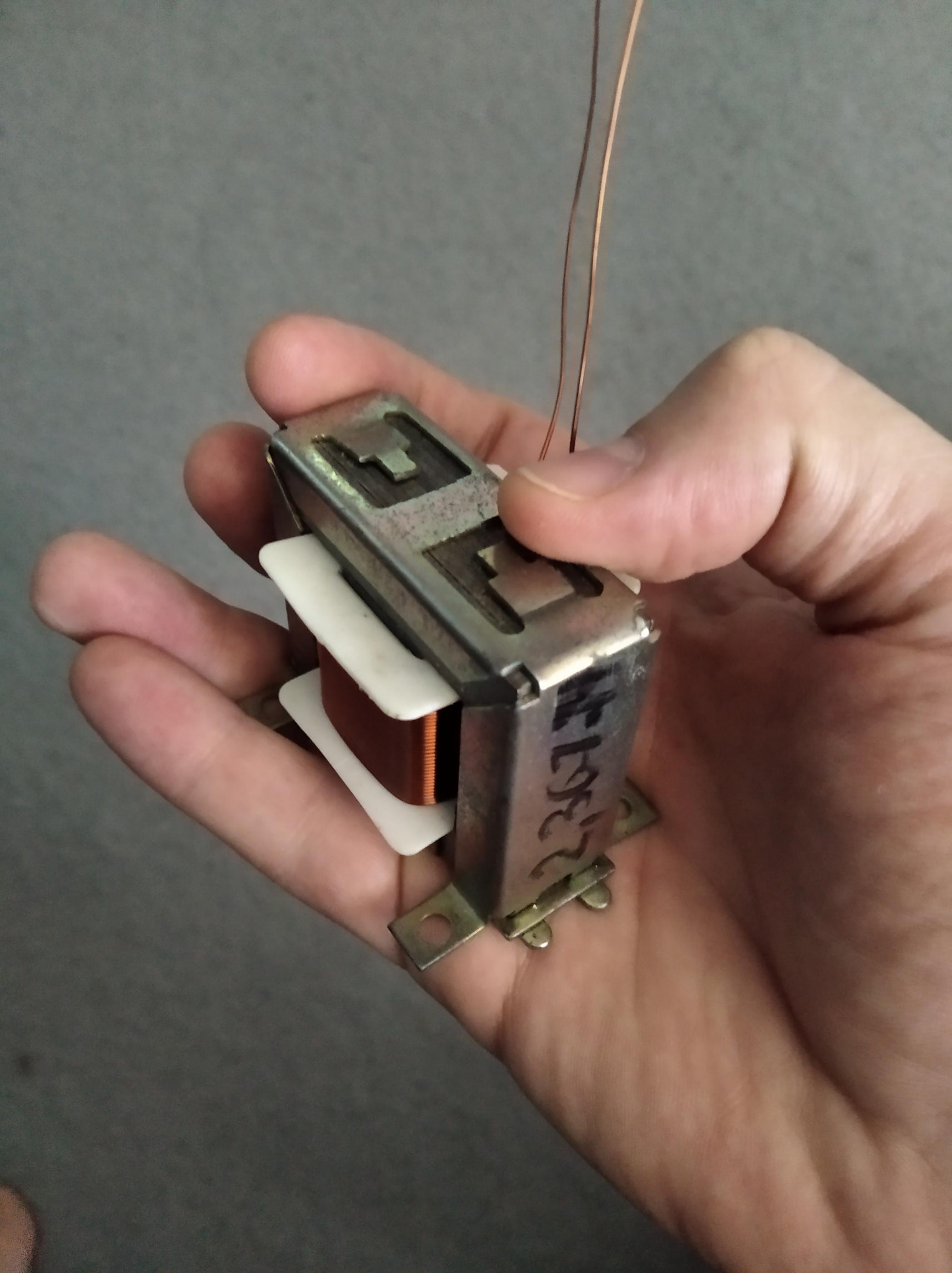

Would an EI laminated core of that size be able to carry that sort of current without saturation/distortion ?
Did you perform any high power level distortion measurements of your notch to make sure it wasn't saturating ?
I've measured distortion with few types of core. Here are the results:
Influence of inductor types on distortion performance
These EI cores tested aren't the ones i winded but i've bought them locally. They failed the distortion test miserably so i won't be buying them anymore. Bad alloy i guess. It would be nice to know what type of alloy is used by Mundorf in their EI coils.
Bottom line, getting the right core could be a problem. I would advise to use ERSE i-core inductors (they're cheap) and use your own wire. Kef R300 use ferrite coils in their notch (22mH) and in series with woofer (2.2mH). Their cores behave well in distortion tests.
Some cores saturate a lot easier than you'd think - in my previous 2 way (which is only rated at about 15-30 watts) the baffle step coil - about 4mH, which carries all the bass current was originally a reasonably large permite core which was claimed to be suitable for the application, however I was easily able to hear saturation (midrange break through) on certain kinds of bass transients. I swapped it for a laminated I core inductor of a very similar size and the saturation is gone.
I'd use Dayton or ERSE I core for that. I don't know what exactly causes the distortion in core material but here are few tests:

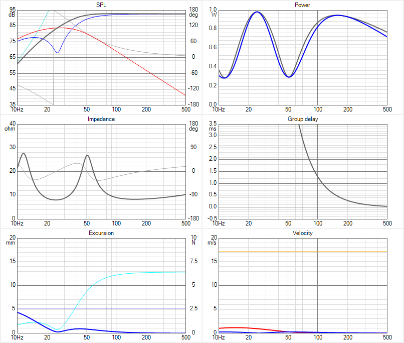

How're you notching those? Could the impedance-related peak be treated similarly?
IIRC, in a couple of his bigger 3-way designs Troels implemented a plate amp for the LF driver, and set it up to accept speaker-level inputs. ie, still usable with a standard 2-ch HiFi amp.
Apart from doing that, it looks to me like a big LCR network is going to be the only way to fix this one. You could use an air-cored inductor and build most of the series R into it. More wire, though.

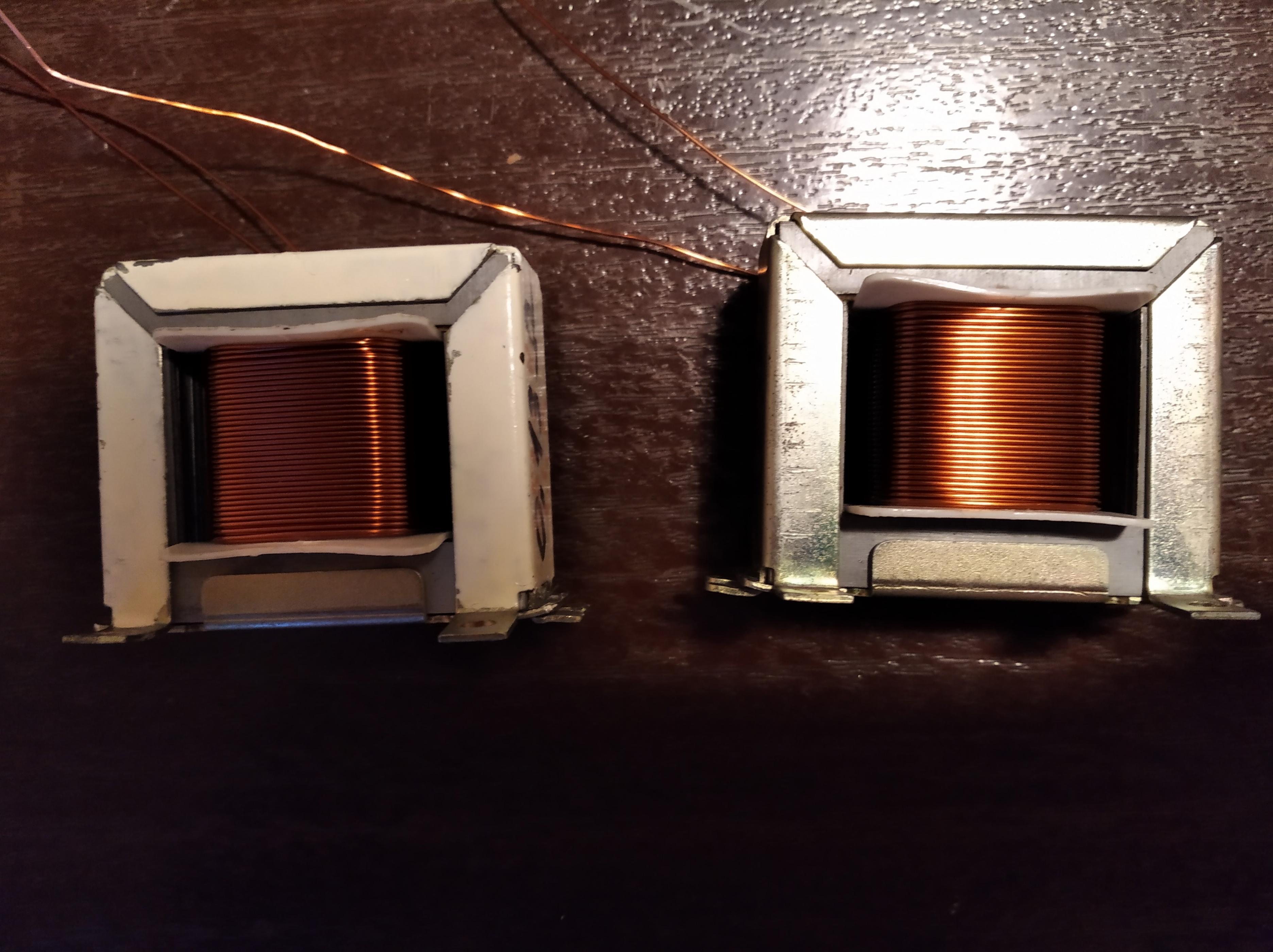

In this case, not so much! 🙁 I have a bunch of 5.6mH laminated steel I-core inductors I've had for years so took a few turns off them to get the value I wanted (which ended up being about 4.3mH) and substitued those and there is zero audible saturation on bass even when I push the speakers themselves to their limits - the midrange remains clean. As you can see the overall size isn't particularly different:
attachment.php
I don't know what brand they are, I bought them about 15 years ago when I lived in New Zealand. I have a vague recollection that I bought them from Jaycar but I can't be sure.
I also used a pair of these same coils with my Visaton woofers back when they used to be in closed boxes with active equalisation with a 100w amplifier - again, ferrite cores easily saturated on the bass (especially with the low frequency boost needed for the small closed box) but these laminated steel cores were absolutely fine right up to 100w with no audible saturation.
Core type really does make a difference.

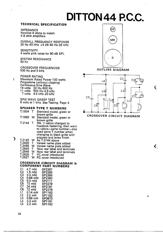

DBMandrake, I just wonder if you are making this more difficult than it really is.
For sure your Visaton W300S-8 woofer is giving you a hard time because the Fs resonance impedance peak is so close to your crossover point. Why not take the crossover higher? A 12" bass ought to be happy enough crossing at 500Hz.
And why use any old simulator when Visaton Boxsim and its built-in optimiser will do all the heavy lifting for you?
This Celestion Ditton 44 bass filter ought to do the right things:
You might add the odd ohm or two to the bass shunts with film type capacitors whereas Celestion used NPE types. But why reinvent the wheel? 😀
Yes that solenoid core is from Jaycar. It slides, which I've used to change its value. Maybe you have some EIs lying around that will fit?
By solenoid core I assume you're just referring to the I core configuration, as it was sold as an inductor for passive crossovers, not part of an actual solenoid.
The core doesn't slide on mine - they're well and truly glued to the former although it might be possible to break it free with enough effort.
The laminations are extremely thin - much more so than on a typical power transformer with E/I cores. Thinner laminations reduce losses at high frequencies and extend the maximum working frequency. They should be useable up to about 2Khz, however I have only ever used them to crossover/rolloff at about 300Hz or so which is well within their operating range.
I'm guessing that alloy used has a very important role in distortion jump when using laminated core. Mundorf uses EI cores of very similar size with same 1mm wire (as were those i measured) but they don't rise the distortion of woofer.

But to sumarise some points I learnt/confirmed from it:
* Laminated steel cores support up to about 1.5 - 1.8 Tesla field strength before satuartion, one of the highest of any core type. Ferrite cores are around 0.3 - 0.5T only. So a steel laminate core of a given cross sectional area and all else being equal can handle approx 3x the power of a ferrite core before saturation - at low frequencies anyway.
* Maximum power handling of laminated steel cores falls as frequency increases. But this characteristic suits woofer low pass filters well since current is high at low frequencies where the core can tolerate high power, and lower at higher frequencies where it cannot.
* Laminated steel cores depending on laminate thickness are useable only up to about 2Khz. The thinner the laminations the better for higher frequencies. (As they reduce eddy currents) You would only use laminated steel cores in a low pass filter of a 3 way system as the low pass for a 2 way would typically be too high in frequency for them.
* All else being equal a large core cross sectional area is needed to handle higher powers, or to achieve higher inductance values with the same power handling. Adding more turns to a coil to increase the inductance increases the flux density for the same current. (brings it closer to saturation)
* There are other materials like iron powder cores which have characteristics somewhere between ferrite and laminated steel. (I wonder if Jantzen's "permite" cores are iron powder cores ? Permite seems to be a brand name used by Jantzen that doesn't show up anywhere else I can find)
* Introducing a gap, even a very small one into a complete magnetic loop, as in an EI or UI core dramaticaly drops and stabalises the permeability and greatly reduces the tendency to saturate. (But the drawback is more turns of wire are needed because the permability is reduced) This is even done with toroidal cores where they are cut in half, ground and lapped, and glued back together with a gap as small as 25 microns.
* An I core ("solenoid core", or rod core) like the laminated steel ones I have fundamentally has an air gap in the magnetic path because the flux travels through the core and then out around the coil in 3 dimensions through the air back to the other end, same as a bar magnet. This "air gap" in the magnetic path lowers permability dramatically but also dramatically reduces the tendency to saturate. The drawbacks are lower permability (more turns needed) and a poorly contained flux field - so it will be a lot more sensitive to nearby steel, other inductors etc unless oriented at right angles and spaced well apart.
It was a bit disapointing in reading that otherwise very in depth design book that I cores are basically not mentioned in any detail. As the focus of the book is primarily transformers (which almost always use closed magnetic loops) and only touches somewhat on inductors in one or two chapters I suppose that's not surprising though.
Important thing to notice is that i've measured the distortion when using these coils in series with woofer. I'm not sure it would be measurable if we were to use those same coils in series RLC being connected parralel to woofer. Certainly something to be investigated.
Yes, it's not entirely clear how distortion generated by the coil in shut notch filter would affect the output.
If it generates 3rd harmonic current when saturating, the 50Hz notch would start shunting the crossover output at 150Hz, lowering the output around 150Hz but not necessarily distorting it as such.
Another way to look at it is when a core saturates the permability of the core drops back to unity (same as air) during the period of saturation (which only lasts for a portion of the AC waveform) and during that period of the waveform the inductance dramaticaly drops. This would push the frequency of the notch dramatically up in frequency, but only for a portion of the bass cycle.
This could be a very weird amplitude modulation effect, and would not manifest as regular harmonic distortion. I don't know how to calculate it, it's something I'd have to measure empirically.
I'm not sure I see the relevance of the Celestion crossover ? Different woofer, different box, (so different impedance curve) different design.
All I see is a woofer crossover that is a textbook 4th order filter without even a zobel network.
Trying to copy that design with a different woofer and box and without using any measurements wouldn't be any better than using a text book filter.
No offense to Celestion, but that's a pretty basic looking crossover.
Commercial speakers are usually built to a price and that typically means saving money on the crossovers which become overly simplistic filters which mean the response isn't particularly well shaped or optimised with most of the raw driver/box/diffraction annomalies showing through.
You only have to look at measurements of most commercial speakers to see very obvious but correctable flaws (like huge peaks in the presence region) that have been left in either to keep the crossover simple and economic, or because they think a bit of "zing" in the presence region is a selling factor. (B&W Nautilus 802 I'm looking at you among many others)
The truth is that if you're willing to go the extra mile in the crossover design to massage and shape the response - with a more complex filter - you can achieve dramatically better results than simplistic low/band/high pass filters and L-Pads. And if you're building a one off for yourself you don't have to worry about shaving every last cent off the per unit price like a commercial manufacturer has to to stay in business.
So there's absolutely nothing novel or useful about that Celeston crossover that could be applied to a completely different design. It's just a simple bog standard design.
Yes, the I cores. I've had a bunch of them. With a snug fit and a stiff enough glue they may feel like that but you know how well things stick to polypropylene.
If you grab the bobbin, mind your fingers and slam it onto a bench you might free it. Better still straddle the bobbin over supports and hit the core with a wood block.
