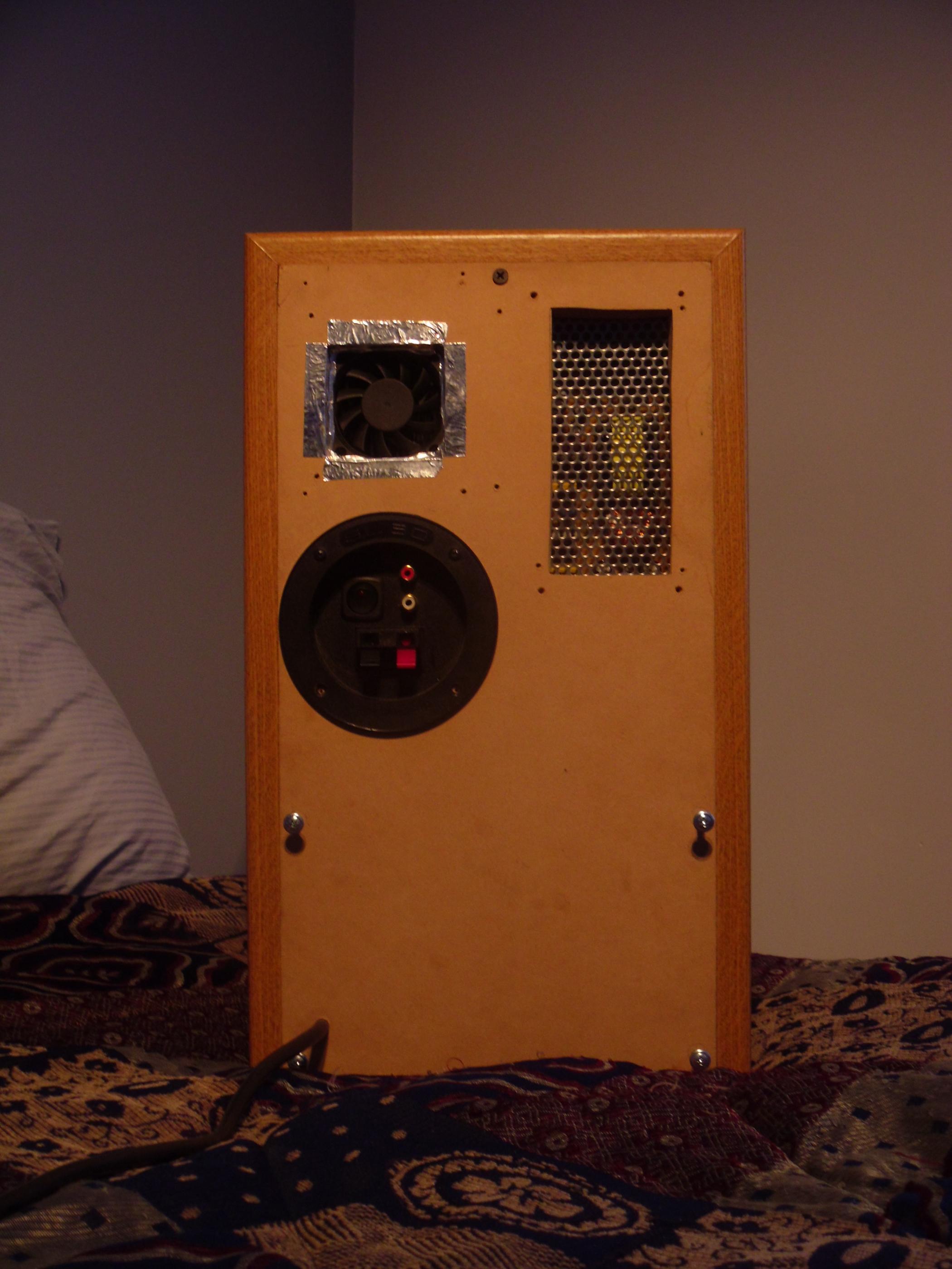

Thanks for the input. I think I have the heat issue under control. I'm building it so the fan on the amp draws air from the outside of the speaker, pushes it past the psu and out of the speaker. Do you think a failed component could light the wood on fire? Neither the amp or psi will come in contact with stuffing, but the way I have it now both are in a plywood enclosure. ( I know mdf would be better, but seeing as the speakers are made of particle board, I figured it wouldn't make too much of a difference.)

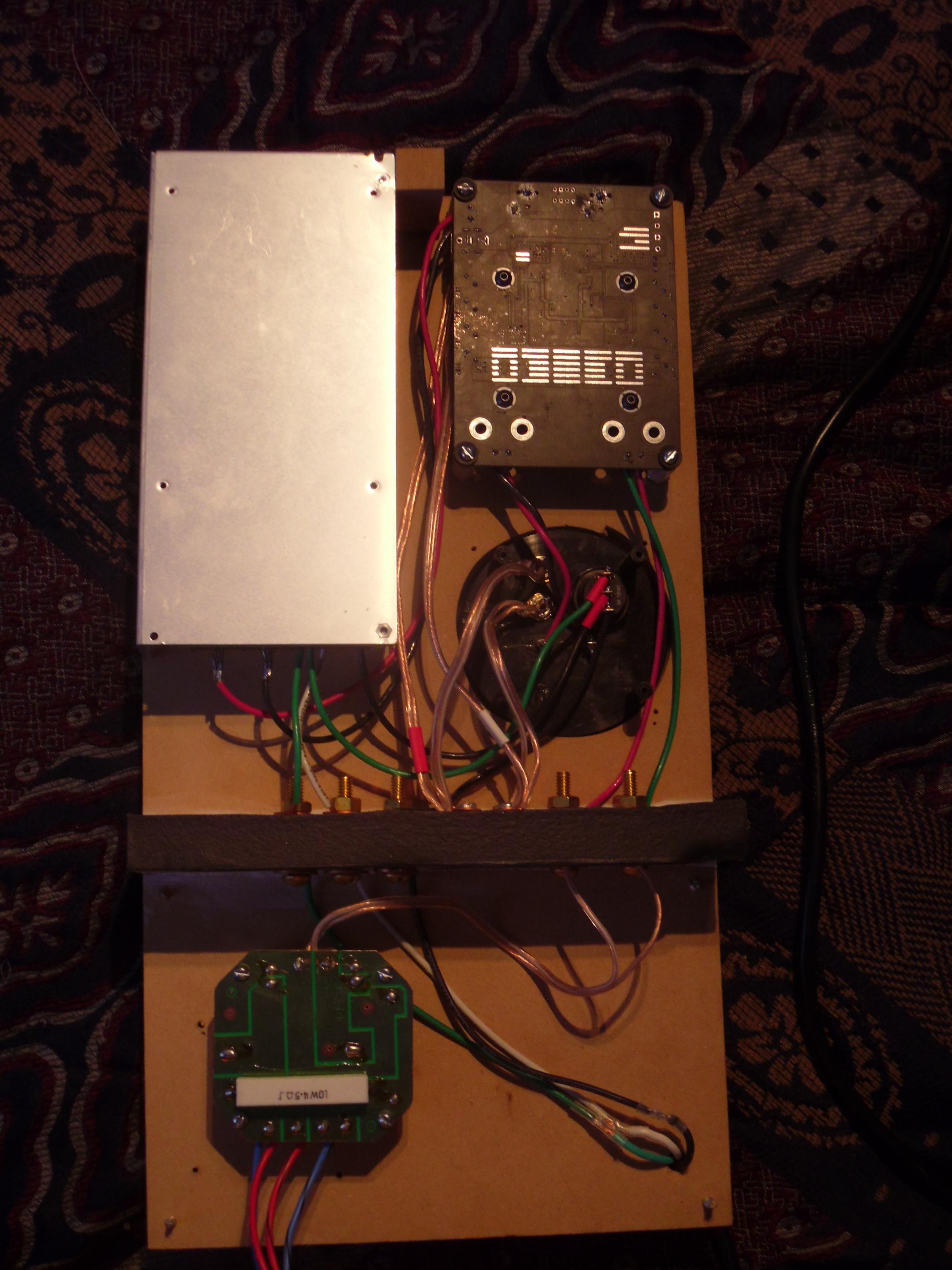

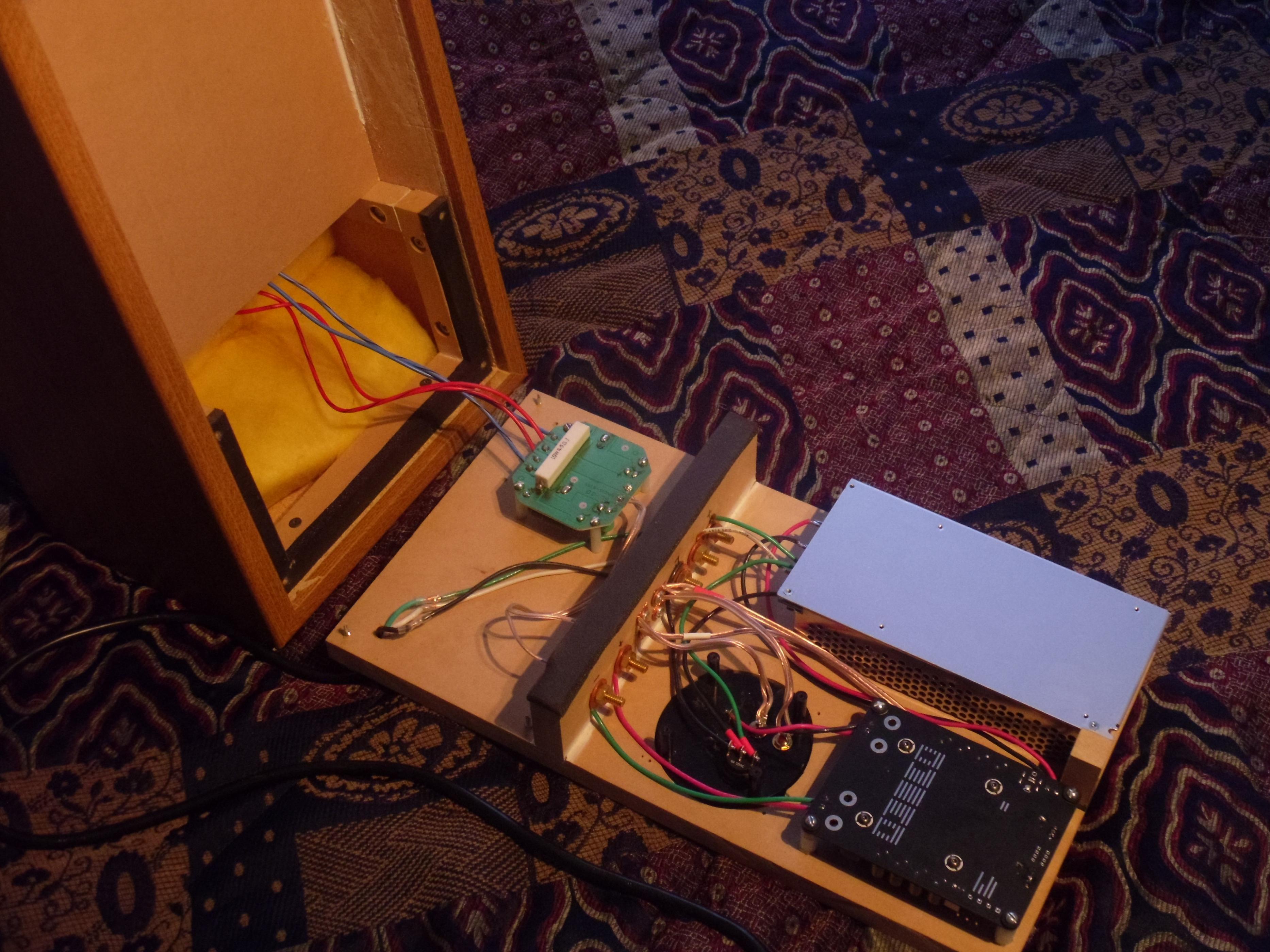

I built a mostly sealed enclosure into the rear panel for the amp and psu. I'm waiting for a power cord for my camera to arrive, so pictures will have to wait.
Anyways it was working great for about 6 hours. I just turned it on and noticed some feedback. I grabbed the rca input line and heard a pop through the left speaker (the one that now holds the amp) The right speaker still works fine but the left one is very very quiet. I have the phono jacks for the input directly above the right speaker output. I'm guessing this caused the problem? Should I post a new thread in a different section for troubleshooting questions?
Update: I ran it without the right speaker plugged in and it worked fine. I think I need to do more testing before I post technical questions.
Oops, sorry mods I meant to edit that last one not quote it. The system is working again. I'm not 100% sure what the problem was but I've made sure the input and left speaker output don't come in contact.
Would you guys take a look at these pictures and tell me if you see any safety concerns or room for improvement? I monitored the temperature of the hottest area of the power supply for a few hours in 105 degrees F. ambient temp. and it never got over 130 degrees F. The probe was set about a millimeter away from the coil just visible in the first picture. I don't have an infared thermometer and I'm not sure I would be able to get an accurate reading through that metal grill so I didn't get an actual surface temp. Anyways it seems to run quite cool. The metal grill and the heat sink on the amp never get too hot to touch.
