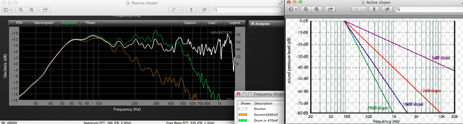

The reality is the acoustic crossover slope using passive components seldom reflects that "order".
In the charts below are examples, a single capacitor (supposedly first order) is placed in series with a woofer, one value results in a 6 dB per octave slope, another value capacitor (supposedly first order) results in a 24 dB per octave slope. That is a measured, not simulated response.
The slope angle is completely different, as well as the smaller value capacitor causes a 3 dB rise in response before the rapid rolloff.
Using active crossovers, the acoustic crossover slope of a transducer which has flat response in the crossover passband will reflect the "order" of the crossover, it will "look like the line".
Using passive components, the same often is not true, hence my request to see what Mondogenerator's speaker looks like using passive vs. active to make the comparison.
because the drivers do not have flat response correct? and also because with passive crossovers, the impedance of the drivers also affect the slope.
The fact that active crossovers do not depend on the impedance and give a more accurate response is an advantage.
What the OP is trying to do by matching the passive crossover response is pointless. Use the flexibility of the active crossover to tune the speaker to your liking. You can also EQ the response.
