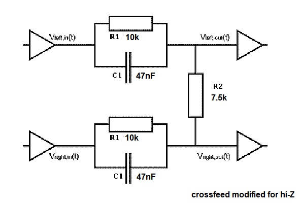

It seems adding the series capacitors (shunting the 10k series resistors) reduces the effect of the 'cross-feeding', by quite a lot.
Perhaps I should try Meier's circuit as he described it, with the low values of R and C. They wouldn't be affected as much by the loading from the 50k volume control on the headphone amp.
With my current Rseries = 10k setup, using .15uF for the Cseries, I had to reduce Rshunt to 5.8k ohms to get the blending I wanted. That's in parallel with 100k, so that's an actual 100k*5.8k/105.8k = 5.2k ohms for Rshunt.
22k/5.8k = 3.793, so scaling Cseries up from 47nF for 22k, 47nF*3.79 = 180nF, or maybe that's close enough with 0.15uF? I can also try 0.22uF to see if that sounds better subjectively.
I guess the way to do this is to rig up a switch, with the Natural Crossfeed circuit set how I like it, to be switched in to tame these early '60s pingpong-stereo recordings, and forget about adjustability.

First off, if I use the scaled-up values derived from the original Meier circuit, the stereo image is still very wide. Too wide for these 'pingpong stereo' recordings, at least for my liking. That's why I'm trying to find a different combination of Rseries and Rshunt, and Cseries to match.
With the circuit set up as in the diagram attached to the previous message (Rseries = 10k, Rshunt = 5.6k), I was able to switch Cseries between 47nF, 100nF, 147nF.
I found that increasing the value of Cseries widens the stereo image in the high frequencies, which makes the presentation sound 'brighter' and 'wider'.
This begs the question, is there a 'correct' value of Cseries to be found? Or is this a matter of taste? Is there anything 'wrong' with reducing the value of Cseries to 100nF if I like it better that way? Or maybe I can wire in 100nF and make adding 82pF in parallel switchable. Clip-leading caps in and out does not result in objectionable noises, so a decent switch shouldn't either.

You could first try the circuit with no capacitors, 10k series Rs, and adjust the shunt R to taste.
Then experiment with the C values, keeping both equal.
Thanks rayma, that's actually what I've been doing. Using clip leads. Totally unscientific. What I've found so far:
1) The reduced width effect is most pronounced without the series caps. The problem is that it also makes the sound rather dull (perceived lack of high frequencies) and there's some weirdness with bass frequencies having more stereo separation than treble frequencies, which is unnatural. But this is quite adjustable with a pot for Rshunt. It works well enough.
2) Adding the value of cap as suggested by Meier results in the stereo width being retained a lot more.
With Rseries = 10k and Rshunt = 7.5k and no capacitors, I found the stereo width to my liking for these pingpong recordings. Adding the scaled-up 0.15uF caps left the bass frequencies at the same narrower width, but the treble frequencies spread out almost all the way back to full-width stereo.
With the 0.15uF caps in place, reducing Rshunt to 5.6k brought the stereo width back to where I wanted it. But now the presentation is rather bright sounding. Reducing the cap value to 0.1uF reduces the width, but deadens the tonal quality. However, I can see this setup with 0.1uF in place might be just what's needed for an overly bright *and* overly wide pingpong stereo recording. Perhaps it would be best to be able to switch between Cseries = 0.1uF or 0.147uF, by switching a 0.047uF cap in/out of parallel with the 0.1uF cap.
