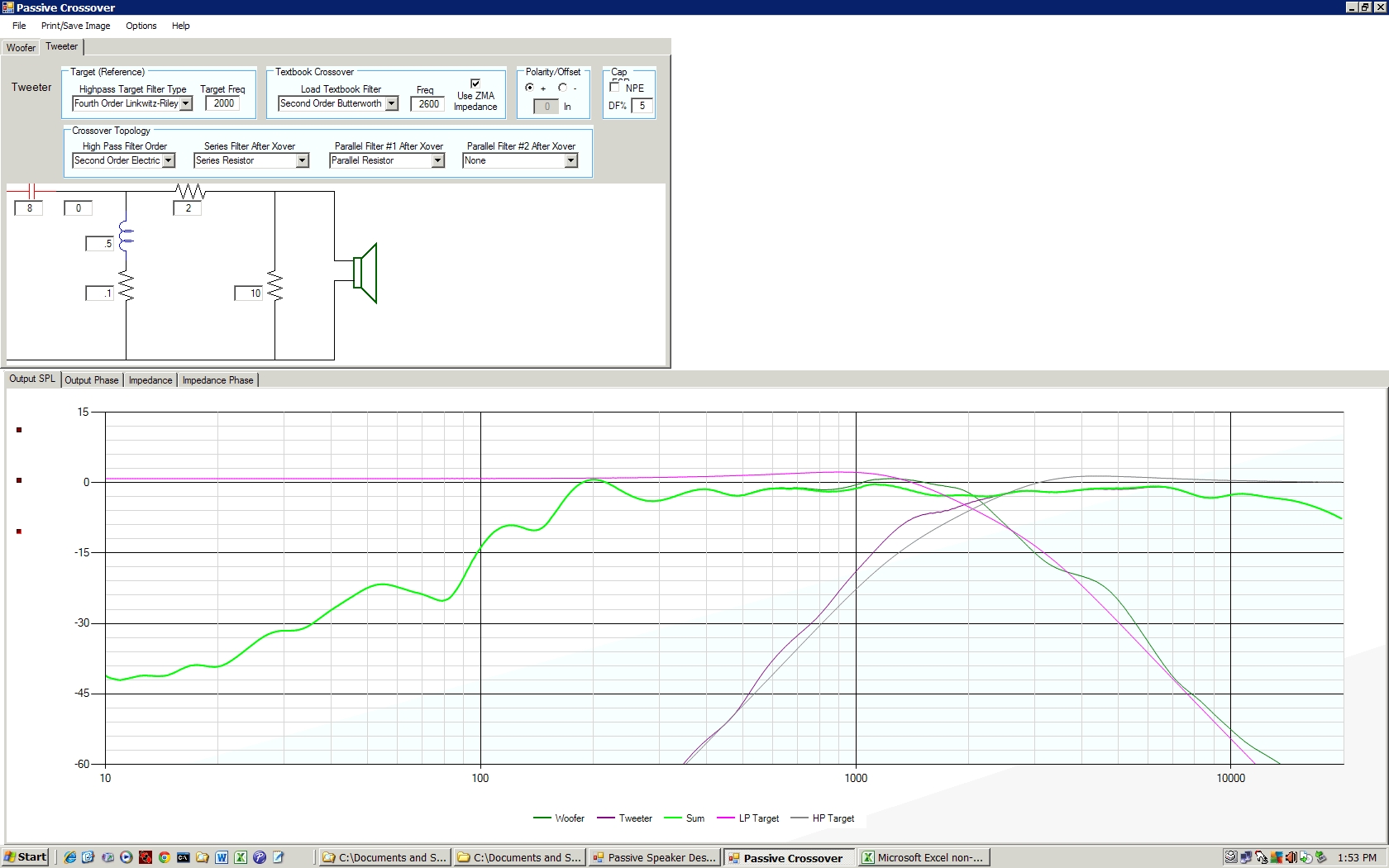

Whipped up another version of the same thing. I am using WooferTester for my impedance as I have not been kind enough to sent HOLM a donation. ( don't have an European money account)
This one used HOLM to do 1/3 octave smoothing and some light filtering. As this was done in my office with a too small box, ignore the lower end. It is actually good to 100. I may or may not build this one, as it is the Vifa D27, and my experience s it's distortion is a bit high that far down.
What do people think of the curve fitting?

How big are the files? The first version I posted only allowed 8K samples, and I increased that to 65K. But if there are more samples (rows) in the file than 65K, the data won't get imported properly. I know one of the measurement programs created some huge files if the resolution wasn't set right, but I can't remember which one it was.
I thought 65K was adequate because internally I'm just using 500 samples.
I'd like to look at the file to figure out why it messed up the phase. I tried to make the file import routine very robust. It rejects header data, rejects spurious junk at the end of the line, accepts just about any delimiter, etc. I've tested it against a lot of FRD files that others have posted and I know it will read files that some people couldn't read with PCD. So I'm curious as to why it didn't like that file and I'd like to get the problem fixed.
I'm not at home right now but when I get back late Monday I'll send you my email address so I can look at it.
Sounds like a plan. I am sure it is the FSD files from HOLM. I am using WT-II for the Z and they are small. It is way too tempting to use higher resolution than the task needs. Some guidelines are what I'll put in my quick starts.
The HOLM soothing works fine, so maybe that is something you don't need to worry about. Impedance is smooth anyway.
