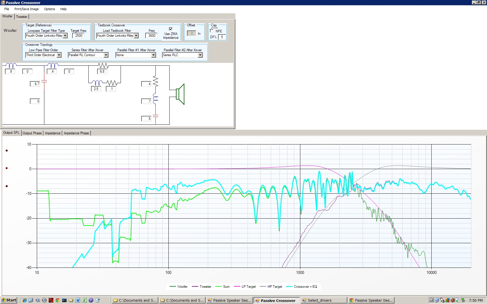

You need to have a smoothing toggle in the crossover pane. With real 1 meter measurements, it is really hard to see where the reference levels are. One third or even one octave smoothing helps with the general shape of things, but then going back to one twelfth or so is necessary to get any filters right. This needs to be in the crossover display pane, not the response editor. I think it would be more useful than if they were cleaned up before importing. I guess another way to do this would be to generate both raw and smoothed data sets. Import the smoothed ones first to get an idea of where you are going, then start over with the raw ones. Sometimes a procedure works as well as a feature.
Second is the inability to adjust the target response which is at 0 dB, to the imported responses. I would like to be able to pick the average over some interval, likely the 500 to 1K range of the woofer, and adjust the target to that as zero. It would take quite a bit of spreadsheet work to do that before importing. (or a perl script.)
I did the first guess at the BSC and notch filters in my spreadsheet, but a bit of a guessing game. A handy button would switch from the target to the applied perfect response so when fiddling with values, you have a reference to where you are going. That would help when you try and simplify to combine the BSC with the crossover. Again, having a smoothing function for display would help in tuning here too.
Don't know how it picks the frequency range to start at 10. Wastes a lot of space that could be better used for crossover range resolution. 20 would seem to be a better default. Selectable best of all.

Right--at the very end I was going to have an option to "hide" the target/configuration groups so that the crossover window would fit better on a laptop or small screen. The window is 830 pixels tall, which is too big for a common 1280x800 laptop display. But at the last minute I let it go and didn't bother cleaning up my attempts to compress the height. I'll address that in the next Beta.
You need to have a smoothing toggle in the crossover pane. With real 1 meter measurements, it is really hard to see where the reference levels are...
Agreed. I'll try to get this in the next Beta
I used a simple level-matching algorithm in the Box Model module to find the splice point--I could apply that here. You want the levels to match near the crossover point, so I could identify a range of values in the response to auto-calculate the target level.
I was going to add some text on the display (using the graphics routines) that identified the filter frequencies so it would be easier to know what you were changing. In the "parent" program (PSD) I write the part number near the components on the schematic...so I know how to annotate the charts. I just need to calculate the filter frequencies and find a good place to add the text.
Also, the larger program (PSD, not PSD_Lite) has a really nice BSC calculator that is comparable to the Edge program. I'll probably add the Baffle module to PSD_Lite on the next iteration and the response will show up as another line on the chart.
There is a pull-down option on the main window that will allow setting processing options, including the range/resolution. However, I'm not going to implement that until I have time to do a lot of testing to make sure it works properly. It *should* be easy to do, although I can think of at least one place where some code changes would be needed (the splicing routine in the Box Model module).

One advanced feature another high priced product does in the BSC is to allow adding edge radius. For all I know, it may just reduce ripple amplitude by some about per quarter inch or so. I will be interested to see your advanced version.
If anyone is interested, the crossover that came out of about an hour playing with the curve fitting was a target of an LR4 at 2500 Hx. The actual results were a third order at 3200 and second order at 3500. Because I had them lying around, the drivers were the Zaph and a Vifa D27. Results are not far from what my experience. Off to order a couple of coils. suggests.

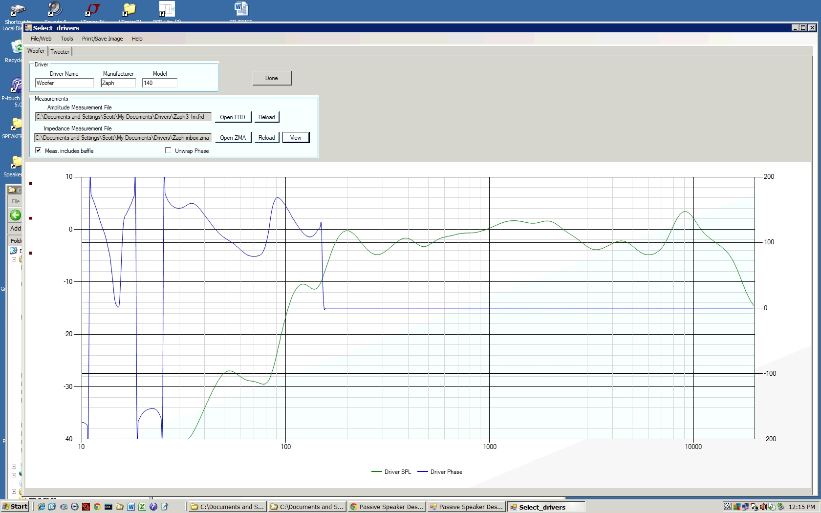

Imported data causing exception:
Axis Object auto interval error due to invalid point values or axis min/max
The chart for the crossover amplitude is a box with a red X.
I opened the files and pruned them to 20 -20K range. No help. If I open it up new with no driver files, it is fine. So, something funny importing my files. ( besides the off phase translation. )
Deleting everything and try again.
