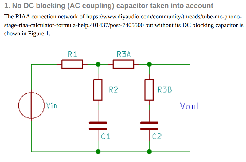

In your case # 1:
I'm wondering why you split R3 into R3A & R3B? What benefit does splitting R3 deliver?
I have only ever seen a passive XO network which had:
* R3 where you have R3B
* and no R3A!
* and no R3A!
The thread started with a commercial design having both R2 and R3B. It's easy to show, though, that either R2 or R3B has to be made zero, otherwise you get an extra (finite) zero in the transfer.
Having both R2 and R3A has the advantage that you can choose standard values for the capacitors, only the resistors then get awkward values. This is a practical advantage because resistors are often available in E96 values and capacitors only in E6, E12 or at best E24.

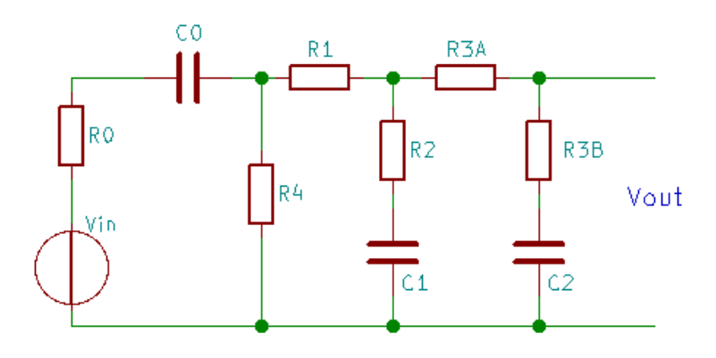

... sure, a coupling cap is needed to remove any DC offset produced by the preceding gain stage - but I would've thought the logical place to put this would be after the RIAA network, ie. just before the next gain stage? If you do that ... it doesn't change the RIAA component values.
This is incorrect. As soon as you put a grid leak resistor after that coupling capacitor after the RIAA network, it disturbs the RIAA correction in a similar way to the AC coupling before RIAA correction. The calculation only gets more complicated and my approximation less accurate. See the attachment of my second link for details: https://www.diyaudio.com/community/attachments/rareriaa4-pdf.1255781/
Edit: I made a mistake; I just reread my own document and found that in chapter 4, only the resistor of the AC coupling is at the end, not the coupling capacitor. Nonetheless, I can't think of any reason why an AC coupling completely after the RIAA correction would not disturb the correction network.
AIUI the 'original' passive RIAA network was simply R1 & R2, and C1 & C2, from your Case #1 (no DC blocking cap). As used in the 'Le Pacific' circuit.
Then the late, great Allen Wright introduced R3B in the early 80s, to compensate for what he'd found cutting engineers were doing - which was ... rolling off the HFs, to stop them burning out their cutting amplifiers. He used this extra res in his JLTi phono stage circuit.

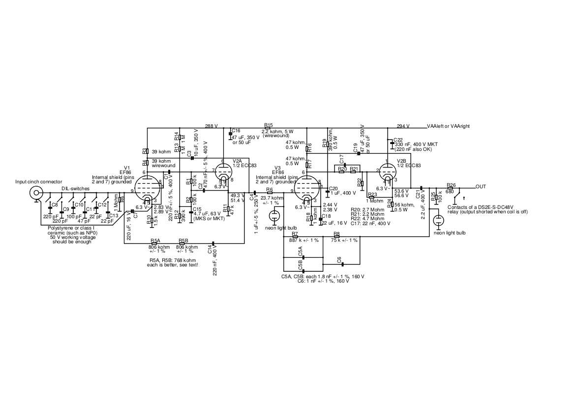

A topology with a flat gain stage with shunt feedback to get a low-noise input termination and then a stage with active correction. Disadvantages: the number of valves is relatively large and the minimum input capacitance is close to 90 pF due to Miller effect in the first stage.

It's not passive correction but a combination, I see.
If the first valve were an ideal voltage-controlled current source and the second were a nullor, the zero and the second pole of the October 2008 circuit would be about right:
Time constant of the zero: R6C3 = 320 us, where 318 us is required. The time constant will be slightly smaller when you correct for the finite transconductance of the second valve.
Time constant of the second pole: parallel value of R5 and R3 + R4 with C1, which results in approximately 76.95875486 us where 75 us is required. The actual time constant will be smaller when you account for the internal resistance of the first valve (and the series feedback through the internal resistance of the LED).
Under the same assumptions, the first pole would be way off: infinite time constant instead of 3.18 ms. I guess the finite gain of the second stage, which I neglected, sets the first pole.
This is just a very coarse sanity check, it only shows that the values of the October 2008 circuit are in the right ballpark. How does it work out for your variant?
Aah, OK ... very fancy! (y)
Me - I stick to ss gear; my 'Muse' phono stage is jfet-based and comes in either MM or MC form, with several levels of gain. (The MM one uses a cascode on the 1st stage - to take out any Miller capacitance acting on the cart - but this imposes some limitations ... so I don't use this concept on the MC version.)

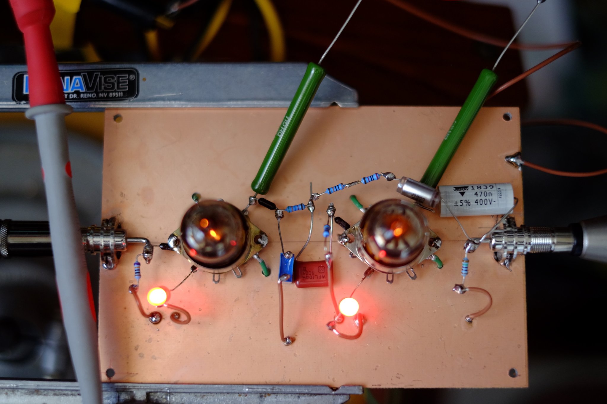

The Borbely circuit is somewhat similar to what was discussed here: https://www.diyaudio.com/community/...feedback-loop-active-riaa.408061/post-7585296
Joined 2008

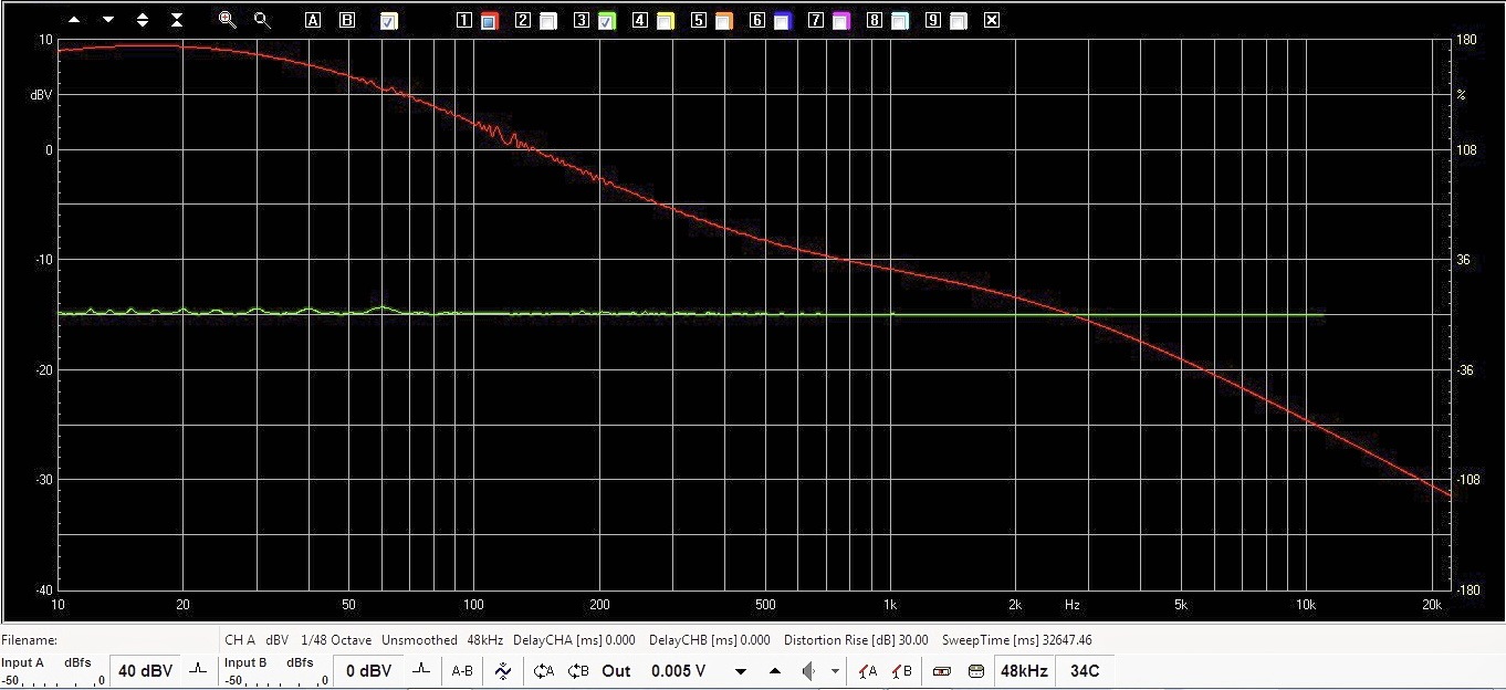

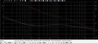

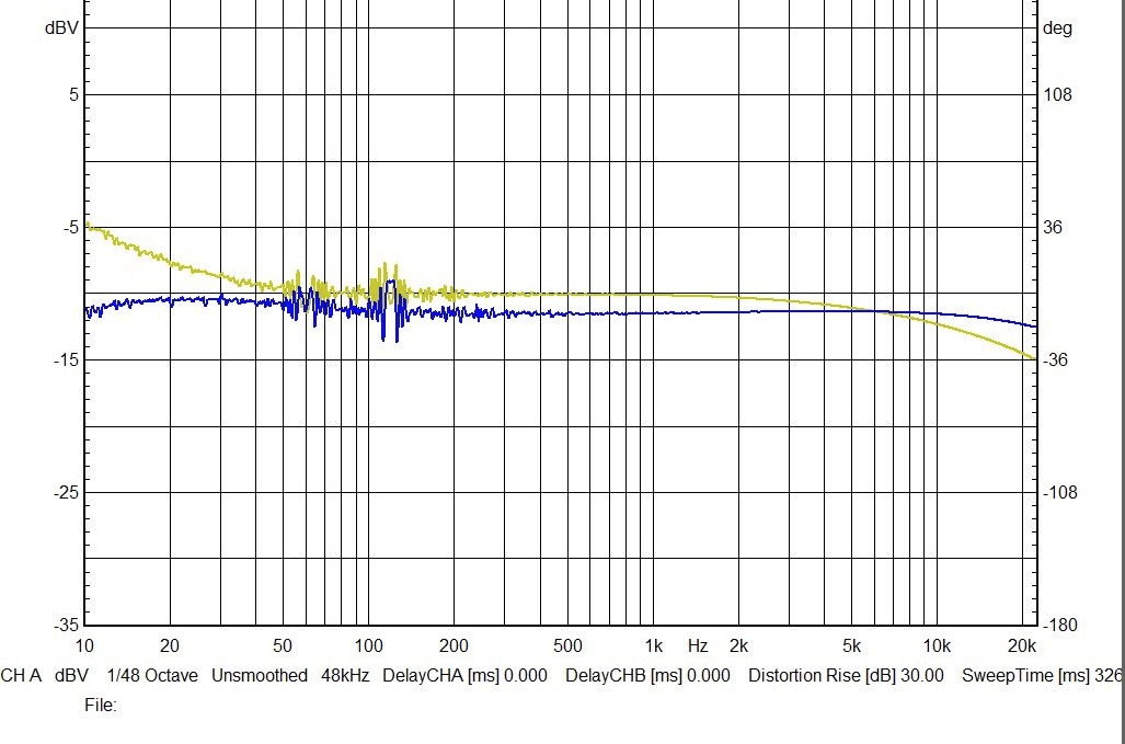

This is what I have so far. Tested with Hagerman inverse RIAA board and without. Built with schematic spec'd parts instead of my hoped for changes just to check the circuit first. C3 is a very old polystyrene - the only one with nominal 1nF value I have around. My meter resolution ends at 1nF so not sure how close it actulally is.
I don't know yet what the cause of the rough trace 50 - 500Hz is.
The second valve starts to cut-off with more than around 6-7mV input.
Won't the output capacitor being in series with C3 pull that down a touch too?
Forgive me but I don't now what assumptions you mean.

I meant my simplifying assumptions that the first valve is a voltage-controlled current source and the second is a nullor, which is about the same as an ideal op-amp. Both are very coarse approximations, as I just wanted to check whether anything is off by a factor of ten.
The assumption about the second valve turns out to be too coarse to even approximately calculate the first pole. That's because the second stage works open-loop at very low audio frequencies. The first pole is therefore not determined by its feedback network, but by the feedback network and the finite open-loop gain of the second stage. This also means that the first pole will be sensitive to variations of the characteristics of the second valve.
It wouldn't if the second valve were a nullor (ideal op-amp). In real life, it will do something on the zero location. I would guess its effect on the zero is quite limited, because its impedance at 2122 Hz is quite small compared to the impedances of the other components, even R8.
