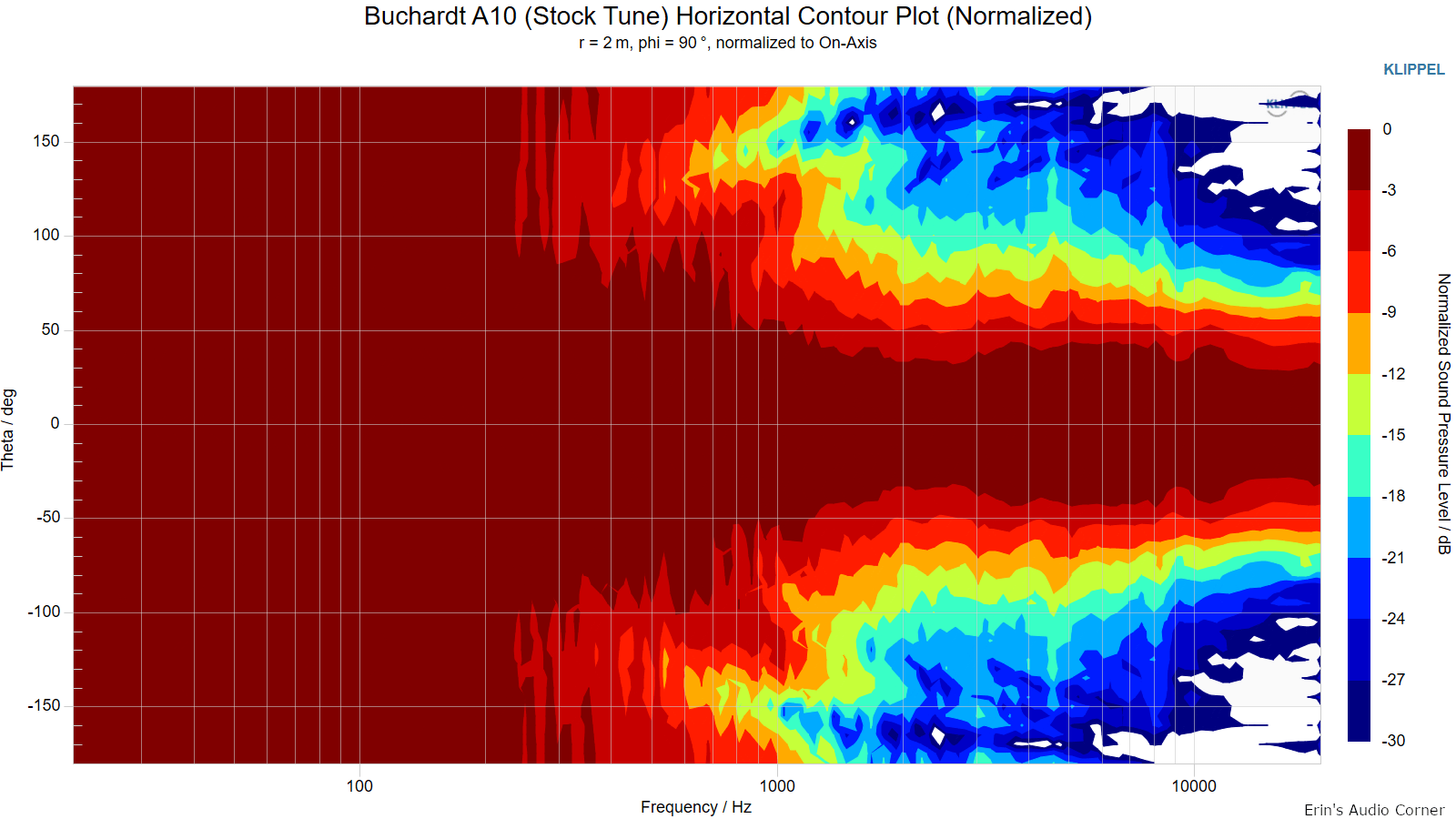

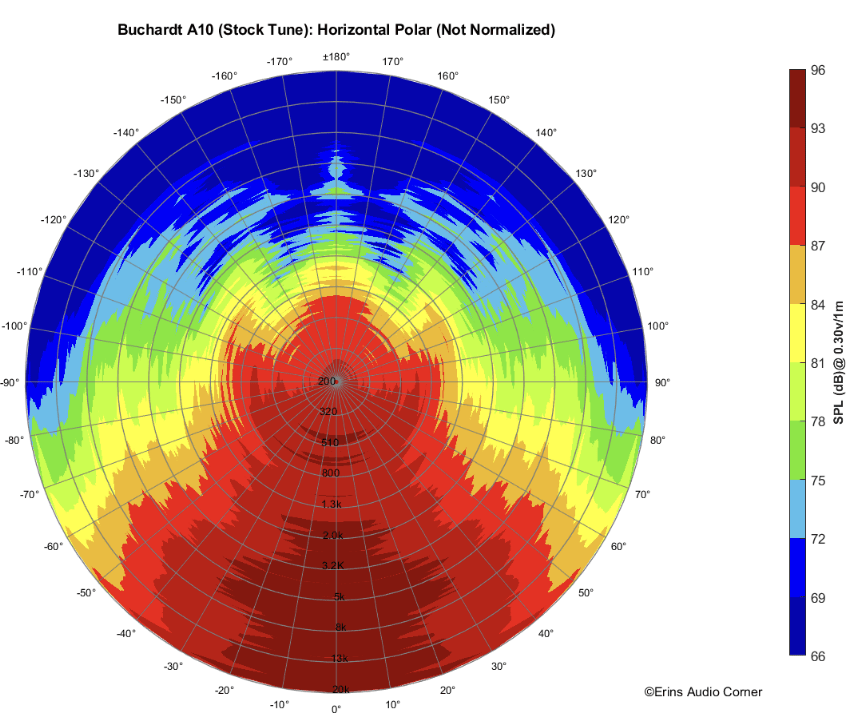

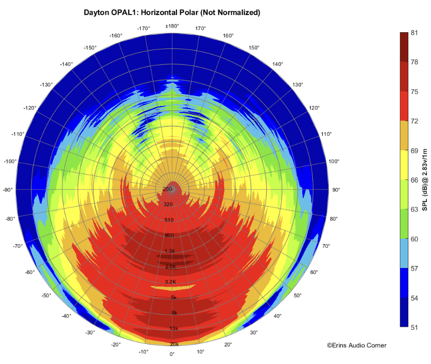

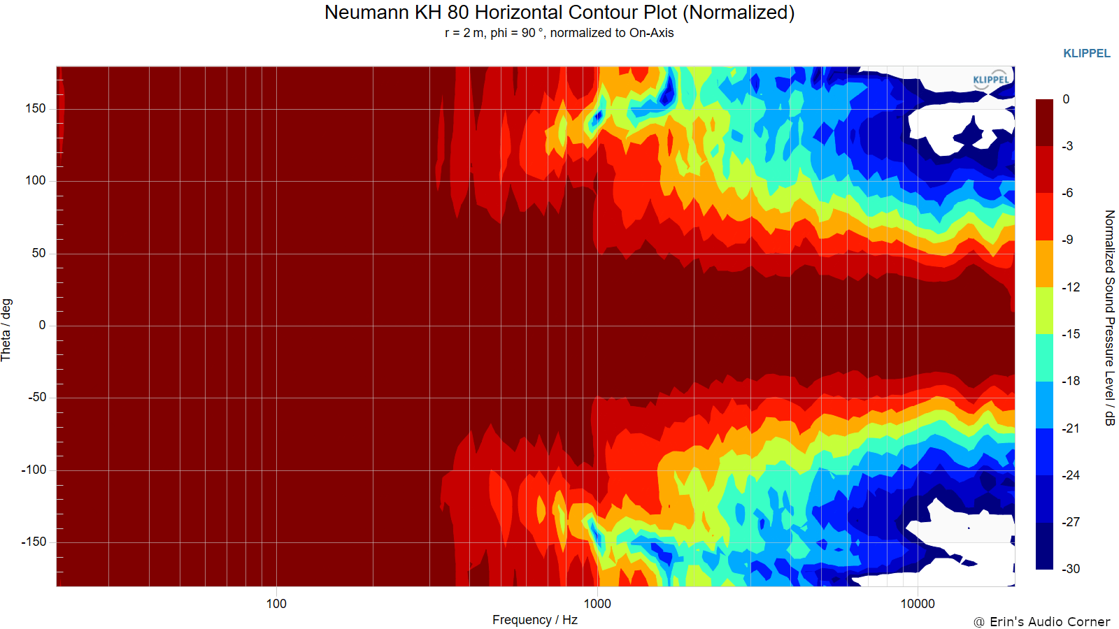

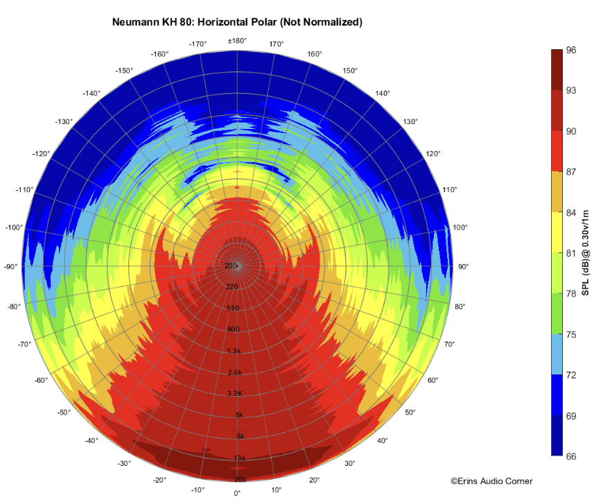

#hifijim thread inspired me to copypaste Erin's Klippel NFS measurements of different kind of bookshelves - nothing dramatic
Closed box
Front ports
Double radiators on backside
(missing)
Closed box
Front ports
