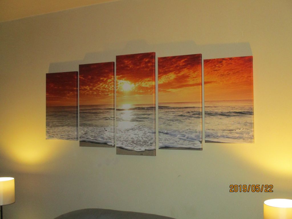

I've actually been using Canvas Art (click the link) which is a form of limp membrane absorber, in several of my later installations, with pretty good results.
What this is, is a fabric canvas over a wooden frame. It places the canvas about 1 or 2 inches from the wall.
It generally works well in limiting echos and reflections. Plus it looks a lot better than the stupid foam egg crates.
The one in the thumbnail hangs in my living room listening area...

I've seen them Douglas and thought it is a great idea and they look great. Wesayso had used same kind of thing too cover his midband absorber ( he has a reproduction of led zeppelin's 'house of the holy' printed over fabric, i'm jaleous i not had the idea first!**).
Do you use some kind of absorbing material behind it Douglas? You can space them from wall to increase frequency lower in frequency too ( down to 200/300hz varying with space gap. Pretty effective.)
I've tried that experimentally and to be honest it turned out to be more trouble than it's worth. I'm guessin, of course, but it seems like 90% of the improvement comes from just the standard, out of the box, artwork itself. Adding foam or pollyfill might make a difference but nothing I could actually measure...
This is accords with what I've discovered. Sometimes we just let them hang in free space. It is a bit odd to see a painting haning 1 inch out from a wall so most people will want a secondary frame installed behind the main one.

The canvas art is not a porous fabric surface. Best I can tell without destroying it is that, mostly, it's a lightweight canvas fabric that is either silk screened or printed over with an acrylic ink. The surface is sealed, which is probably why backing materials have little effect.
I've put a few of these in first reflection spots and when the owner is getting all carried away showing off his system and trying to ruin my hearing, you can actually feel them moving. The movement appears to absorb energy reducing the reflections, which is why I thought they might be germaine to this thread.

These art panels appear to have the most effect in the voice range, which quite nicely corresponds to where our ears are most sensitive to detail. I'm not saying they're the be-all and end-all, but they do have a beneficial side to them that people who've used them (at my suggestion) do seem to like.
I think it's fair to say that you approach this more scientifically than I do and probably in a different arena... I'm doing consumer stuff so I do try to keep things nice for the client. There are things I've seen done in studios that would send my guys off screaming into the night ... 😀
