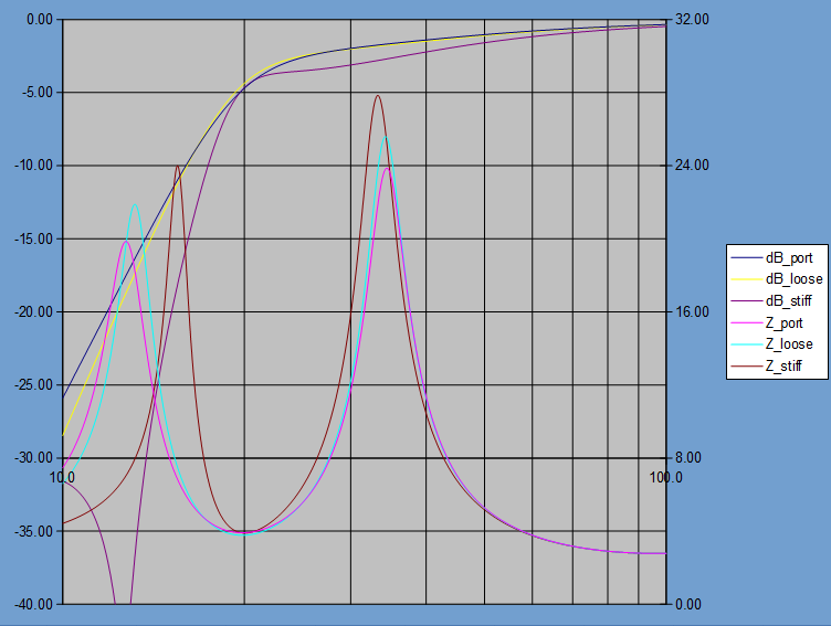

Using Jeff Bagby's spreadsheet I end up w/ a total of 26.6 gms of added mass (13.3gm per PR) using 2ea. Peerless 830880 PR, and 1ea. Wavecor WF152BD05. It will take a little low end boost and a HP filter. Anyway, I cannot attach the spreadsheet file because of forum limits, but a screen shot was accepted.
I wonder if the PR's rated Xmax is the same as PR's Xmech, you may have a little more than 6mm to play with.
I would not discount the possibility of building a PR, once you know the app. weight you can get pretty close w/ 1/3 your surround and spider(s) weights, a connecting tube and a flat diaphragm (you don't need a cone type for a PR.), and it is easy to make provisions for additional weight (e.g.: washers).
