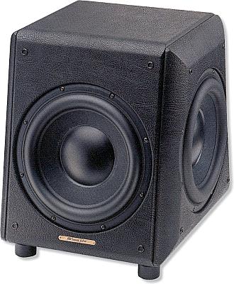

I should mention that previously I did have a Sonus Faber Gravis PR sub which didn't seem to work all that well with main speakers, but I don't want to throw the baby out with the bathwater. Just because it didn't work before doesn't mean it cant work.
Perhaps with external active crossover, using 18" drivers and larger volume it might seem less boomy.

An 18" bass + 2x18" PR's to be used above a subwoofer is seriously
OTT stuff, probably pointless and not thought through seems to me.
Just converting the the OB to a sealed box (about half the volume
of the PR box) would give you oodles more bass and low bass SPL.
I cannot see any scenario for PR's above a lower bass subwoofer,
transient response and integration will be poor. Parallel with the
PR's tuned deep and tight is a different matter. That could work
well with music with the sub off and then add the sub for AV.
rgds, sreten.
