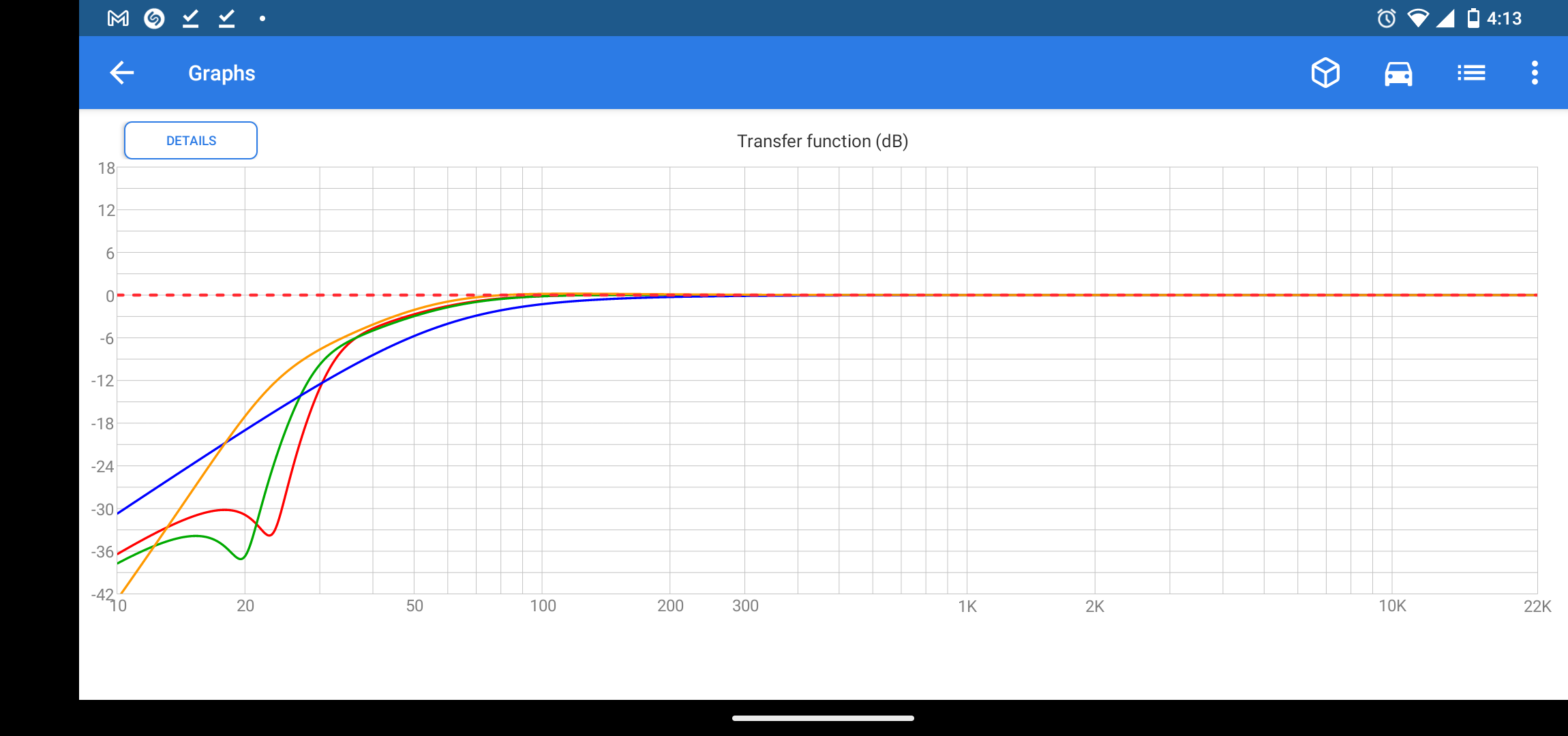

I used speaker box lite app for Android to model.
Attached are graphs of closed box, vented, and passive radiator(2 different radiator brands)
Each speaker will consist of 70L box with 4 17w75xl drivers and two 6.5" passive radiators or two ports
Yellow brownish graph is vented design
Blue is closed box
Green is two passive radiators( fs =20hz, qms=6.8, vas =55L)

Red is passive radiators made by Dayton
Dayton Audio DS215-PR 8" Designer Series Passive Radiator
I am leaning to do ported design and replace them with passive radiators if there is a port noise issue. I am planning to use flared round vents around 1.25" diameter. 3cm

The first approximation for port design is to turn up the input power in the sim until the drivers reach Xmax (or your max amp power, whichever comes first) then increase the port diameter until the simulated airspeed is no higher than 17m/s.
Flares on the ends of the ports will give lower noise than for straight ports, but I don't know of any definitive conversion from acceptable airspeed in the straight condition to a higher but still acceptable speed with flares. My gut feeling is that you could use about 70% of the cross sectional area and still be ok, based on a few projects I've seen with flares, but I don't have hard data to back that up.
In any case, with or without flares, 2 x 3cm dia ports would be too small IMO - you'd probably want about 2 x 9cm dia to meet the airspeed target for straight vents per WinISD.
That assumes using the box full range, ie without a sub - obviously if you crossover into the sub above the port tuning frequency the ports will be operating at lower SPL and thus lower airspeed. Somewhat smaller ports might therefore be acceptable if you were always going to use the box with your sub.
