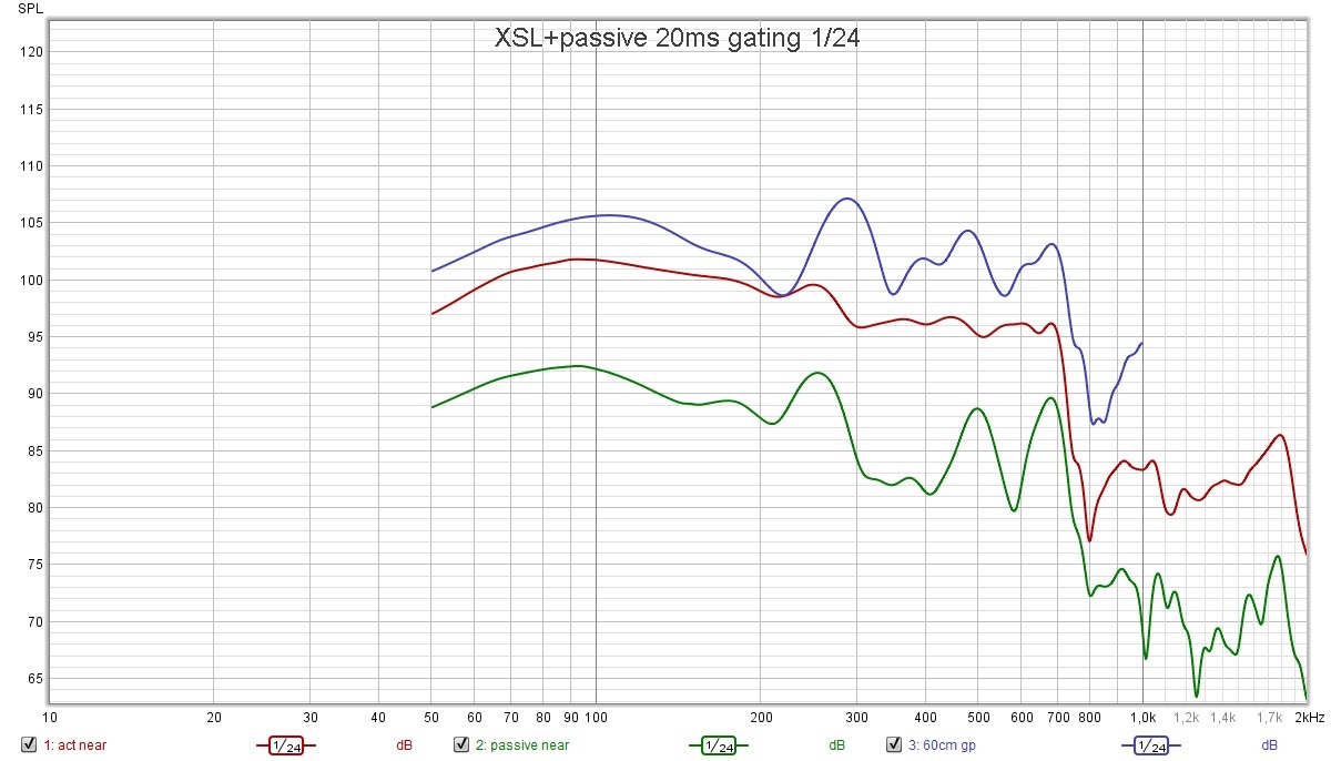

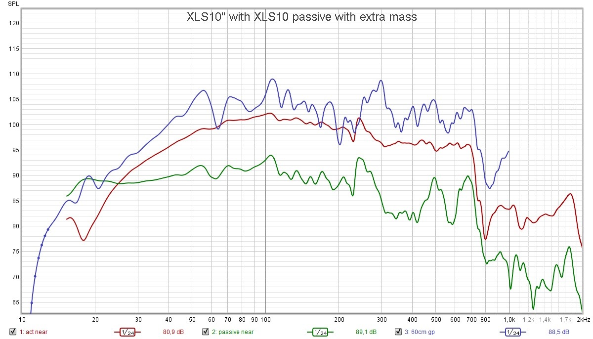

Here my measurements of my poor 10"+passive 10" sub (from my museum). Drivers are side by side as per instructions... Spl of gp measurement is not with same amp gain. 500ms and 20ms gating.
Nearfield of each unit and groundplane at 60cm, all indoor. We can see summation below 25Hz and at 50-60Hz, then a deep notch at 65Hz, low notch at 85Hz, peak at 105Hz etc.

Seems like a lot of radiation from the PR. I've not seen anything that bad before.
Me neither. Actually I can't find published nearfield measurements of subwoofers with PR. Only simulations....
Galu, this thread is not only about resonance maximum, but wide band noise from port or PR. And it happens! Phasematch is another more difficult topic here. Noise is not a big problem for subwoofers or 3-ways, but an awful disaster for 2-ways...

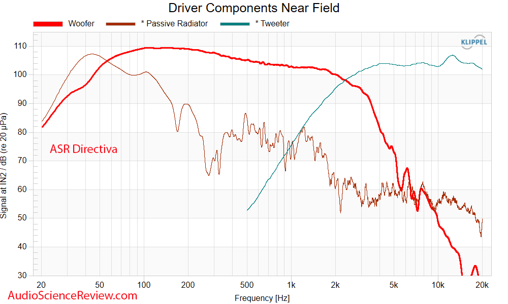

Here are measurements with Klippel NFS and nearfield, of a speaker project with PR.
https://www.audiosciencereview.com/...sponse-open-source-purifi-speaker-png.157078/

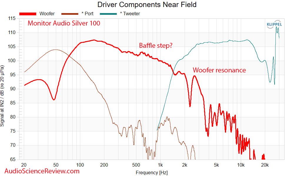

And a good case of BR port on the backside, woofer 8"
https://www.audiosciencereview.com/...onitor-audio-silver-100-review-speaker.29190/
