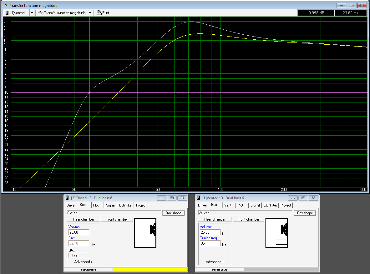

I think I can work more on the alignment, at least my current one suffers from port chuffing.
And this 12" cone is so stiff I can't make anything useful out of it, except for a comfortable seat:D. I have to go buy another PR and see what I can do.

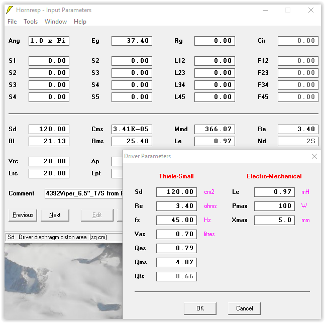

The calculator looks fine (apply ICG's caveats from Post #23). I still have a hard time believing, that your driver has a Mmd=366.07gm, that's way heavy for a 6.5" woofer. I'm not saying this is impossible, but just unlikely. If your measured T/S parameters are correct I'd suggest to use it only in a small sealed box.

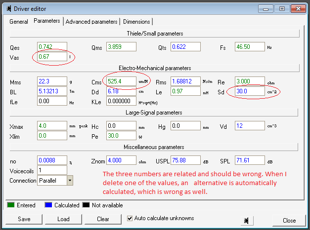

I didn't say The Mmd is 366 gr. ! It's actually 22.3 gr. How have you calculated that number???
I think there's something wrong with my Sd, Cmd and Vas as they are closely related. Even WinISD doesn't accept the numbers together. The wired part is that this faulty Cms ( and then Vas ) is calculated by the working calculator and the correct ( as far as I know ) input data.
I think I have to calculate the Vas and Cms myself.

Hi 4392Viper,
The Mmd I quoted is what Hornresp calcuates from the other T/S parameters (see attached). Somehow the Vas/Cms is just not correct.
P.S.: Just noticed, the Dd entry in your WinISD screen is incorrect.

No, no. Sd and Dd are both auto - generated from the faulty Vas,Cms.
Well, that's exactly the wrong way around - you can measure the Sd perfectly but not the Cms or Vas, esp. the Vas is directly dependent on the Sd! You HAVE to calculate it the other way around! Leave the other fields empty but the Sd is one of the most important values you have to enter correctly!

Post #33: "...Sd is one of the most important values you have to enter correctly!"
As an aside, before Hornresp had a "Drivers Parameters" entry window, I always used the sequence of entering Sd first, then double-clicking on Cms, which would open a window asking: "Are you sure the value of Sd is correct?", after clicking "Yes" the "Calculate Cms" window would ask for the Vas. So, yes Sd has to be correct, and so does Vas...

Vas = 1.18 * 340 * Sd² * Cms
While the first 2 factors (air density and speed of sound) are almost constants (at least for practical use), you could slove for Sd, for Cms or for Vas. Since Sd is the first and easiest to know (by mechanical/geometrical measurement), you are praktically always forced to have that value to calculate the others. The other way around you could easily verify the other parameters by solving for Sd since Sd is the only parameter which can not drift at all, at least for cone chassis, dome drivers etc. (some very rare others can though).

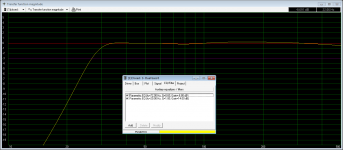

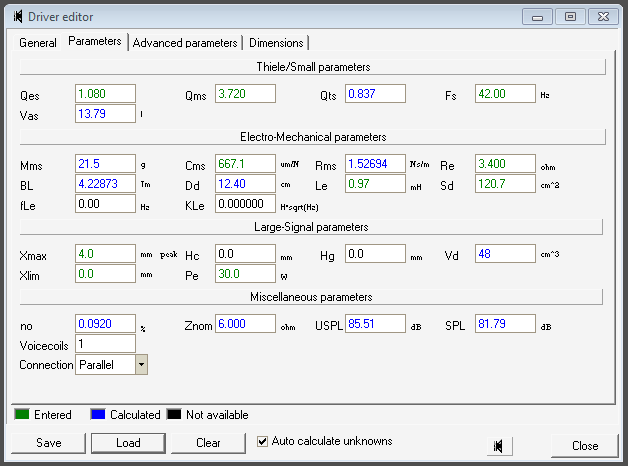

:mad::mad::mad:
The woofers are healthy drivers, have nice appearance and good performance. They are capable of eating huge amounts of juice and not even getting warm.
and After testing the T/S parameters by hand, it turns out they're pieces of trash to my job... with a Qts of 0.84 and a Vas of 13.8 lit. it seems there's no practical use for them except for a powerful car audio mid-bass driver firing in the trunk. The best tiny box I've done for it, though, is a 25 lit. ported box with a tuning of 35 Hz. Pictures attached.
Is there any better alignment for them or I hve to look for another pair of woofers?

I'm really sorry it turned out that way. :( Well, at least you've achieved to measure the parameters, it looks very reasonable, much more what I expected.
You could try to put them in a high-pass-sealed-enclosure, about 30l. The capacitor value can be simulated with WinISD pro. I'd expect it to go down to around ~30Hz, almost as deep as you wanted. The capacitor values could be very high though because of the low impedance. To save at the capacitors, you probably should wire the subwoofers in series.
Since you've already got the speakers, I'd say, it's worth a try, it will sound much cleaner than a ported enclosure and got much lower group delay. The max spl is ofc. lower than with a ported one.

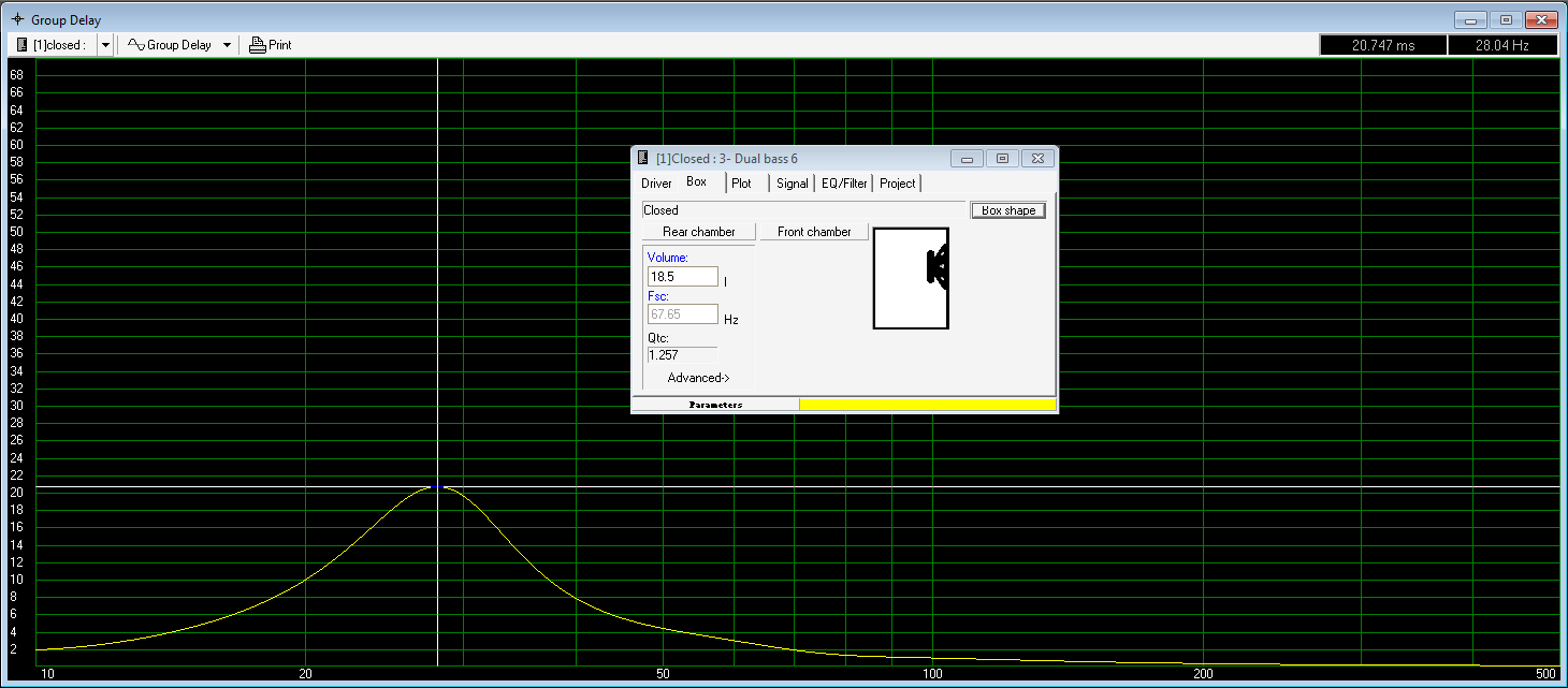

Thanks ICG,
Yes, I'm happy I've finally measured it right.
Yes! I finally made it to the next design!:)
Turns out it's an 18.5 lit. sealed box and turns out it has awesome group delay characteristics. also with some EQ, it can achieve F-10 = 21 Hz at reasonable power consumption.
You could try to put them in a high-pass-sealed-enclosure, about 30l. The capacitor value can be ...
Why high-pass when I can go lower? There's no need for caps - All the caps I need are back there in the PSU!
Besides, I have some decent Parametric EQ in my laptop from where I can apply an 8th order high-pass @ 30 Hz, which is much better than the one shown in the graphs.
