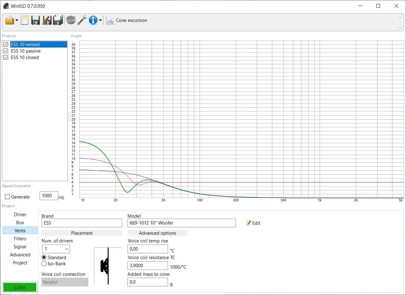

You should try to simulate the system before anything.
What you have as a 10" ESS in a closed box of size?
Maybe you can find the T/S parameters on the web or someone have a similar driver and could make a measurement e.g. with DATS.
... is it this one: https://www.hifisound.de/Do-it-your...SS-Woofer-10-Zoll-25-cm-ALU-Basket-4-OHM.html ?
Then use WinISD for simulating the system, first without a passive and then with.

ESS 10" in 50 l (not sure it's the right 10" or wether the parameters are correct ... just the one I had in WinISD, and just for example)
Green = reflex, Pink = passive, Blue = closed. Input 35V

About size og the passive vs the woofer, also depends on excursion, the displacement volume needs to be more then double that of the woofer. The ESS 10 inch I just looked at had an Xmax of only 4 mm. The Passive will likely have more then 10 mm excursion, thereby actually ensuring double displacement.
