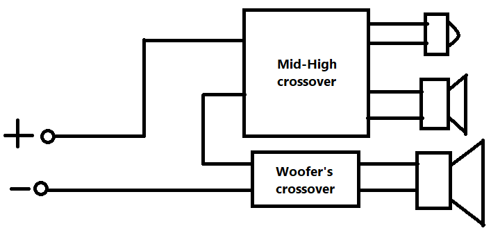

How about connecting the woofer in series? The diagram on attached shows connection in which the mid and high are connected normally, parallel, but the woofer will be connected in series. The result be an 8-Ohm system (4+4 Ohms), am I correct?
Solution is to high pass the midwoofer, effectively keeping impedance nominally 4 ohm. And still you need to carefully design both woofer LP and MidW HP. Gotta simulate at least. Midwoofer sealed, woofer ported or PRed. Dayton PR should work okay for woofer without adding any weights.
