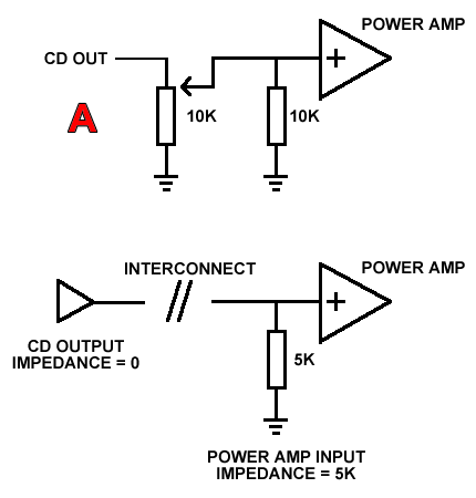

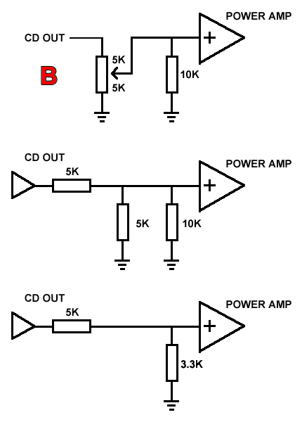

RDF is correct.presents to the CD:
a) 10K in parallel with 10K = 5K
b) 5K in series with (5k in parallel with 10K) = 5K + 3.3K = 8.3K
c) 10K
The reason for the big change in load seen by the CD is that the power amp input impedance is too low for a 10k passive pot.
I would suggest that the amp input impedance be at least 10times the source impedance. 10k pot has max output impedance of 2k5 (+Rs/4). The amp sees this as source impedance and it's minimum input impedance must be 25k.
I prefer 20times source impedance telling us that a 10k pot needs to see a 50k Zin.
A 20k pot needs 100k Rin, 50k pot needs 250k input impedance.

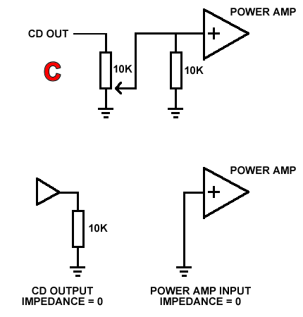

For best voltage transfer, we want a source with low output impedance and a load with high input impedance.
Source is CD Out. Load is Power Amplifier's Input Impedance.
The drawings below are the equivalents of A,B,C.
With a Passive Preamp, the Source Output Z and Power amp Input Z varies as the pot is adjusted.
