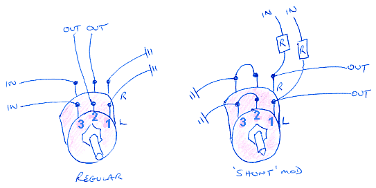

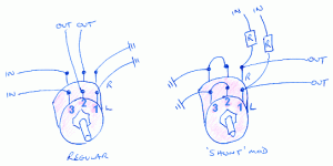

You will come across people who claim that you need high quality fixed series resistors and a variable resistor to ground (shunt) for the best quality; they say this because they believe that the signal path is only through the series resistors. Completely untrue; you can ignore anything they say. If you are using an ordinary pot then the best way to wire it is as a standard volume control; this is how it is designed to be used, and this is how people who understand how it works will wire it.

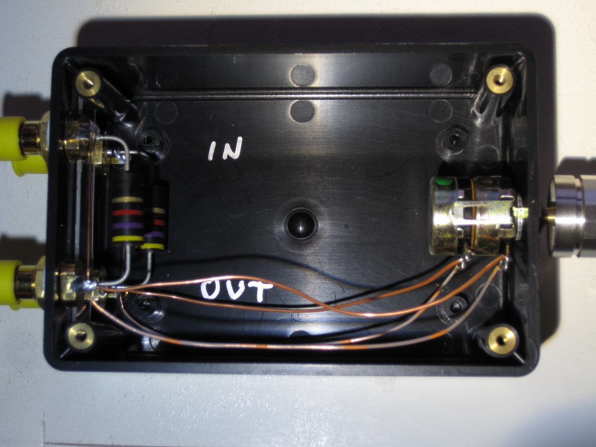

Here's mine, I used a 10K pot and 10K series resistors. It's made from plastic because I didn't want to connect the left and right shields. I had to make a metal fake unit to solder on because I didn't want to melt it, and then assemble it in the plastic one. It sounds great. :)
And we rehash this topic about once a month.
Is there an advantage to a properly designed stepped attenuator? You bet there is. Is there an advantage to "potentiometer not in the signal path" woo? No. In fact there are disadvantages, which were listed in the last thread about this topic.
