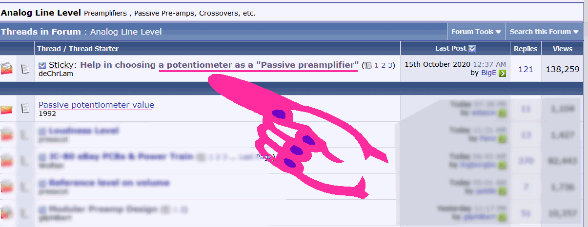

Did you look at the "Sticky" thread at the TOP of this section?
Certainly did, thanks, several times. I found the part about avoiding damage to your source a little unclear, so I thought I would check with specific equipment/figures. Apologies if it would have been better to reply on there instead of creating a new thread.
The sticky says avoid using low impedance pots in order to avoid source damage. According to the DACT calculator, even using pots up to 250k with my 18k input amp shouldn't cause audible low-pass-filtering (although I'm not sure what my capacitance is; cables are short at least). What's the reasoning behind 10k pots?
