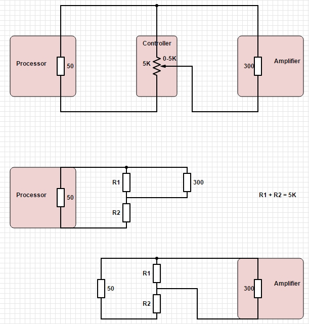

Is this correct (attached image)?
Meaning that:
- when R2=0 : the processor sees 535 Ohms and the amplifier 49.5 Ohms (full volume)
- when R2 = 5K : the processor sees 5K and the amplifier 0 Ohms (mute)
It's a bit unclear about the 0 Ohms impedance, maybe I got something wrong...
[edit] sorry, 600 instead of 300 in the image, but the idea is the same.

the schematics are not easy to read because you drew GND on top, but ok, you got it.
That the amp actually sees zero with volume turned down does not mean you have zero source impedance. This is the impedance the amp sees, but the value is useless in your application.
As you go near zero with your volume, the signal hast to pass more and more of the 5k resistor, so lower input impedances produce more loss at a given pot position.
So near zero it has almost grown to 5k. Amongst others, his theoretically may imply more interference, but practically will do no harm as long are cables are kept *short*.
