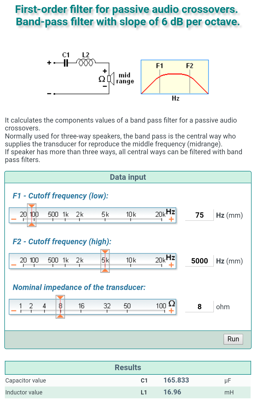

Now, here's the bit where I'm kinda stumped & also go a bit off the deep end... All 3 of these speakers are "full range" 20hz-20khz & I wanna build a passive low cut/high cut bandpass filter that will limit the frequencies of each speaker to low cut around the 75hz, then high cut around the 5khz range.
I attached a schematic I found reaching how to build one & it seems pretty easy... if that's correct & the what-not.
Here are my questions:
1- I assume each speaker will require it's own 8 ohm bandpass filter, is that right?
2- going off that assumption that i need bandpass circuits can I build all of them on 1 breadboard?
3- if so, how do I wire the amp out put to the bandpass filters and then to the speakers to come as close as possible to having the amp see the completed ohm load at/around 4 ohms w/o going over
4- if all of my plan is way off, I'd love to know what plan will make this work.

I was thinking that 1 crossover couldn't do more than 1 speaker... but if could run 1 crossover that could be applied to all 3 of the speakers that would be better. The other thing I didn't full grasp is like crossovers have ohms, but those cancel some of the speakers ohms... I'm not following that very well
Usually a simple high-pass involves wiring a (bipolar) capacitor in series with one speaker lead, and the simplest low-pass involves wiring an inductor in series.
In your case, though, there is a catch, and it worries me: if, for instance, you wire that cap in series to prevent frequencies below 75 Hz from reaching the speakers, it has the side-effect that you also remove the load from the amp output at frequencies below 75 Hz.
We all know valve (tube) amps don't like operating without a load on the output, so will this lack of a load at low frequencies put your amp in danger? I'm not sure, but I wouldn't want to find out the hard way, with a dead output transformer and/or output valves. 😱
There is a similar issue with the low-pass filter (series inductor) to remove the highs from the speakers. Once again, the load impedance presented to the amp will rise, this time at high frequencies. Once again, I'm not 100% sure how much of a risk this will pose to your amp, but my spidey-sense is tingling on this one - my gut tells me it's a Very Bad Idea (TM).
All is not lost - it principle, at least, it's possible to add additional inductors, resistors, and capacitors in parallel to (mostly) compensate for the impedance changes caused by the bandpass filter. But, in practice, this might turn out to be a bit complicated and expensive.
So what can you do with your project? Well, my first thought is that a normal guitar in standard tuning only puts out frequencies above 83 Hz, so maybe it doesn't matter if the speakers can go lower than that, particularly if the amp design filters out those deep frequencies long before they get to the speaker.
As for the high frequency end, the first idea that pops into my head is to do the filtering acoustically, rather than electronically. In other words, put a wad of foam or pillow-stuffing in front of the speakers, for instance, under the grille cloth, to filter out the high frequencies.
A bit awkward, and Hi-Fi speaker designers will beat their heads against the wall and scream in pain at the very thought, but it should work to muffle excessive high frequencies, and at least it won't hurt your expensive and powerful new amp!

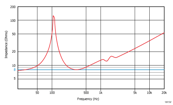

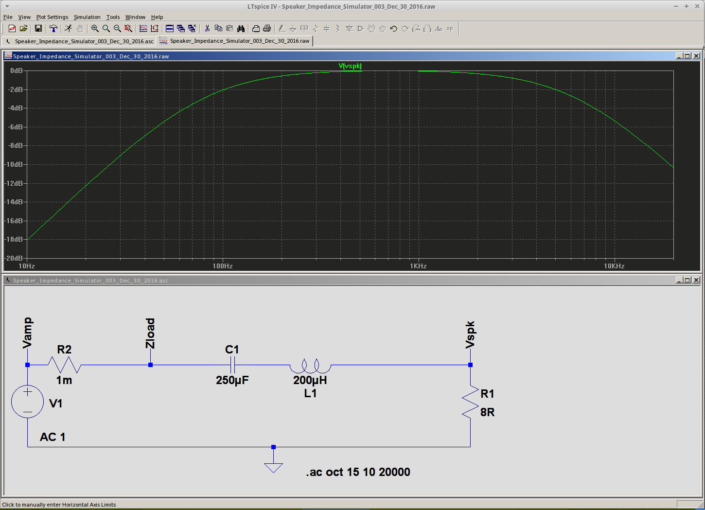

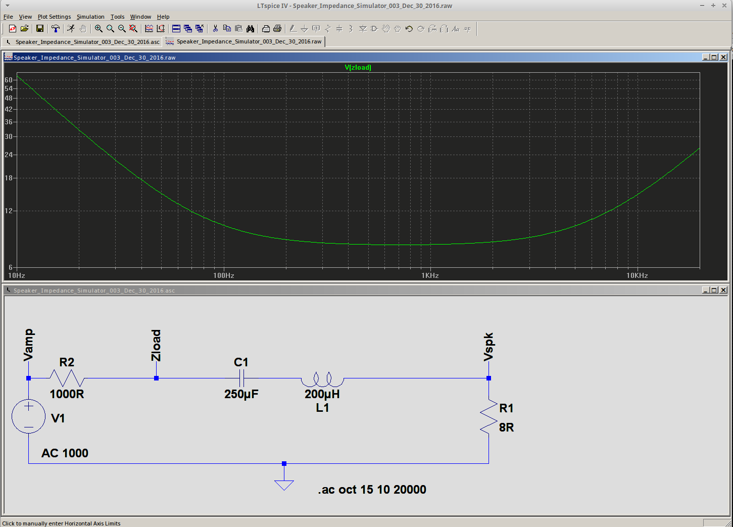

I did a little tinkering with LTSpice, inserting a passive, first-order, bandpass filter ahead of a dummy 8 ohm load representing the speaker. Then I plotted frequency response at the speaker, and impedance presented to the amp. The results are in the two attached screenshots.
The frequency response is down 3 dB at about 80 Hz and about 6 kHz, more or less what you wanted, and more or less what we usually expect for an electric guitar speaker.
The impedance changes due to the bandpass filter aren't as bad as I had been imagining. Load impedance climbs to over 60 ohms at 10 Hz (and will climb to infinity as the frequency goes down from 10 Hz to DC). At the high end, it's only about 15 ohms at 10 kHz.
Please note that I didn't model all the variation in a real speaker's own impedance - to keep things simple, I just represented the speaker as an 8 ohm resistor.
That means that with an actual speaker, we can expect more severe and more dramatic impedance changes than the attached plots.
Still, this is a reasonably valid way to find out the effect of the bandpass filter alone. And the answer is that it's not as bad as I thought it might be. It doesn't look a whole heck of a lot worse than the impedance changes of just that single 12-inch guitar speaker by itself (in my previous post), in fact.
So, is it safe to overdrive a 100 watt guitar amp into this sort of load? That, I still don't know!
-Gnobuddy

A speaker has a voice coil wound with a length of fairly thin copper wire. Because it's thin and long, there are several ohms of resistance. But because it's a coil, and that too one with a chunk of iron in the middle, it's also got inductive reactance, which adds to the actual resistance of the coil.
That explains the DC ohms you measure on a speaker, and also the smooth rise in impedance above 500 Hz or so.
The other noteworthy feature in the guitar speaker impedance plot - the big hump around 100 Hz - comes from something else altogether. It comes from the fact that the voice coil sitting in the speaker magnet also behaves as an AC generator once the speaker starts to vibrate. The coil generates an AC voltage that opposes the voltage trying to drive the speaker in the first place - so you get less current flow - so you get more "resistance". The big hump at 100 Hz is because that's the frequency at which this particular speaker likes to move most freely, i.e., it's the fundamental resonance frequency of that particular speaker.

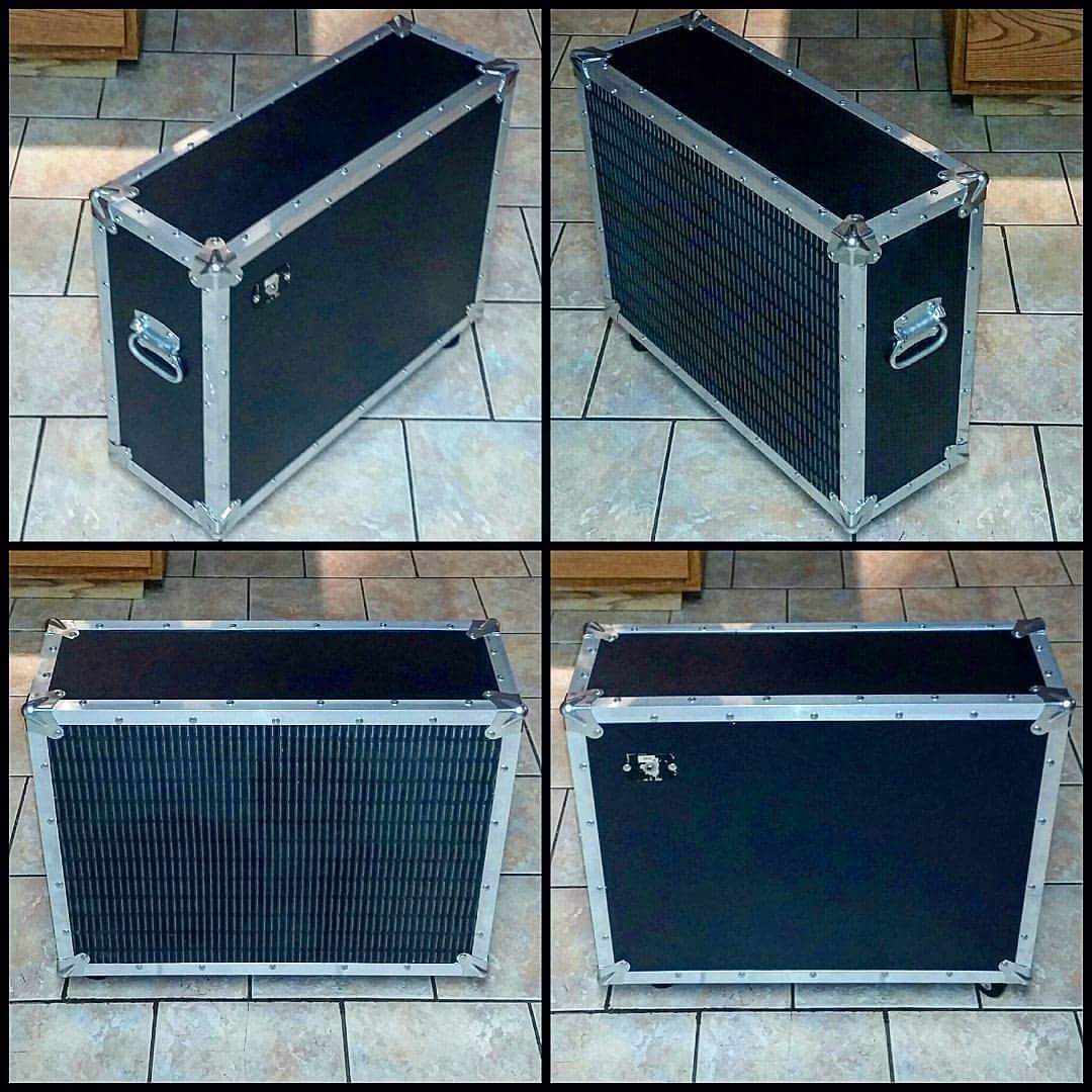

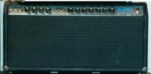

I know folks like to keep there amps & effects separate, but I came up with an amp head design based off a '65 Reissue Fender Twin, but also included switching to various versions of the Rat ProCo drive & had a Purple Peaker EQ option in the signal chain... had some issues trying to find a way to pull 9v out of somewhere for both typically pedal fx that I planned to build into the setup. Then designed a 3 speaker configuration cab that was loaded with 1 12", 1 10" & 1 6" speakers... I wired up the 12 & 10 as 2 16 ohm speakers down to 8 ohms & then used a plug & play stereo jack plate. I picked the 12 & 10 speakers that would be sharing power to have a shared sensitivity of 100dB (97dB & 97dB) & then the 6" the will get twice as much power a sensitivity half as loud (90dB) to kinda keep a balance between all the speakers to have similar perceived loudness. Haven't been able to finish up the amp build, cost/time & I'm not sure exact how I want the amp aesthetic to be & have the chassis made... but I was able to prototype the cab & it sounds good to me. I've attached a pic of that as well as 2 other designs I made using a similar speaker configuration.
I really appreciate all the feedback & hopefully this current project will come out as a further education in the creative process & I can get an amp prototype together soon!

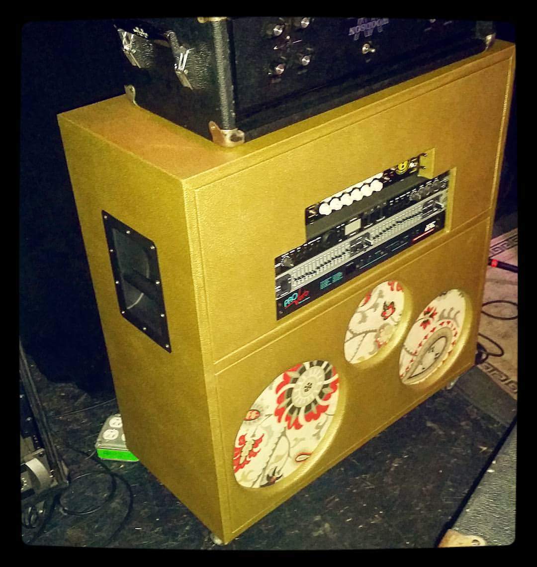

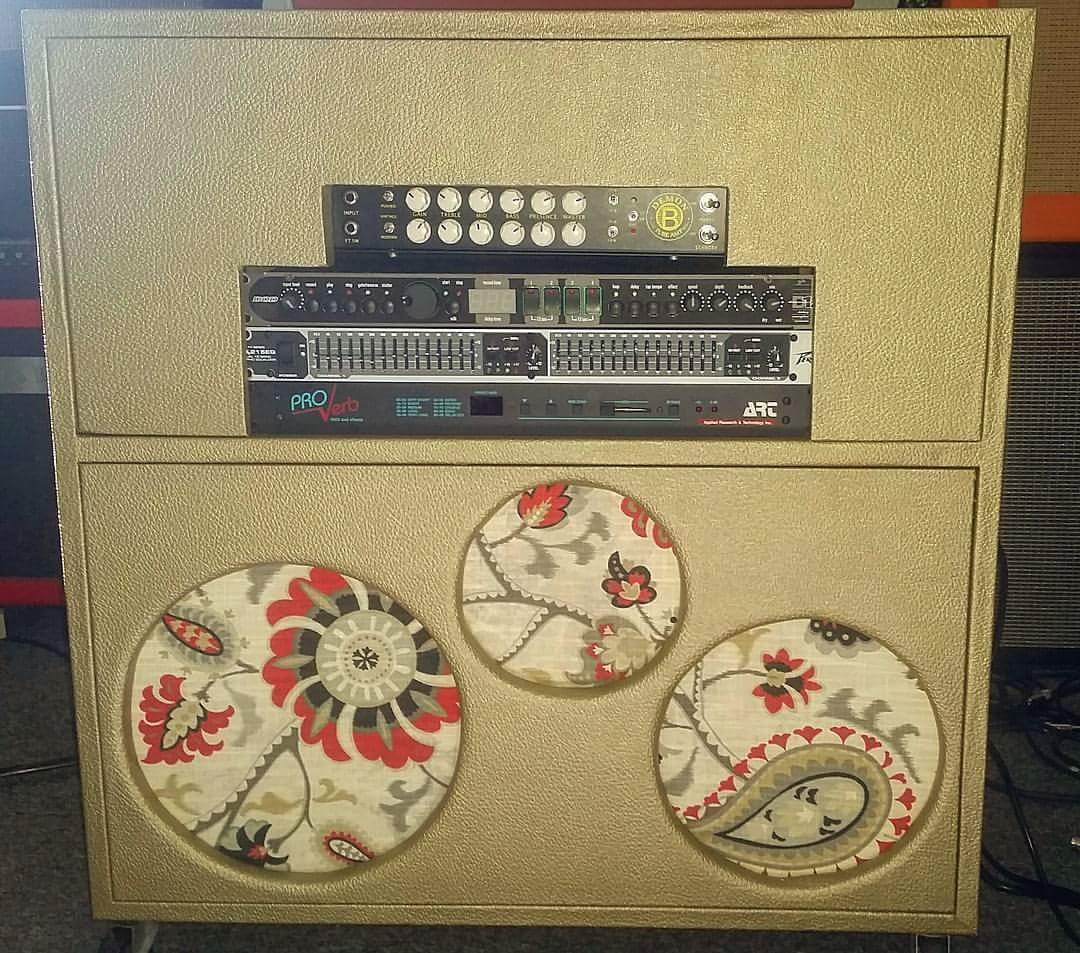

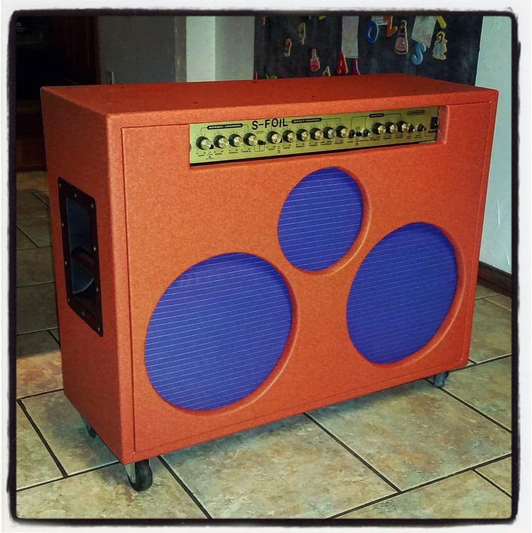

Interesting looking amps, quite unique in the usual sea of Fender/Marshall stuff!
