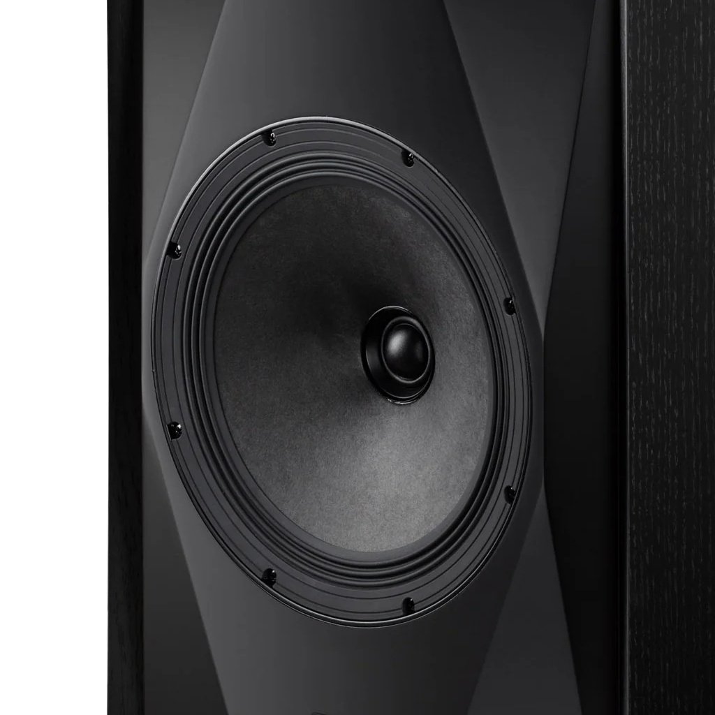

I've mentioned this a hundred times, but based on conversations I've had with Andrew Jones, he opts for soft dome tweeters because they have a rising response at high frequency. This is because the 'tip' of the dome decouples at high frequency, which makes the tweeter behave as if it's MMS is less than it really is.
IE, when the dome decouples, only the edge of the dome attached to the surround is moving. The motor force doesn't change. Net effect is that response rises. Basic "F=MA"
The first attached pic shows one of Andrew's recent speakers

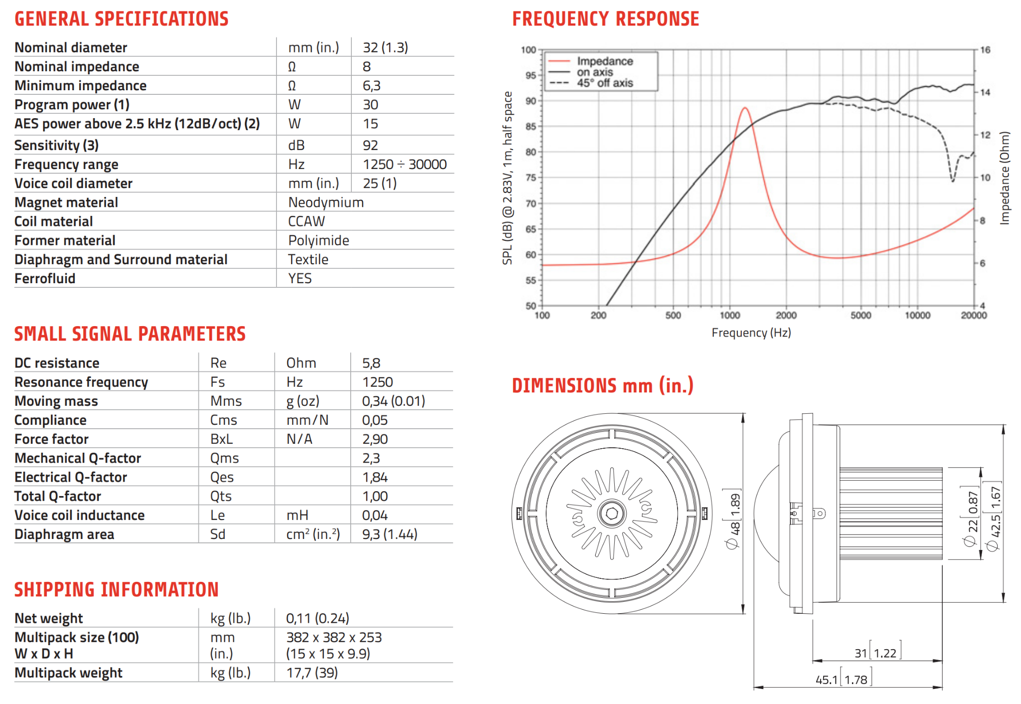

The second attached pic shows the LaVoce TN131. Note how the high frequency response rises.
The TN100 - which is 75% as wide as the TN131 - doesn't exhibit this behavior as much. My 'hunch' is that the SMALLER tweeter decouples LESS than the large tweeter. With a metal dome tweeter, this wouldn't happen, but a soft dome isn't remotely as rigid. It de-couples.
