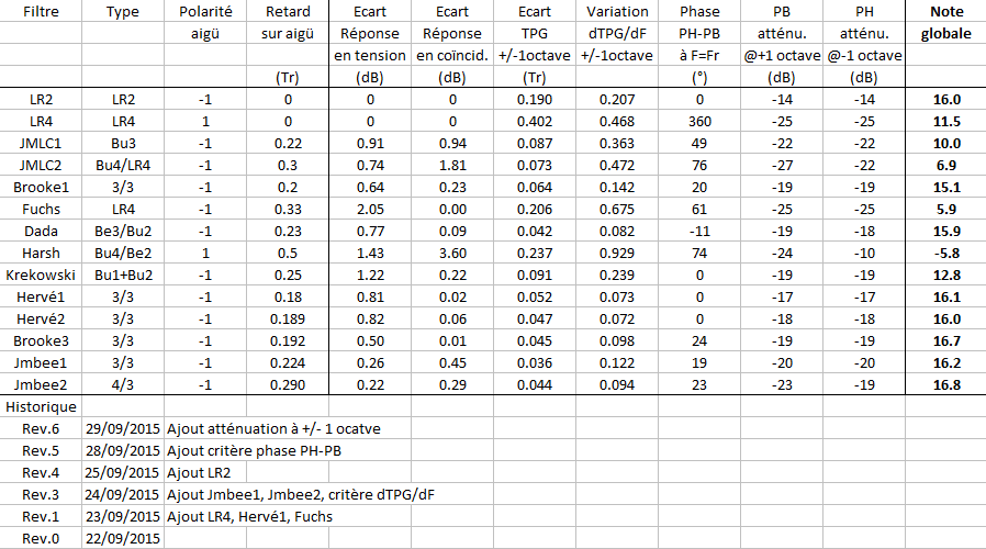

To add the documentation of this thread, google translation is your ami : 5.3 Comment filtrer les haut-parleurs ? - francis.audio
it talks also on the quasi perfect transcient filters too and there is at the end an interesting screen board that sort out qualities and defaults vis à vis of more classic filters like a second order...very interrestinginformative. We saw a Harsch is not well rated and ask the most horizontal spacing which is a problem passive. Of course the only one where the drivers are in positive polarity (while I like also what is doing Proac with all the two ways where both drivers see their signal coming to the negative pole of the drivers, close logic I assume ?
Some works of <Jean-Marie >Le Cléach on the quasi transcient perfect filter in 3 ways that can be more handy than the Duelend which asks very linear drivers which is not easy - see the excellent work the fun guys at HTGuide are doing for illustration about Duelund filters type-
I have found also this link is explaining well for basic people like I am , the difference between group delay, phase and le savoir faire in the filter related to the "time" aligement of the driver in the filter.
- PASSIVE Linear Phase (Quasi Transient Perfect) XO s
