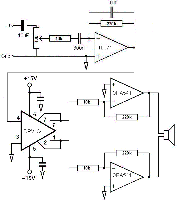

i know what the symbol means, i just thought it strange to have a polarised electrolytic in the signal path.
so bridging doubles the power, and paralleling just spreads the load between the chips?
so i need to bridge 4 chips, fine. i was going to do this originally, but no one would give me a simple answer to whether paralleling or bridging doubled the power. i asumed it was paralleling, and chose to parallel the chips.
could you draw a diagram to show what you mean? i connect as the diagram i posted (with DRV134), and then to four chips (two paralleled on each side), with the filter network you suggested, on each chip?
It's very common to have a polarised electrolytic cap in the signal path like that. A bipolar is better, I just showed a polarised one so that if you used one you would know which way to connect it.
Bridging *doubles the voltage* which means you *quadruple the power*
Your assumption on how to connect the amps is correct. However, I would strongly advocate that you build the amps as you originally intended, i.e. not as active filters. Also do away with the volume control pot. Then build an active filter using an op-amp. The way you do this is exactly the same as if you had built a power amp, just a smaller chip :) So on this one you do include the volume control pot. Now just feed the active filter into the bridging chip as per that schematic you posted.
This way avoids each amp having slightly different filter characteristics, saves on parts, and makes it much easier to upgrade later.

what opamp should i use? OPA627? TL071/2?
TL07X it is then. i have a few lying around.
how do i connect it? just an inverting amp with the filter as above, running into the DRV134, running into the OPAs? like this?
thanks for all your help so far. :D

richie00boy said:
Good shot kid, I think ya got it :)
You need to make each of those OPAs 2 paralleled chips, but I know you know that, it's just easier to draw 1 :)

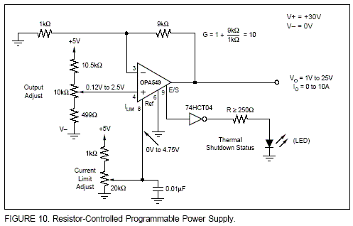

i have some more OPA541s (the AM version). couldnt i use these, with the diagram below, to make a voltage and current limited PSU?
i know it is for the OPA549, but the voltage reulation should work, even if i have to change the resistor values, and i could use perminant resistor instead of the potentiometer to get a fixed output voltage.
the current limit wouldnt work with this circuit, but i am not interested in current limiting.

I've only seen the data sheet for the chip you are using in the amp. You could use the chip as a voltage regulator, just check out the data sheet to see what the max current is. Find the safe operating area graph and find the voltage scale. Look on this scale for the voltage that equals Vsupply-Vout, i.e. how much voltage the chip will be dropping, then read across on the load-line to find the max current you can work with. There was no DC load-line on the graph of the data sheet I saw, so go with the one closest to DC (maybe 100ms) and then restrict yourself to half what current you read off.
As to the current limiting bit, providing the pin-out is the same on the two chips and they are comparable in specs, it should work.
