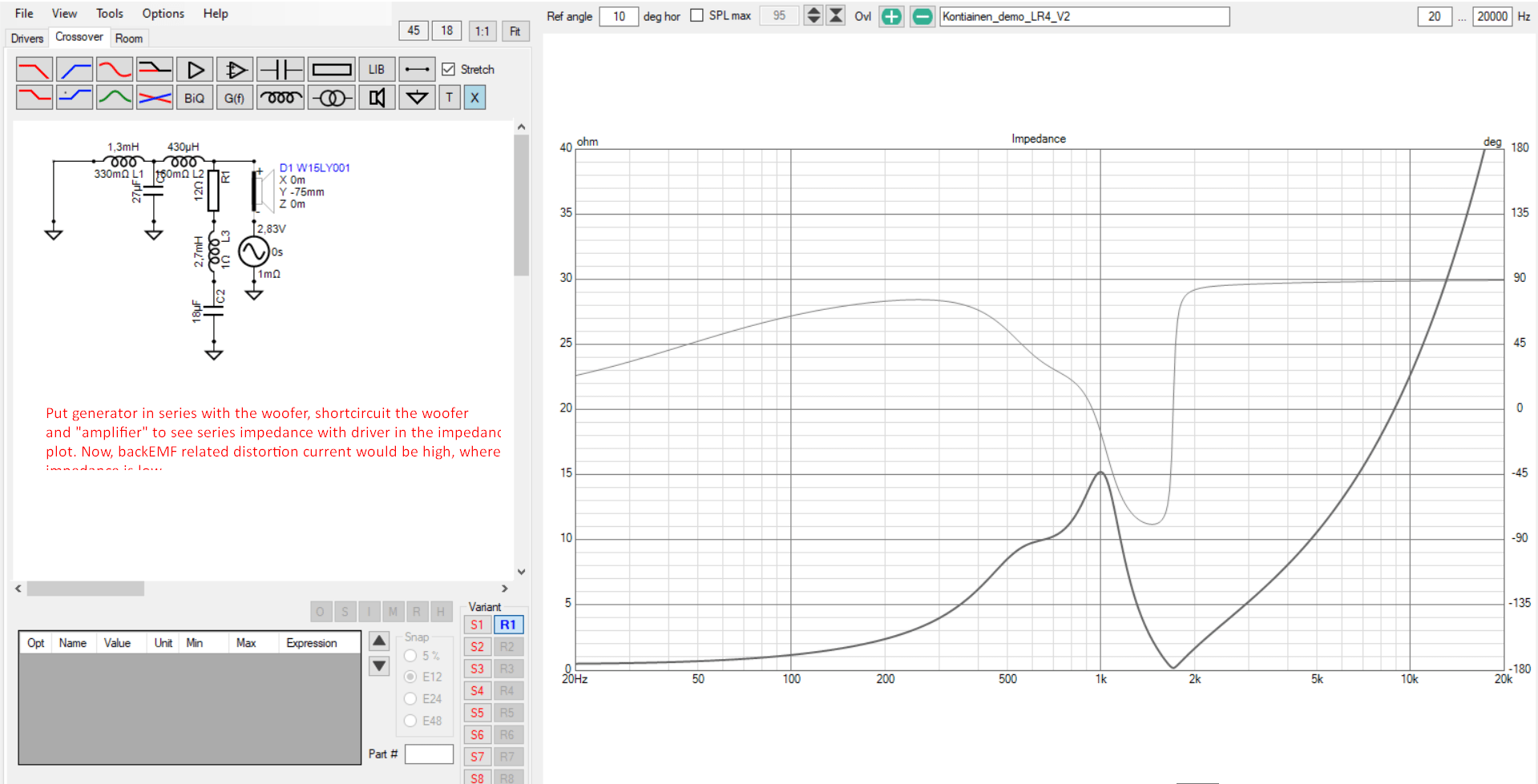

here how to inspect impedance in series with driver with VituixCAD. When impedance is high, there is distortion reduction, when it's low, there is not.

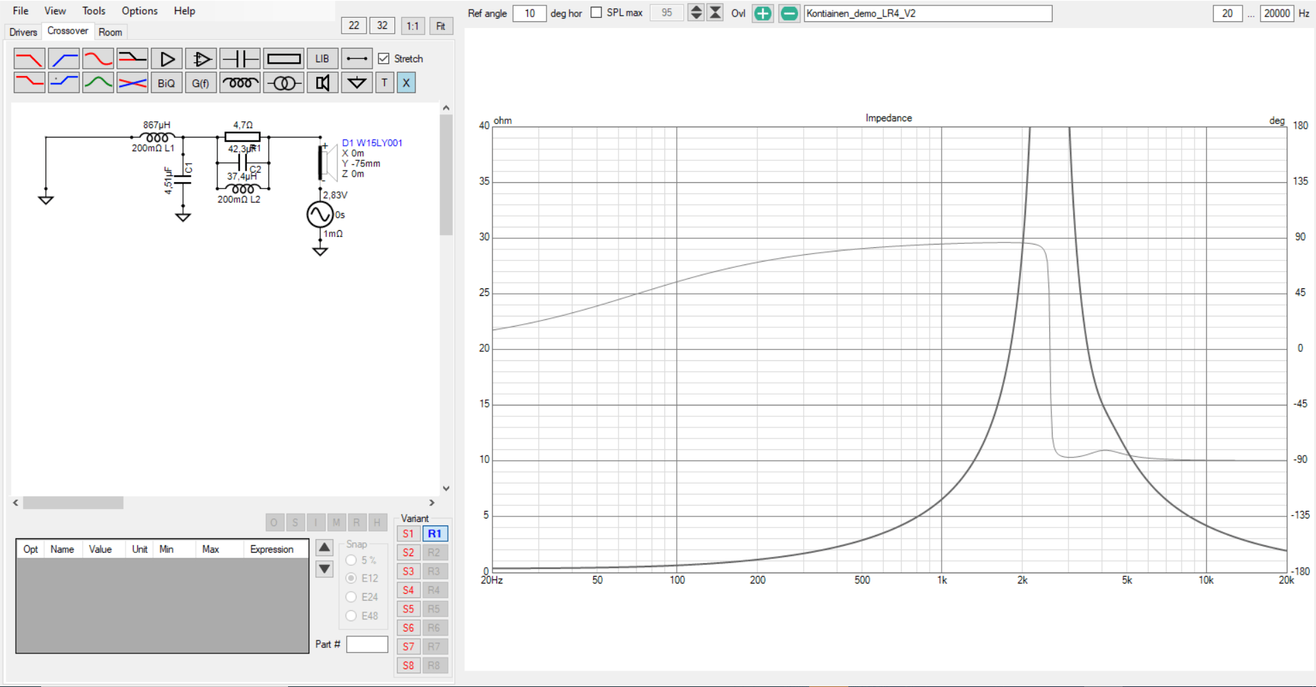

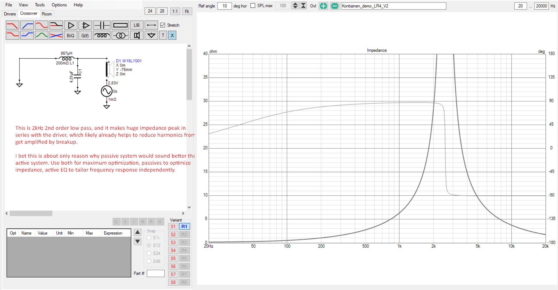

Here is example to your question, AllenB already linked to similar. A 2nd order low pass makes convenient impedance peak just above low pass frequency which likely helps with the distortion already, but it is so gradual low-pass the breakup peak would still be obvious in frequency response and could still benefit from a notch filter to knock it down.

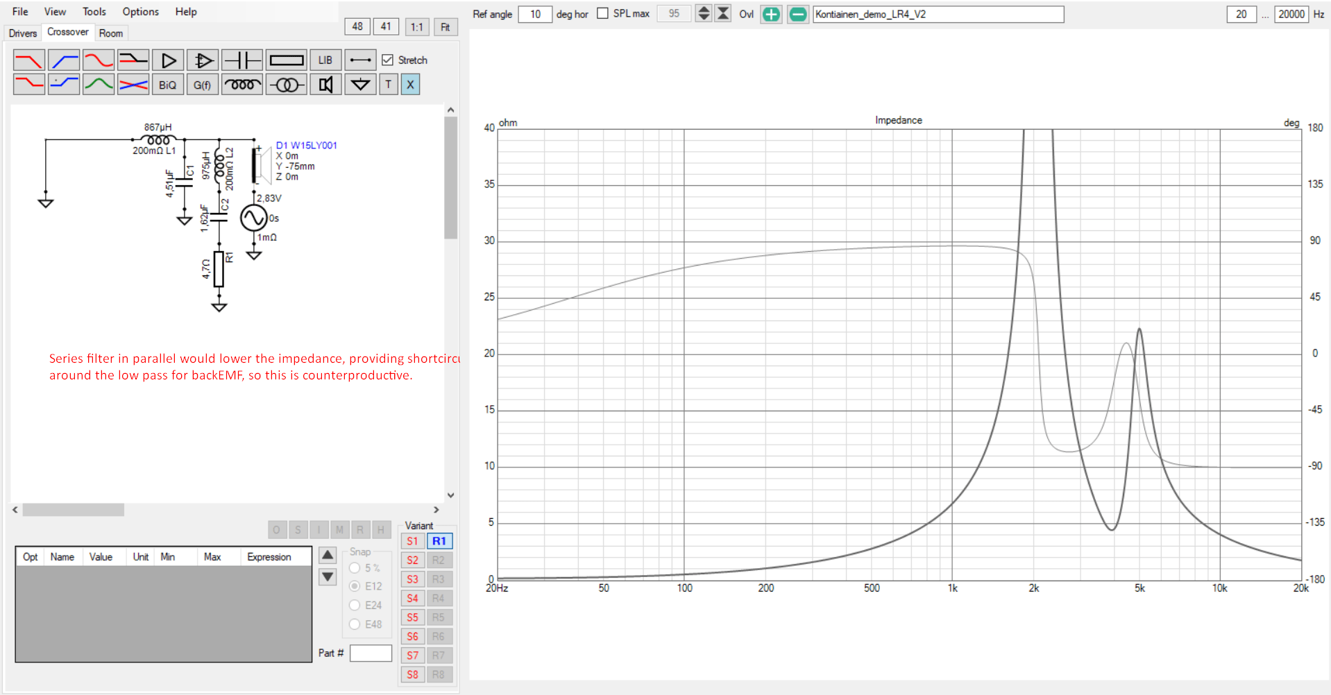

And, to notch the peak with a series notch in parallel with driver would provide low impedance circuit around the low pass filter for the backEMF current to flow, this is counter productive so you'd still want the parallel notch in series with the driver to maintain high impedance, and have effect on frequency response.
Anyway, you should be fine as long as you pay some attention to this kind of stuff, are aware of this distortion mechanism so don't accidentally use worst possible xo for example, but can take this stuff into account. For example, make a good frequency response happen, then check out what the impedance looks like, if it's above zero it's already better than if it was an active system, voltage amp with short wires straight to woofer. If it near zero, perhaps see if you can juggle things a bit.

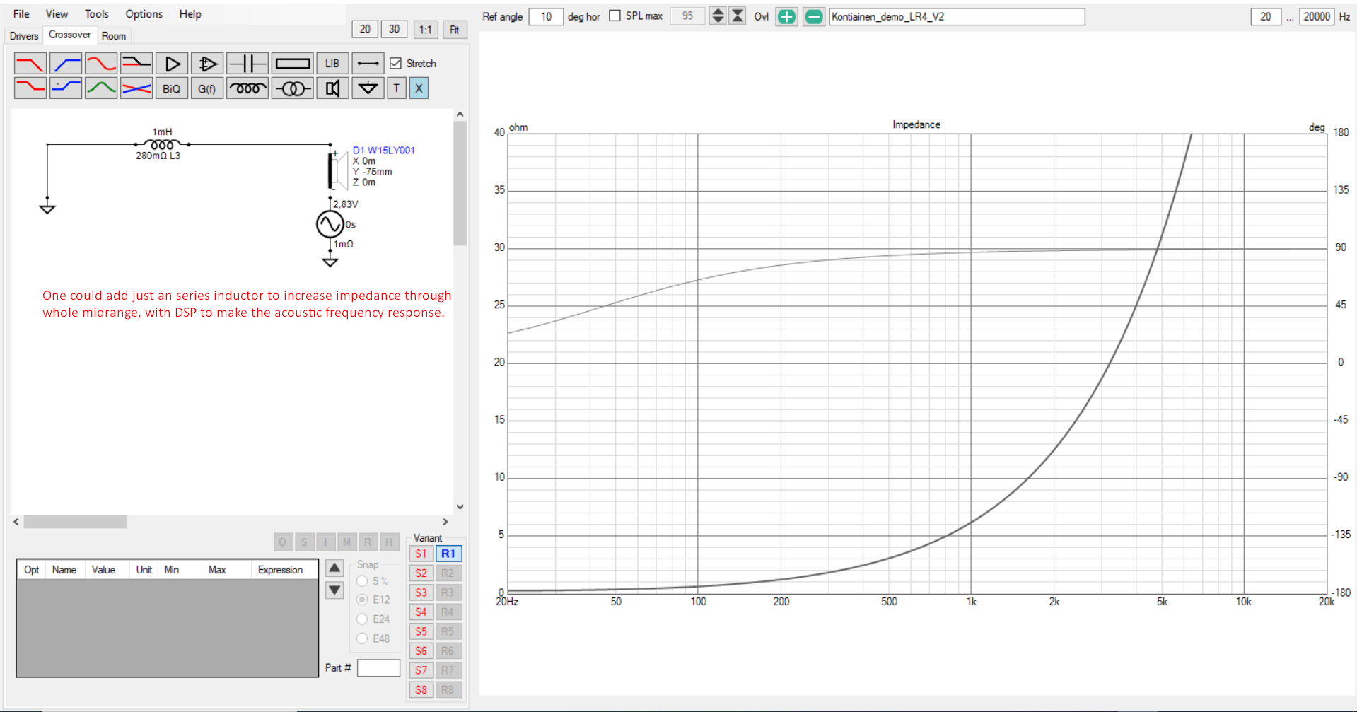

For active system simplest thing is to add series inductor to make one pole of low pass, and then tailor the acoustic response with active EQ.
