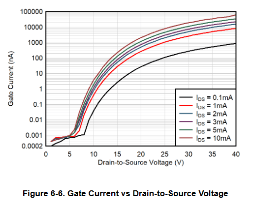

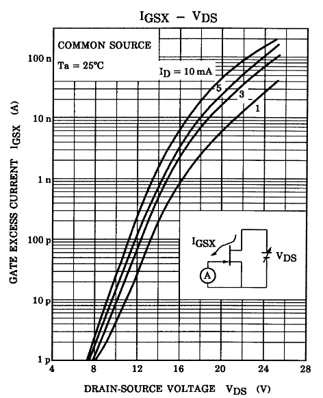

the max fet voltage is especially important when hot plugging the device into the phantom powered line. The large for noise input coupling capacitors of the preamp are charged at 48V. some diodes are limiting the negative swing of the amp input upon plug in, so the peak current will be delivered by the input coupling caps.
Last but not least, gate current can be as high as 10µA at 25V Vds (using JFE2140 as an example).
But this reduces to 10nA at Vds = 12V.
One can reduce Vds to say 12V by simply using a higher bias (~5mA).
Or add a 3k resistor to the drain, with next to no impact on distortion.
Toshiba JFETs also have much lower gate current, according to published data.
Patrick
