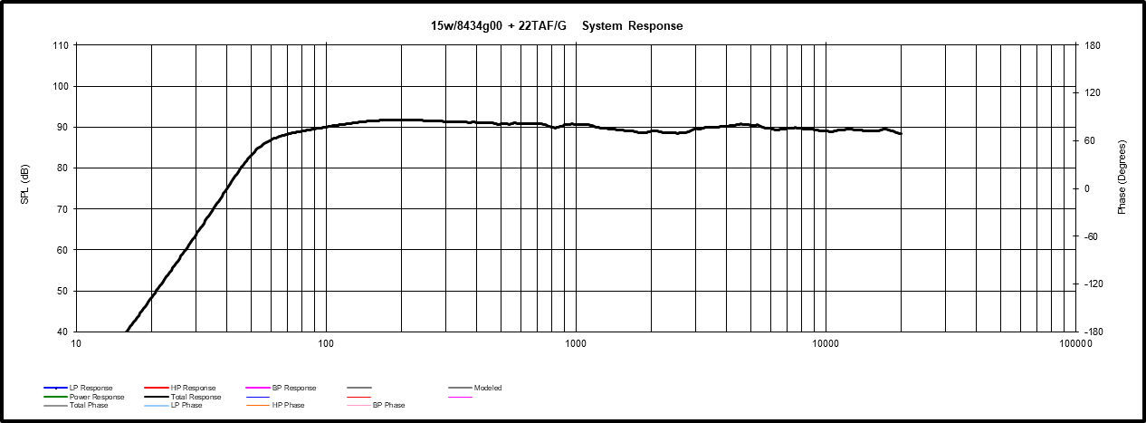

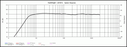

FWIW, this is an MTM with the 22 & the 15w/8434 that I've been fooling about with for a little while. Crossover is 1.9KHz, asymmetric LR4, partly aping the Canalis Anima in that sense; pair of drivers of course & a different target response, but IIRC Joachim used BW3 which puts greater demands on the tweeter as it's only 3dB down at the crossover rather than -6dB, so we know from that & some basic modelling it can handle it, albeit firmly in the 'ambitious' end of how you'd be running the 22. 😉 In a sense, this is also me hybridising it with Lynn Olson's Ariel, as I'm using a very mild Gundry / Harwood style midband EQ and a slight 2dB declining response trend. Work in progress (amongst a round million other projects and the square root of jack budget) but has potential, assuming I can ever get it finished. Modelled rather than measured nearfield spliced in @ just under 300Hz as I haven't finished the box load yet (it's a hybrid TL & being a bit of a pain to tune), so ignore the LF, it's there just as an approximation so the rest is visually balanced.

Thanks for the tip. That models very good, wow!
