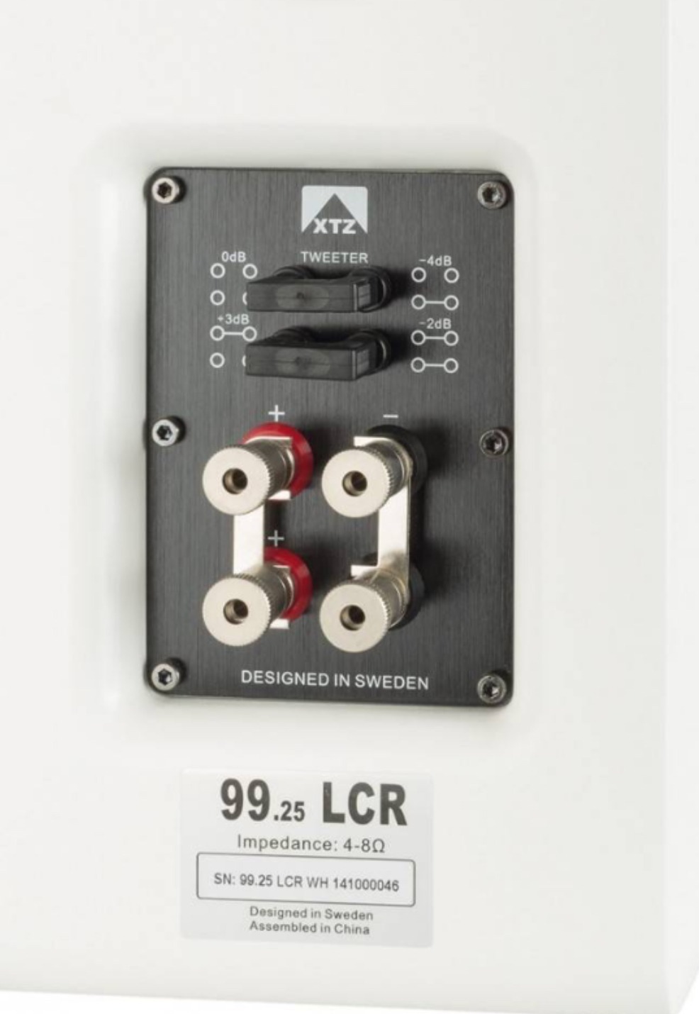

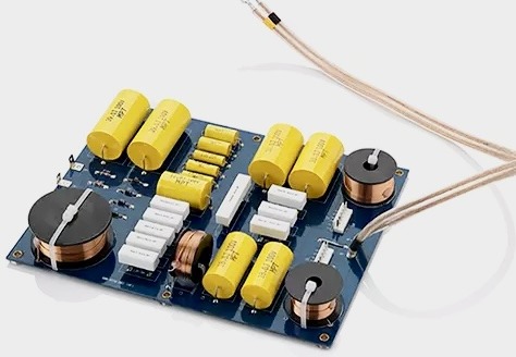

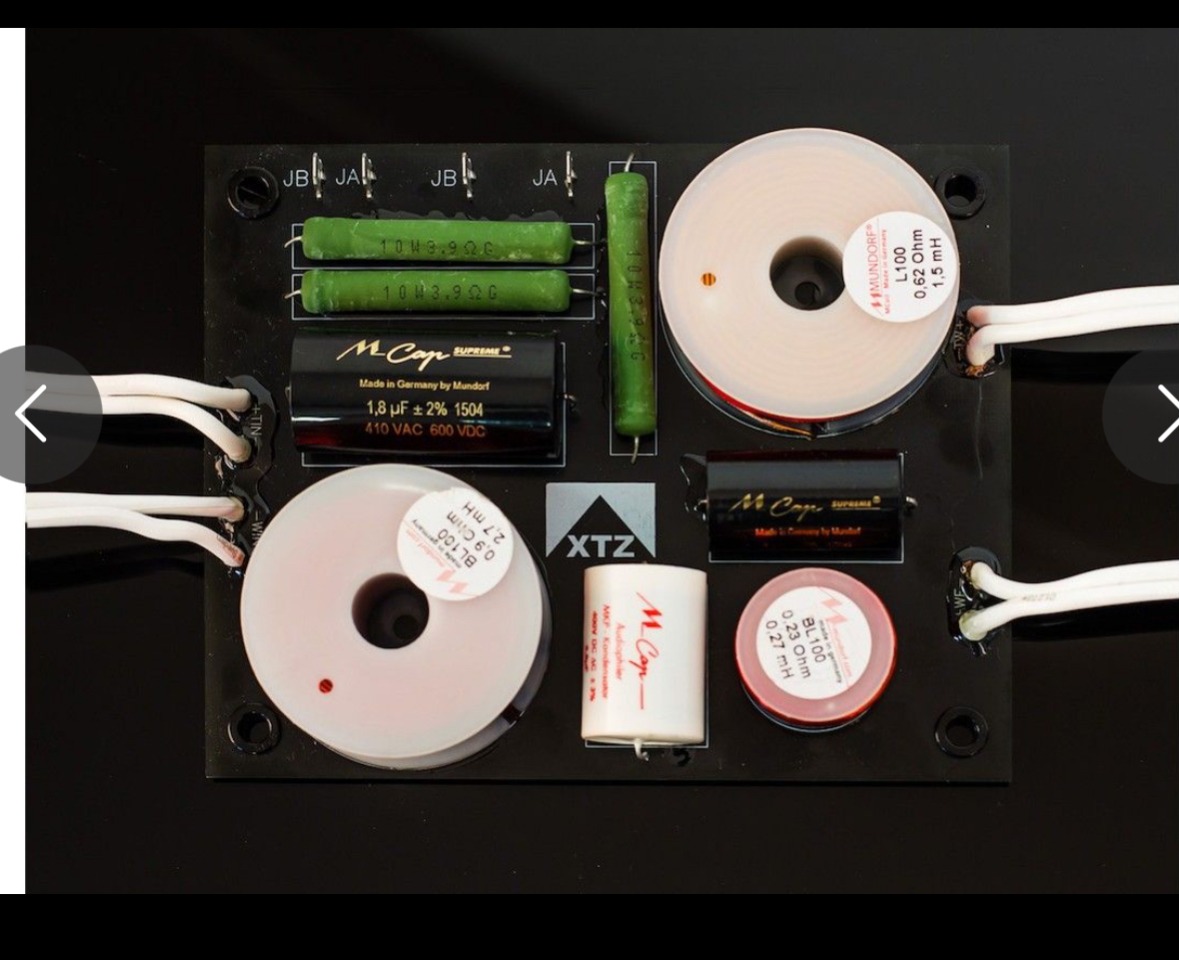

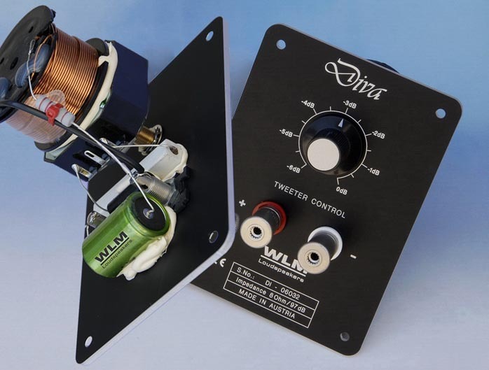

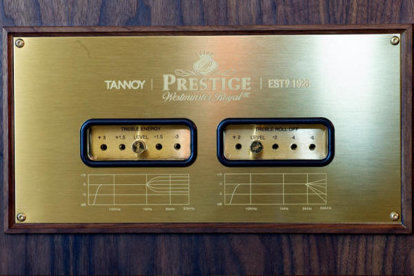

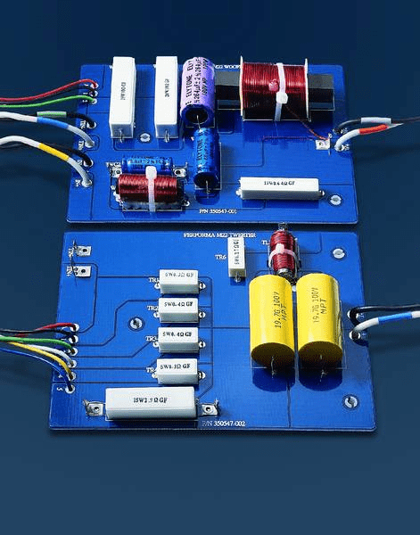

Please post ideas of how you make crossovers with different kinds of adjustements. The easiest way is off coarse to use a variable L-pad for the tweeter, but it is a lot more options as i understand:
https://davis-acoustics.com/en/mv-one-master-2/

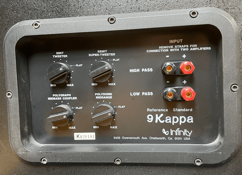

Those appear to be rotary switches. They can switch in more complex contouring sections than just an Lpad. Also you might switch in different cutoff frequencies.

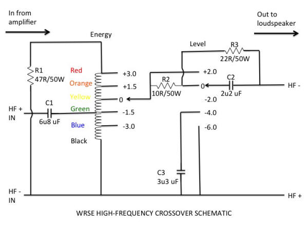

I see a low frequency compensation control in the first post. It could be done as follows (just switch one of three resistors for example), and by using a dual throw switch which also attenuates the tweeter. This circuit has also been used for variable baffle compensation, if that's a wanted thing.

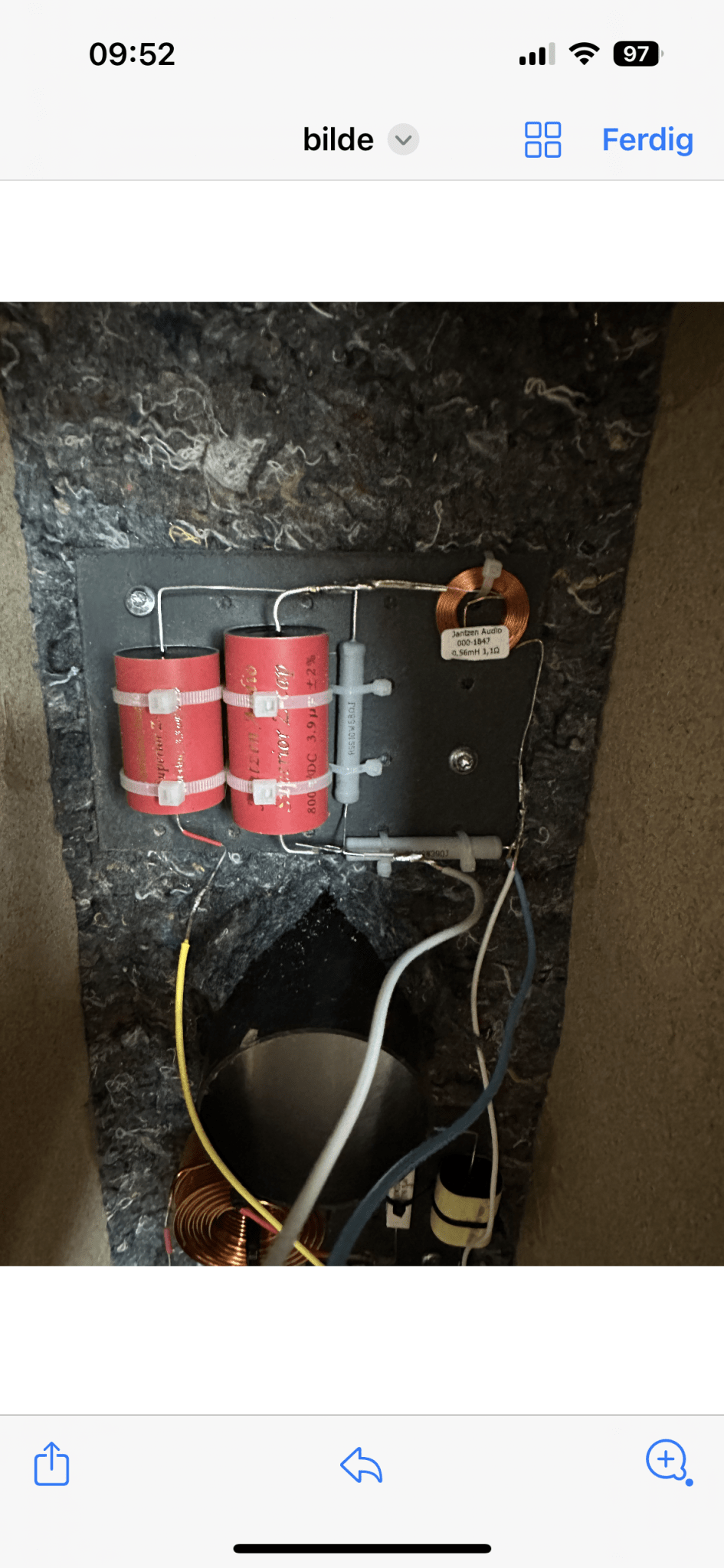

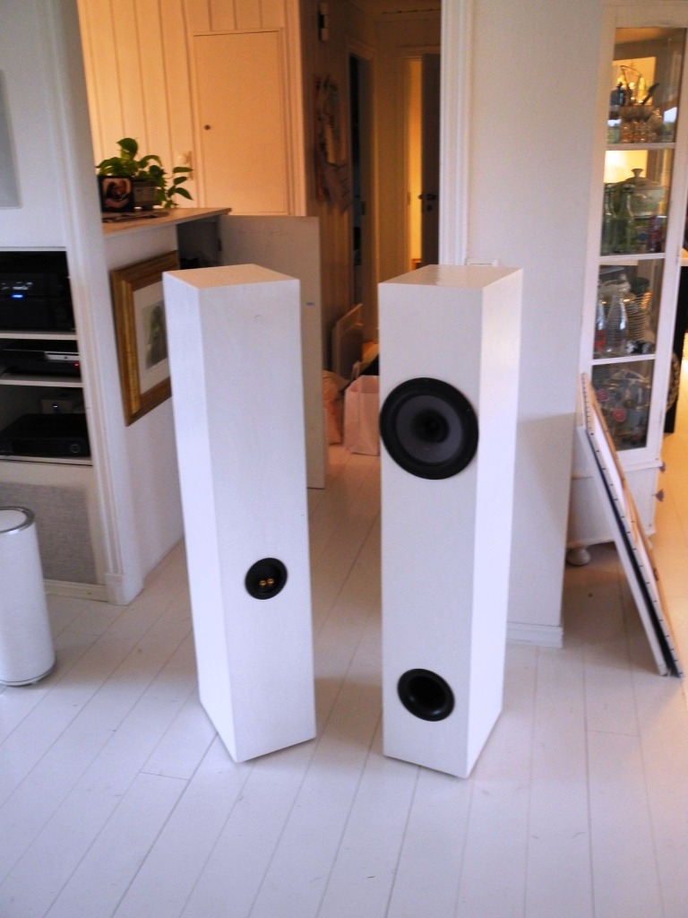

I think especially on fullrange speakers it is interesting to play with the 3 different correction circuits: impedance correction, BBC, and baffelstep

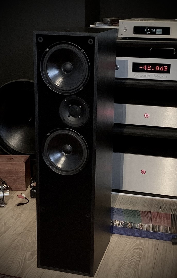

I made Seas FA22 in large enclosures for over 10 years ago with such filter but without switches. A new pair will be made this winter with a lot of adjustement switches.
From 2011 🙂
From 2011 🙂

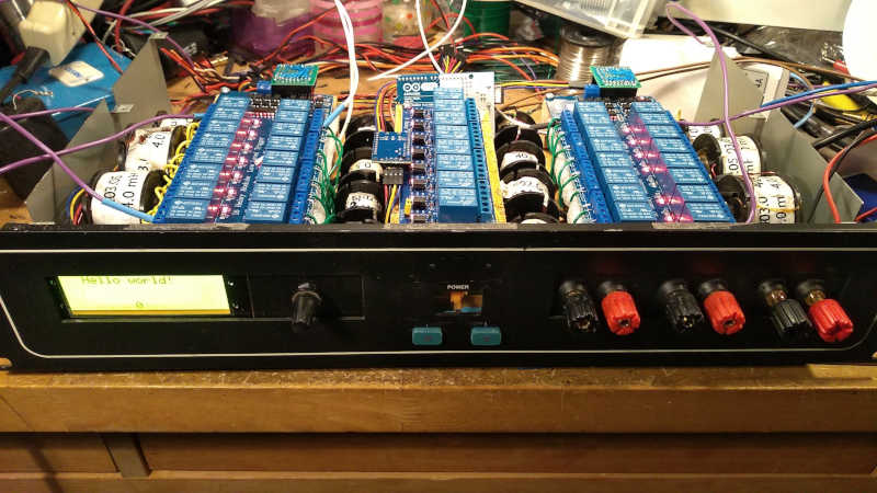

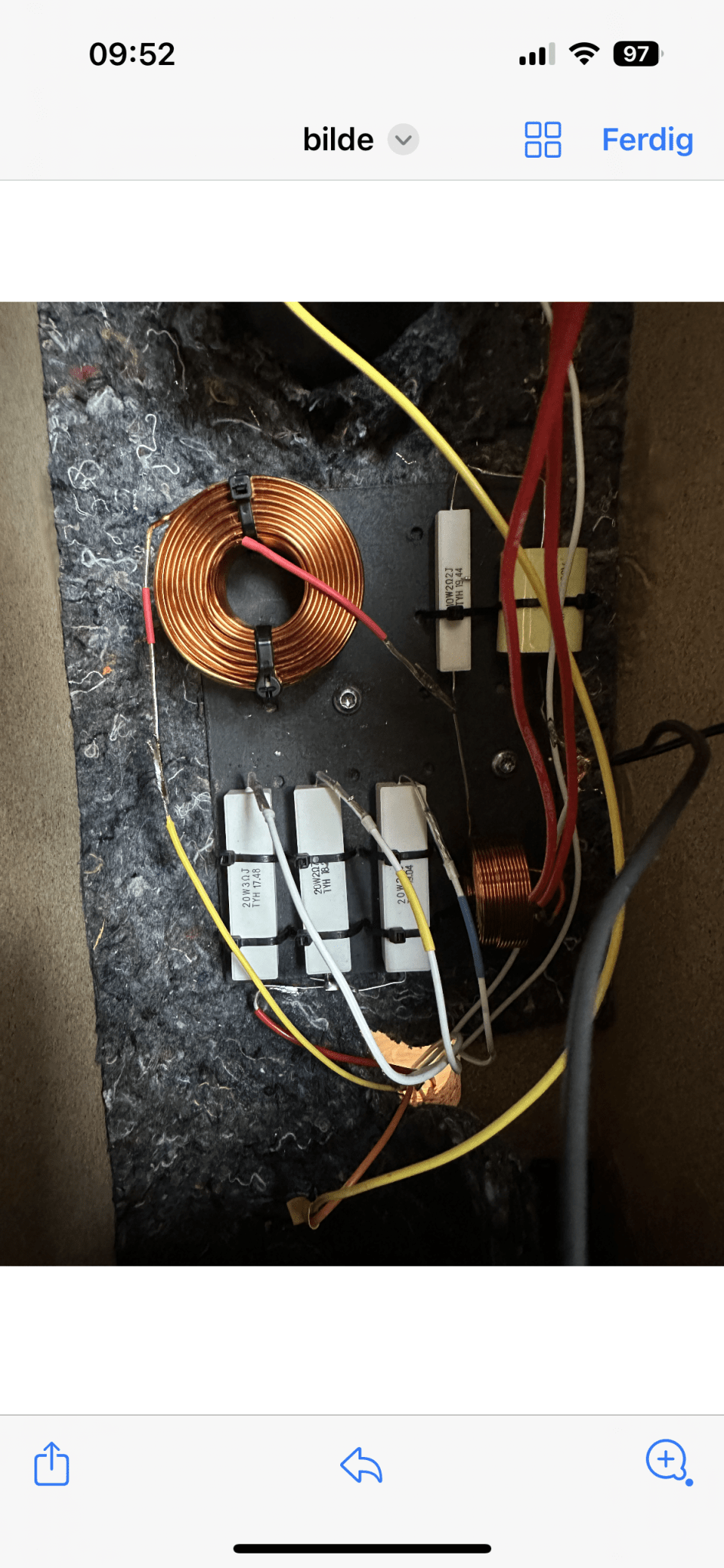

This is a gadget I have made to help with prototyping crossovers, the Ultimate Gadget even (UG). It has some compromises as built on the cheap, with lots of old Wharfedale inductors, which have higher series resistance than I would like, but hopefully it should allow me to get to the ball park more quickly.
It is very flexible but basic spec, it has 2x variable inductors, and 2 x variable capacitors, which can be configured primarily as a 2 way 2nd order crossover, but also as one filter, up to 4th order or 2nd order with a notch. I haven't quite finished it yet, so I need to make sure it can do baffle step, and parallel series as well with external variable resistors.

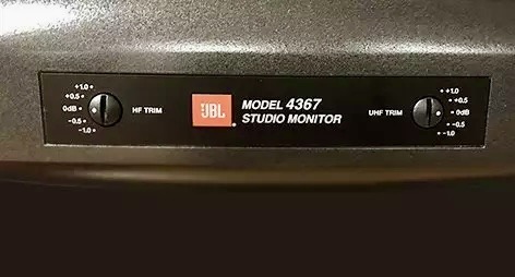

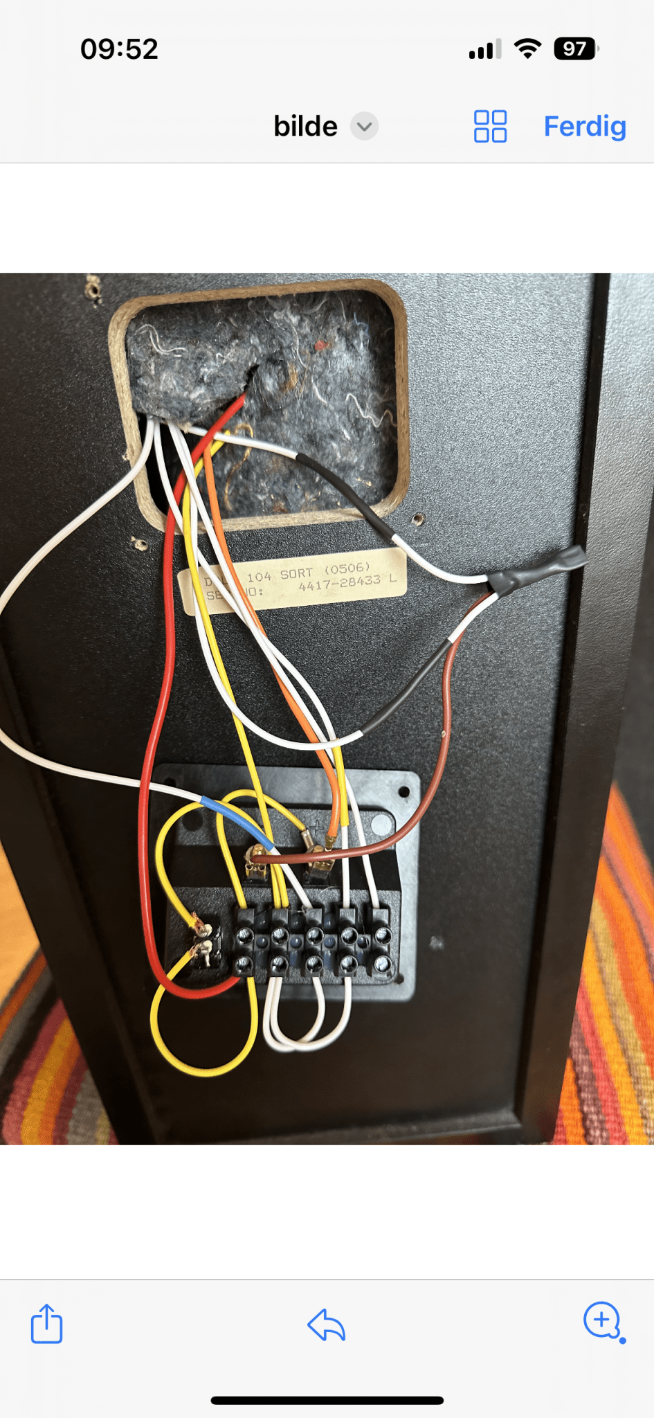

Best way I know is to avoid L-pads, they get noisy and are not precise. JBL uses a selector switch in Everest and jumper bars in the L250Ti. These can also have contact issues but more importantly they are much better from a repeatability aspect.
Rob 🙂
Rob 🙂
