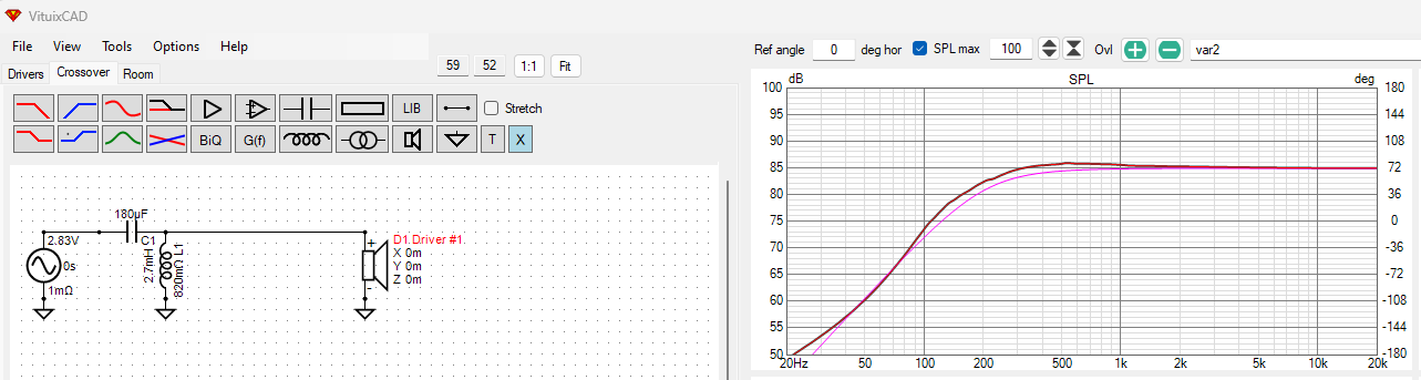

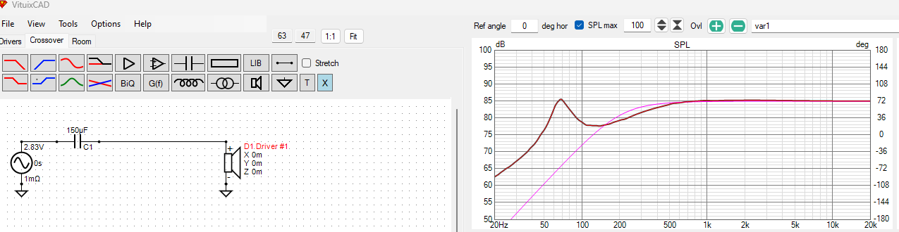

That is a normal and expected response.
You need to go with a second order electrical to damp the peak.
See the simulation below with ideal driver' FR, BUT the impedance is the actual one traced from Scan' graph for 18M4631.
Only to get the idea...your actual FR (and impedance) measurement should be used of course.
