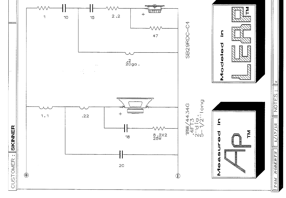

I see many schematics that describe multiple resistors in the circuit - as a example 2 @ 8 ohms but they dont state if the are to be wired in series or Parallel is there a standard that applies - as - always in series or the opposite Parallel ? this is for a crossover thanks in advance
The resistors could be either in series or in parallel to get the needed value,
but a 16 ohm resistor in a speaker crossover would be much more unusual, than a 4 ohm resistor.
Of course you could just use a single resistor of the right value and power rating.
this is what I have
