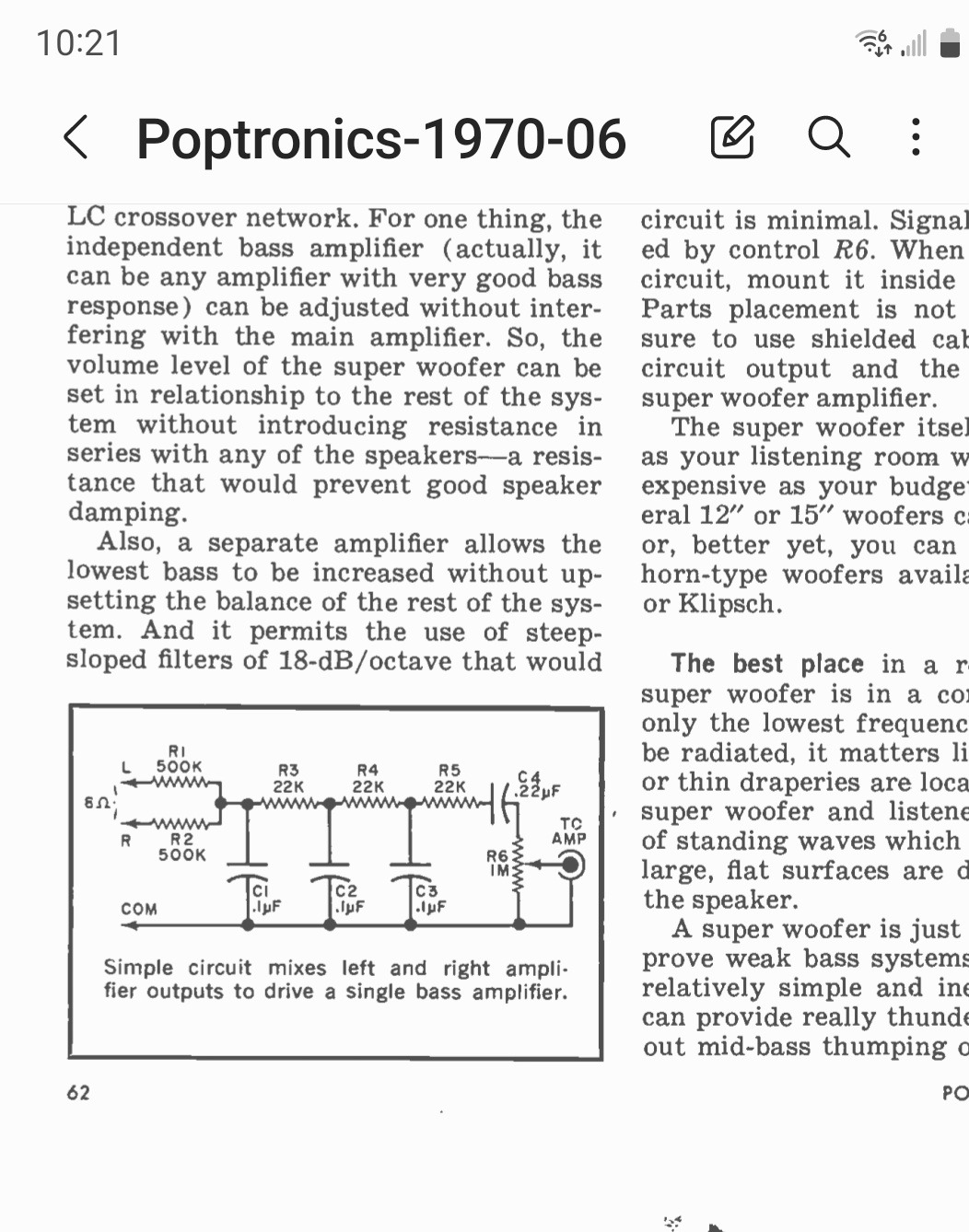

Go price out the cost of a 3rd order passive filters for this because 2nd order won't be enough and even a 3rd order is marginal IMO... there will still be audible mids getting through, and then look at what buying a used analog active crossover would be. Ebay has units like the DBX 223, Rane AC22 and soe others for about $100, these have 4th order LR filters and some also have summing options.
I would just add this on bryston input and be done.
