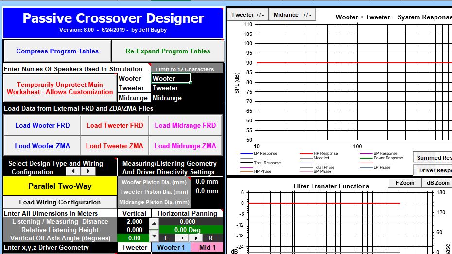

I'd like to chime in here. I have the same problem as the OP. Where other screenshots show save and load buttons, I have a button that says 'Temporarily unprotect main worksheet...' I cannot save and load parameters for the spreadsheet. Pressing the button does nothing for me. Kind wasteful to have to make a new spreadsheet for each project or variation thereof. I am using Win 10, Excel 2019, and PCD 8.0. I think this is pretty clear.

I'm having the same issue, but I would like to load some of the sample *.csp projects. Does anyone know a work around for this? Thanks.
The only way I know to use the session files (*.csp) is to use PCD ver. 7. The session files were created very early on in PCD when memory was scarce on PCs. The session files are very small (~ 1 KB) and made sense back then. As time went on and memory got cheap people simply saved the entire .xls file instead since the .xls file included everything (.frd files, etc.) while the session files only included crossover information. So Jeff removed the session file buttons from PCD ver. 8.
PCD ver. 7 runs OK on my Win 10, but others have reported problems. Running it in compatibility mode may help. Another option is to run an older version of Excel in a virtual machine (VM). I sometimes run Excel 2003 in a Win 7 VM for older Excel programs that won't run under Win 10.
I don't know if there are any plans to support PCD in the future. The program is password protected and I don't know if Jeff shared the password with anyone or if anyone is willing to take on the task.
I attached the PCD ver. 7 self extracting .exe file, but renamed it to .zip so I could upload it. Download the file, rename it from .zip to .exe and double click to extract the .xls file. Hope this helps.
