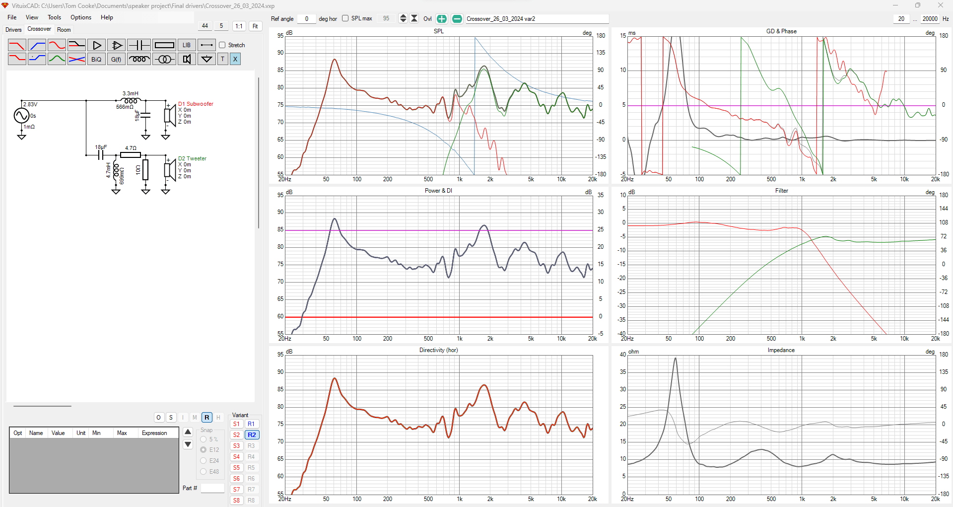

This is a crossover design that I have made for a DIY 2 way speaker cabinet (one midwoofer and a horn loaded tweeter). Admittedly I don't know too much about the designs of crossovers so the SPL response may not look the best but I'm happy enough with it as it is my first speaker design! I'm going to be simulating the design in LTspice to see how it runs but I'm not very familiar with the software so I wanted to see if anyone who has used the software before and had any handy tips. I'm going to be running the speakers with a T amp e 800 which is rated up to 8ohm, but I can see spikes on the impedance graph that go above this, is this a bad idea and will it overload my amp? Or are spikes like this common place in all designs? Any help is greatly appreciated
These impedance peaks are perfectly normal and won't do any harm. If you had impedance troughs far below 6 ohm, those might cause trouble.

On the contrary. Higher impedance is easier to drive by amps.and will it overload my amp?
Yes, definitely.Or are spikes like this common place in all designs?

Ahh I see so the aim is to stay above the amp's lowest impedance rating instead of worrying about overrunning the maximum rating?On the contrary. Higher impedance is easier to drive by amps.
Whatever you entered in vituxcad makes no sense. Even more crazy to even consider LTspice for speaker building.
The best advice one can give you: Get a book about speaker construction and stay away from building a real one until you understand your mistakes.
If you need to build something physical, get a well documented kit and build it as described. Don't get creative, just stick ro the plan.
You amp doesn't care about any impedance peaks as long as you stay over 2 Ohms. This is no problem at all.

Some good advice, all of my progress (if you can call it that) on vituixCAD so far ha been based of youtube videos and a lot of guess work as to what would work best. Have you got any recommendations of books that would be a good place to start? Most likely something like a dummies guide to speaker building would be good as I'm starting from no experience in the field. I've now swapped over to using a plan made by celestion which is purpose made and I will be sticking to for sure! I do want to have more freedom to design my own cabinets in the future though so any knowledge I can gain I would definitely leap at getting!Whatever you entered in vituxcad makes no sense. Even more crazy to even consider LTspice for speaker building.
