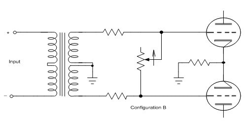

Hello and thank you for your reply.
Yes sorry that was not very clear of me. The link posted in that thread is below, I have attached the schematic from the link however whch shows the wiring. two matched resistors on each + and - line and then the pot wired as a variable resistor between the - and + lines of the balanced connection. no connections to ground.
It is only the volume control part of the diagram (excluding the valves and transformer) that I was looking at making as were the people who were discussing this in that thread from 2013 also.

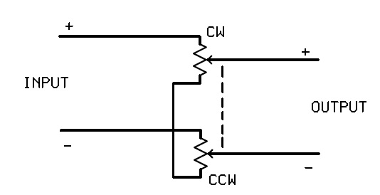

You now show us two different circuits.
For the first circuit the output impedance will be 'pot resistance setting' in parallel with 'sum of series resistors' - assuming small source impedance. The output impedance peaks at maximum volume. Minimum impedance will be zero at zero volume.
For the second circuit the output impedance peaks at pot mid position (mid position in resistance, not necessarily pot travel). It will be equal to 'pot resistance'/2. Minimum impedance will be at max or min volume.
Heck, sorry! I uploaded the wrong attachment, I was supposed to upload a simplified version of the first attachment showing just the variable resistor and two fixed series resistors.

If designing this passive monitor control to have the least negative influence over bandwidth and signal transfer from source to power amp, do I need to be mindful of the output impedance from the POT wired as shown in the first attachment?
Or, is it really just about checking the impedance that the source sees looking through the passive monitor control and into the power amp? As long as there is a good ratio here, say 1:10 or more, does this output impedance figure in isolation matter at all?

The output impedance matters because it is that which drives any cable and the input impedance of the amplifier. Two issues:
- cable capacitance (plus any RF filter at th4 amp input) - this can degrade HF response
- amp input impedance - in some cases this can be nonlinear and introduce distortion
You have 75R source, and 94k load. The impedance to aim for in the middle is thus around 2-3k (= sqrt(source x load) ). You have some leeway on this so perhaps a 10k pot would do, with 2-3k series resistors. Of course with a shunt pot like that you will have attenuation even at max volume.
