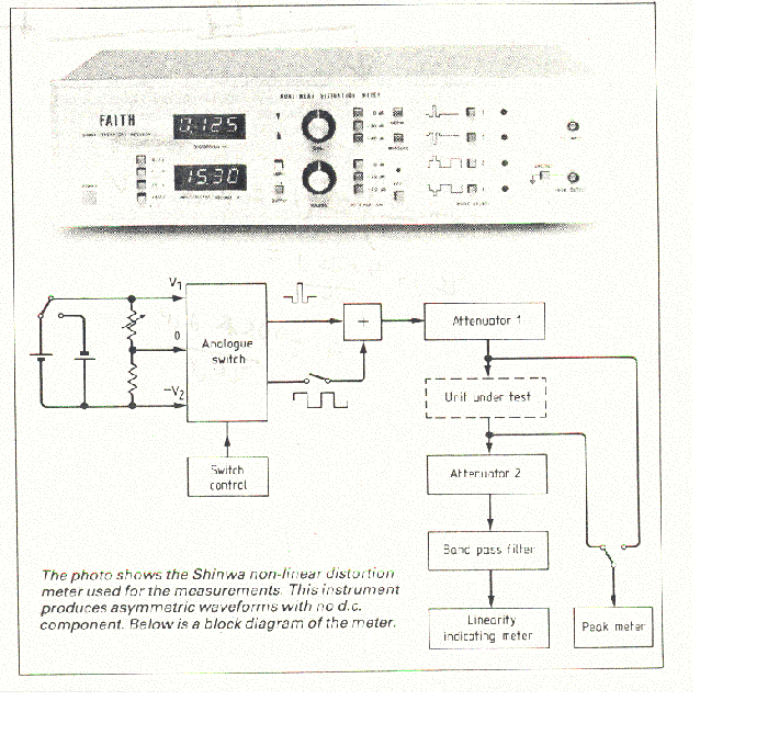

In the 70's (maybe early 80's) Sansui developed an interesting
TIM test, where the amplifier was fed a series of triangle waves
alternating between a sharp rise and slow fall and then a slow
rise and a sharp fall. TIM resulted in a DC shift in the amplifier
forming a square wave with a period corresponding the the
frequency of the alternation of the triangle wave.

Degeneration resistor and distortion
Thanks Mr Pass! Is this method of measuring DC shift similar (even if the waveform used is different) to this one below I found in E & W.W. of 1981? By the way, in this article they have measured the Threshold 4000 and found it good in that manner compared to 3 other models.
But is there a common standard (other than THD and IMD) that is used to compare amps?

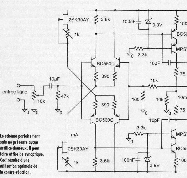

Regarding the degeneration resistors isn't it true that too high a value will change the distortion curve in function of power level;instead of having a sharp increase of distortion only close to the clipping level, the distortion would begin to rise at lower power levels but with a lower slope until clipping? If true, could it be caused by the reduction of overall feedback due to lower gain in input stage?

Have anyone Experimented with Re in differential?
What happens if we place inductor for Re, instead of resistor? Inductor have raising resistance with frequency.
What happens if we place resistor//with capacitor for Re? Like 1k//with capacitor. Capacitor has less resistance with raising frequency.
Or those experiment is dangerous, because to oscilation possibilities?
lumanauw said:Have anyone Experimented with Re in differential?
Having 1k//with capacitor: it depends of cource of the capacitor value. I have already used that scheme to polarize a j-fet input stage with a very low cut-off frequency so I would have the stable gain I needed for the whole audio range. Here in a BJT differential pair, there is no need for that unless, if I understand your point is to vary the gain of the input stage against frequency. At low frequency (where C is seen as an open circuit) you would have a gain of about only 1.8 in input stage ! This is too low.
The amount of overall feedback of the amp would increase as frequency increases. I would tend to believe that oscillation problems may be hard to solve.

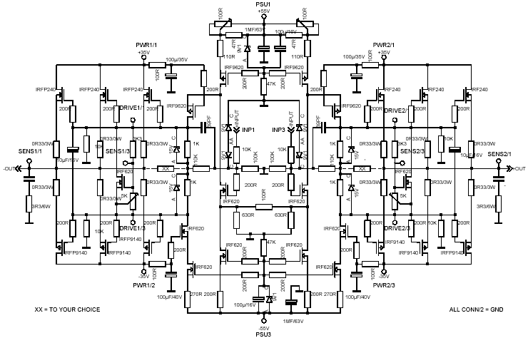

Uli published this circuit in the thread “normal X-Amp”. I’m surprised, it got little attention. I believe it to be very close to the x600 and 1000x. The amp uses one more cascade in the signal path then the x600 and x1000. That is an improvement. The one short full of this amp compared to those smaller X-amps is that it needs a balanced input. It’s not hard for us diyrs to build a balancing preamp for this amp.
Some changes we talked about, that Uli is trying is to remove the 100 ohm magic resistor for even more X effect and removing the 100k ohm resistors on the gates of the Input mosfet. I don’t think you need the RC networks on the outputs of the amp.
If NP or any others know of any other way to get better performance out of the circuit, let me know.
