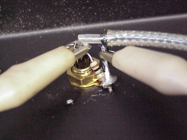

Imagine a wire between the two white clips.
Don't pay attention to the resistor in the picture.
Connect as shown.
Now your one input is shorted to ground.
Short the humming channel, then the other, then both and listen if you hear any difference.
/Hugo

Pass lover said:
Final question, there is only hum noise from the right channel, so I just ground only one right RCA interconnect?
Yes, you can do this one channel at a time. The point is to
evaluate the noise not connected to a source. At the same time,
an open input will pick up stray noise, and so is shorted to ground
to avoid that.
