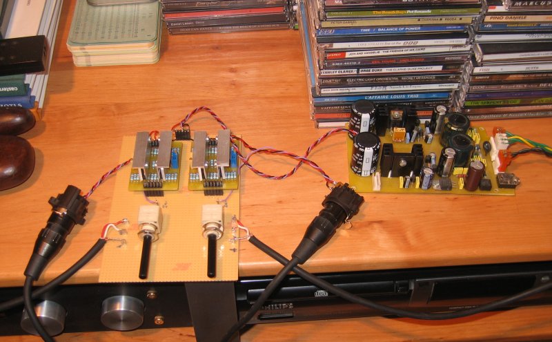

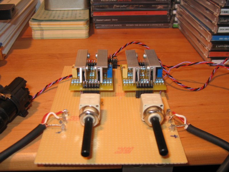

My completed schematic
1.Balanced source. (convert from Function Generator)
2.Balanced input module without de/increse gain.
3.Se input module with 10k potentiometre
Many guys mail me about my posted @ solidstate, Yes it's same schematic.
I have some problem with simulation when I use ZVN/P 3310 instead IRF610/9610 it's has more DC out on (drain+drain) output (0.5-1V) or I'll change source resistor from 1k to 221 ?
Help me please,I used 10.48mA each IRF610/9610.....too much ?

Is there any way to not-use K389-J109, replacing with other "easy to get" transistors, without sacrificing the performance?
Haven't tried, so can't tell about better or worse performance. And you'd better match the fets.
I would be very lucky if I even can buy the non matched parts😀 I still have K389 BL's but don't have any J109(GR or BL or V or anything)And you'd better match the fets.
In my fuzzy memory, Mr. Pass sometimes ago (very long ago) seems to write it is the OL gain + CL gain + feedback ratio that matters very much. This is when he was asked why he uses Mosfets for X1000 and X600, and uses these UGS Jfet modules for smaller X amps.
Since I'm still learning, is it true that these ratio's that makes the "sound", not because it is built by Jfet or Mosfet or Bipolars?
