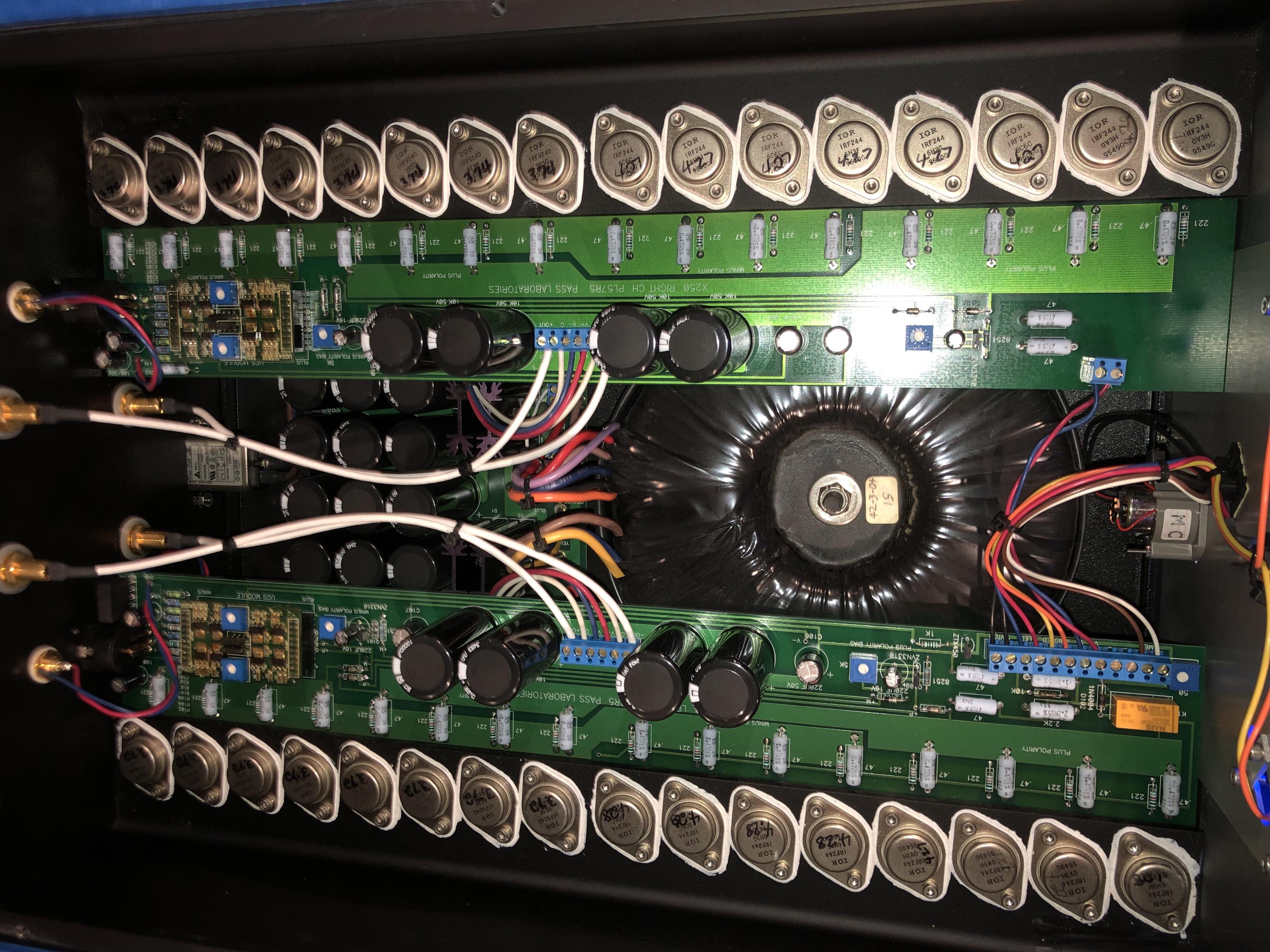

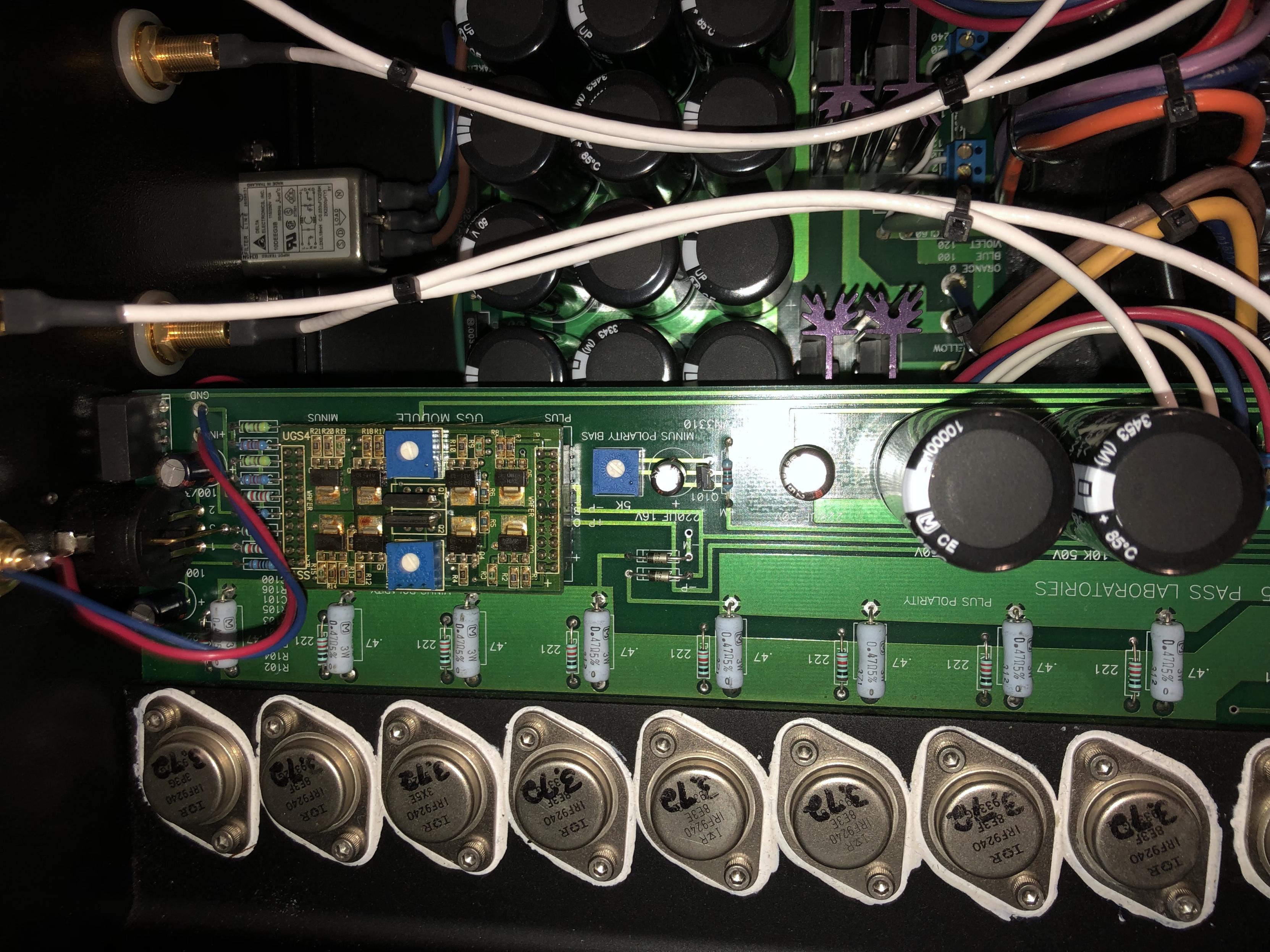

This is my first post here so bare with me as I’m a somewhat newbie when playing with electronics. So I noticed my Pass Labs X250 seemed to be running on the cool side and not really getting warm to the touch. So after reading a ton on the subject I decided to adjust the bias a little using this forum and a couple other places as a guide.
I adjusted the bias pots to make both heat sinks hold at about 48 degrees which is stated in the manual for this amp. I then read to adjust the differential and absolute dc offset before putting everything back together t make sure everything is on the up and up. This is where I have run into a problem.
I successfully set both differential offsets to 0 plus or minus a few mv but when moving onto the absolute offset I only got the right channel to go down close to 0. The left channel with the pot turned all the way is only going down to about 1500mv or 1.5v. Does anyone have an idea where I may have messed up?

if you did similar procedure as explained here : Pass Labs X150.5 , checking/adjusting offsets ,Iq and gain | Zen Mod Blog , then you did OK
1V5 is practically not cutting anything from allowable voltage window for output swing , so you're good
however , keep an eye on it in future , if it drifts up , time is for at least change of caps and maybe even something more

60mV is ballpark value - also confirmation that electrically everything is OK
primary thing is heatsink temperature , and with voltage across source resistor you're confirming that all 4 quadrants are same and everything is OK
so - confirm uniformity of voltage readings , then you're sure that you have necessary symmetry
channels must be same temperature , when electrical readings are the same
if they're not of same temperature , and you don't know why , some puzzle is missing

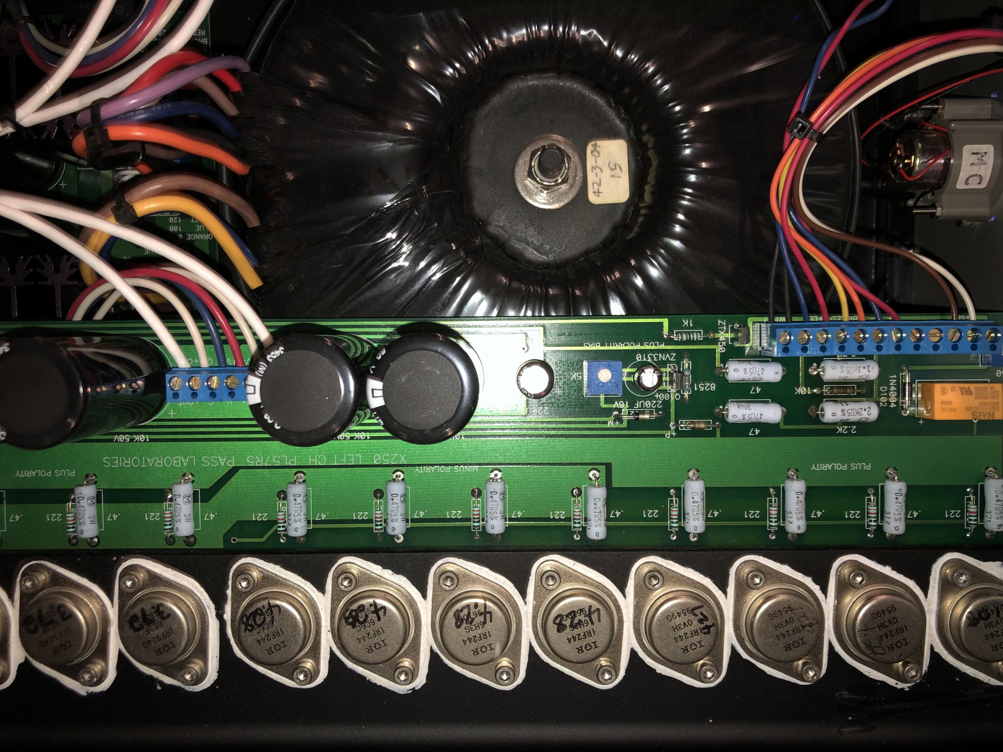

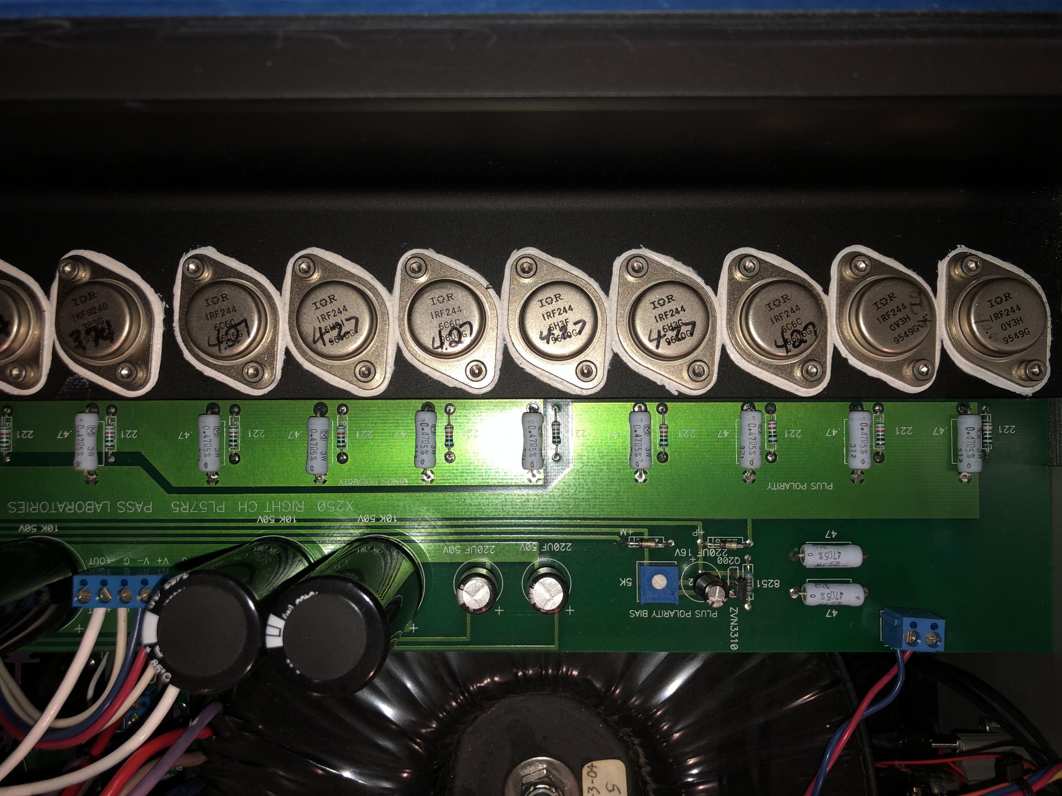

Alright guys, I turned the amp on this morning and after about 2.5 hours I took some readings and here is where it is at right now.
Left Channel: temp 49C rear resistor 52.1mv front resistor 55.2mv
Right Channel: temp 48.1C rear resistor 60.1mv front resistor 57.1mv
Should I still try to get all four closer to 60mv? By the way when you say make smaaalll adjustments you meant it.

that's close enough
when you are there , check tightness of all Allen bolts at output transistors - they need to be all nicely and evenly tight
