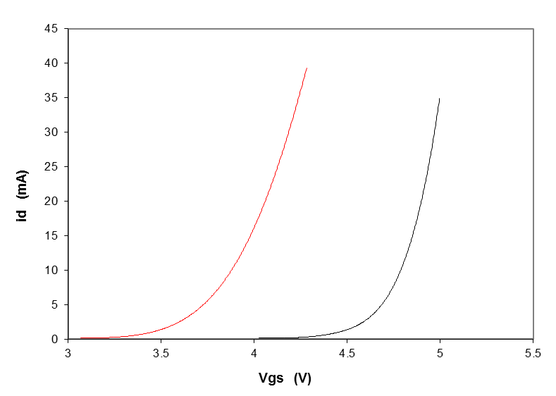

Here a comparison of devices in Spice.
(I know it is not 100% reality.)
Seems that low capacitance is not everything.
Transconductance also counts in a circuit with global NFB.
Patrick

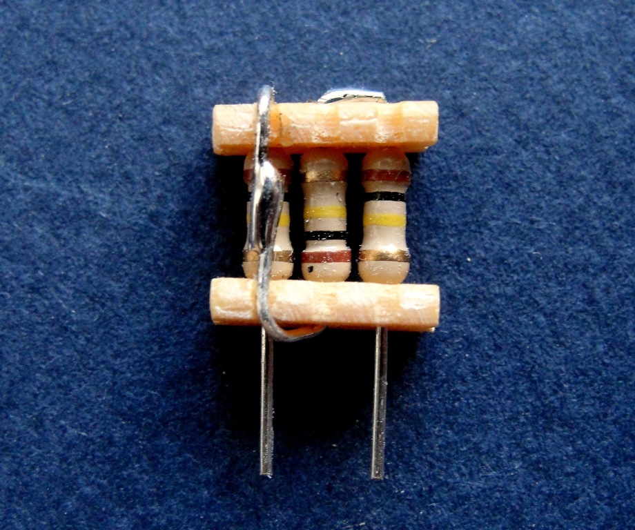

Here is a quick and simple method to make 3x RN55 fit into a MK132 footprint.
Patrick

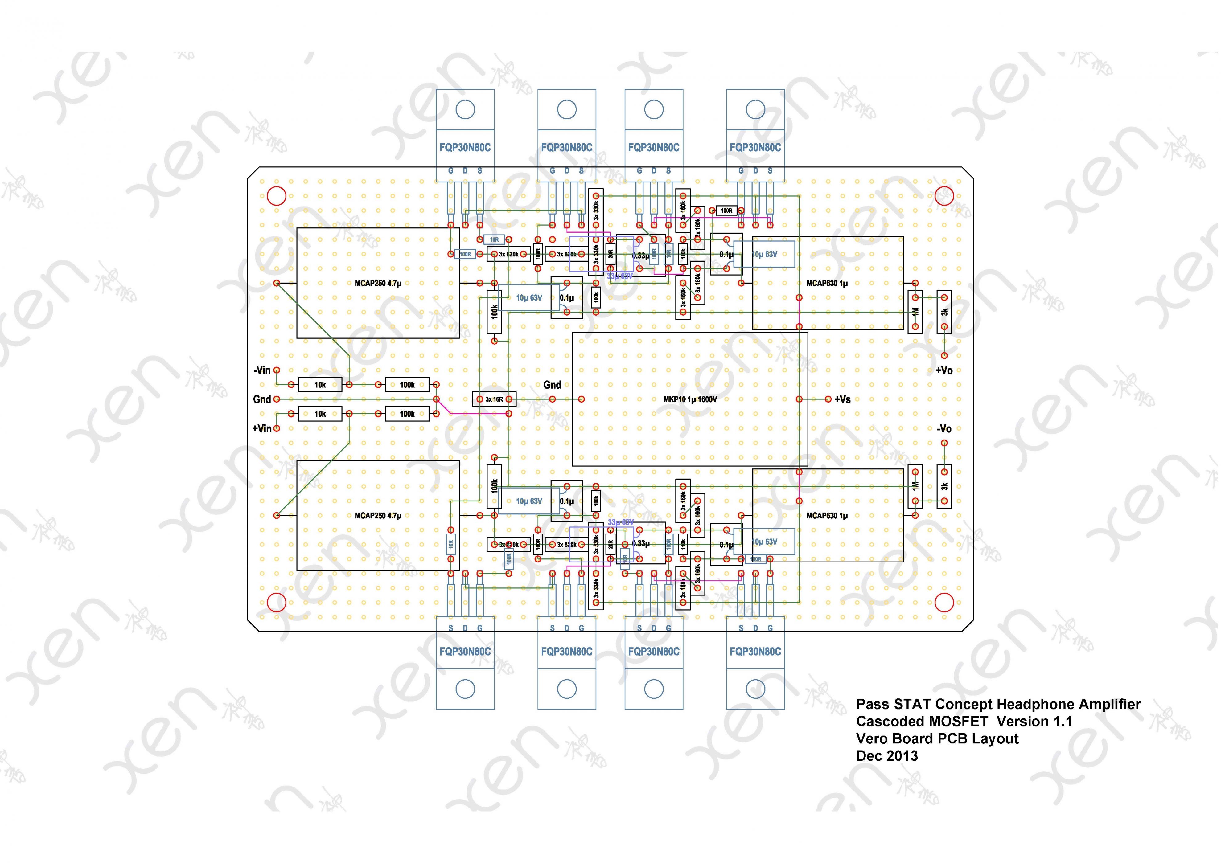

For those who wish to try out the circuit (with whichever MOSFET), a proposed P2P layout.
Black is component on top side of Vero Board.
Light blue is component on back side.
Dark green is normal wiring (silver plated copper).
Magenta is insulated jumper.
For the input / output coupling caps, you may use any MKP like WIMA MKP-4 or MKP-10.
The input caps want to be 4.7µF minimum, and any voltage above 63V.
The output caps should be 1µF 630V minimum.
Both should have 27.5mm lead pitch if using WIMA MKP10.
Shown here are Mundorf MCap footprints.
Patrick

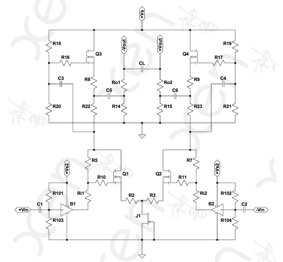

In a parallel discussion here :
http://www.diyaudio.com/forums/planars-exotics/248210-hv-transconductance-amp-idea.html#post3763764
I mentioned that the STAT concept is in essence also transconductance.
One can increase degeneration and add an Riv and an output buffer to make it zero global feedback.
Well, I could not resist the temptation.
It can be done without too much difficulties, and distortion though higher as expected is still very decent. (<-80dB at 1kHz).
And if this FET becomes available eventually :
http://www.diyaudio.com/forums/planars-exotics/248210-hv-transconductance-amp-idea.html#post3763765
http://www.onsemi.com/pub_link/Collateral/ENA2236-D.PDF
then a simple follower buffer should not be too difficult at all.
Or one could use the ixtp01n100 suggested in post# 13.
Patrick

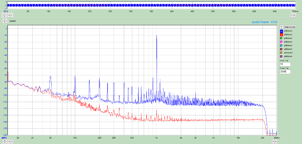

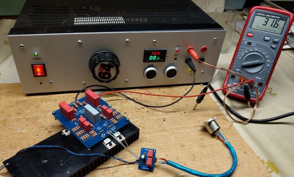

It has taken 9 years and a complete revised design to get to a working prototype. 🙂
This is just the first shot with no proper HV regulated supply, etc.
But it is alive and kicking.
We'll start a new thread once we have done all the optimisation and are happy with the final results.
Patrick
