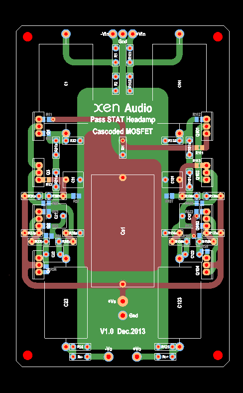

Patrick I would look at the voltage divider on the mosfets, make that lower impedance. High impedance make it susceptible to deviations on transients.
Jan
Jan
How low, factor of 5 ?
That will also increase dissipation and cap size (not that it is an issue).
Patrick
Patrick
Just changed as you suggested (5M->1M, 500k->100k, 10µ->47µ, etc.) and checked frequency response in Spice.
No apparent benefit. Frequency response remains identical.
So the limits were set somewhere else (feedback network fro upper limit and mu-follower bootstrap cap for lower limit).
The FET has really very low capacitance.
I think no change for now. 🙂

PCB first draft.
Since the active devices are so low cost, one can afford to spend on the passives.
Resistors are e.g. Caddock MK132 & Susumu 0805 thin film.
MK132 is rated at 400V 0.75W, compared to most axials like RN55 which are ~200V 0.25W.
And they take less footprint as a bonus.
Patrick
Patrick

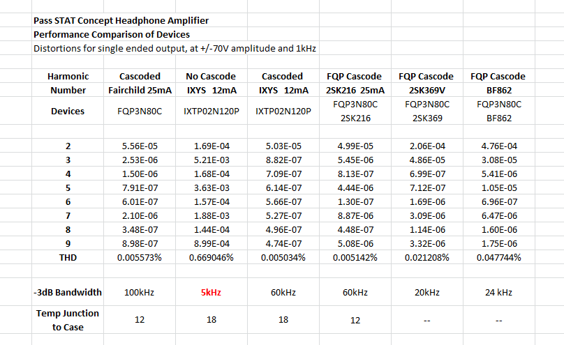

Ixys ixtp01n100 with lower parasitic C, is better sized for ES headphones which really only need ~10 mA/side and is depletion mode which simplifies bias of the pull up
and Papa uses the more correct form of cascode sometimes called hawksford/baxandall although the history is even deeper - http://www.diyaudio.com/forums/solid-state/166306-origins-baxandall-super-pair.html
but a side consequence of the better performance, higher Q, is a greater tendency to oscillate at RF - more elaborate Zobel/damping may be needed
Yes, I was looking at those Fairchild devices.
Sadly I am stuck with what I can get as samples for the moment.
FWIW, lowering the values of the resistors only causes for a higher power rating for them.
As long as there is enough current flowing to charge the Gate capacitance for your applied frequency, that is all that is needed.
If you are trying to produce a square wave then as much as 5 times more current is needed as per my earlier sim's is acceptable (hence 5 times the bandwidth).
Raising their resistance may hender the HF performance.
This is also effective when driving the ESL as well.
Because of this I try to design for at least a 100Khz bandwidth even though I can't hear this high.
jer 🙂

> Ixys ixtp01n100 with lower parasitic C .....
Nice FET indeed.
But 4x the price, and 4x higher thermal resistance ?
I think I'll stick to Fairchild for now.
I am not exactly short of bandwidth, and I'd like to have more current driving capability.
10mA is fine for 20kHz, but current consumption goes up with frequency, so does distortion.
Patrick
Nice FET indeed.
Patrick
with the 3 amp fairchild running ~ 1% of its rating you are spending as much or more current driving Q Cds than the C of popular ES headphones
cascode doesn't change that - only shifts which Q
much better to use the smaller die, lower parasitic C part, heatsink it well
if you look at ES project amp designs like Gilmore's Blue Hawaii, KGSS, KGSSHV, even the Stax T2 recreation - they all use <= 10 mA per side with SE, unmodulated ccs
I quite agree that >100 kHz small signal BW is good - but settling for just a little greater than 20 kHz power bandwidth/full amplitude slew limit really isn't a practical problem for real audio
after all vinyl playback, even with $k mc carts doesn't exceed 5 kHz power bandwidth/full amplitude slew limit - masters can't be cut hotter, styli can't track higher
2 Q in series cascade/totem pole - splitting the V equally is probably a better approach than cascode
the effective Q parasitic C is then nearly halved

Here a comparison of devices in Spice.
(I know it is not 100% reality.)
Seems that low capacitance is not everything.
Transconductance also counts in a circuit with global NFB.
Patrick
Patrick
