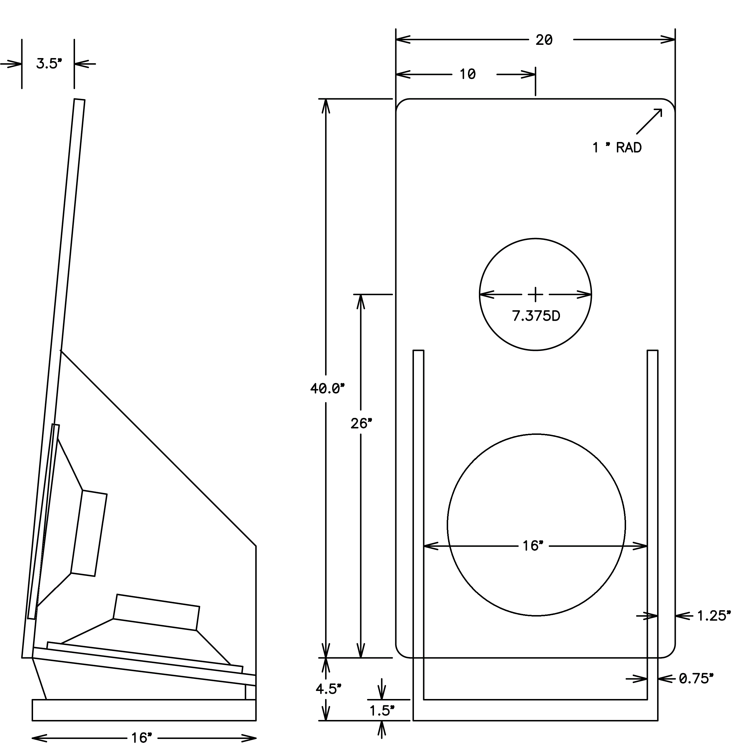

What is the theory behind the mix of front and down firing bass?

The slot loaded woofer firing down at the floor is an extremely efficient way to achieve extended frequency response into the low octaves say between 20Hz to 40Hz. This is normally very hard to achieve on a narrow baffle. So this is a bonus.
However the vertically firing woofer gives more accurate reproduction of bass notes. Sound closer to the real instrument.
Combine the 2 and you have the best of both worlds and touch would get rid of my digital Eq.
I like getting rid of stuff. Hahaha
Besides all of that 2x15" more faithfully reproduces the full dynamic weight of bass and percussion instruments.

The problem is. You want a narrow baffle, which ordinarily will destroy the frequency response, so hence the addition of the down firing slot loaded woofer.
Adding 2 x 15" (it could be even 2 x 12") is what it takes to reproduce the dynamic weight of drumming, percussion, and bass. If you play bass or drums you will know exactly what I am talking about.

Few questions:
-as Zen pointed it, driver coils must be aligned, not easy if I put a front 15", time alignment is crucial in OB?
-will my F5 manage two 15"?

time alignment is always crucial , but you can manage it in physical or electrical or both domains ........ goal being no difference in acoustical phase of drivers
F5 is good for 2 x 15"

physical seems more natural for me and as I've a B5 I wouldn't add components.
I will think about it....perhaps something like a short horn to set back the full range.

Would this work ?
Sorry for such newbie questions .
Three layers front baffle where the front 15" is set on first board and full range on back of the opposite one ?
