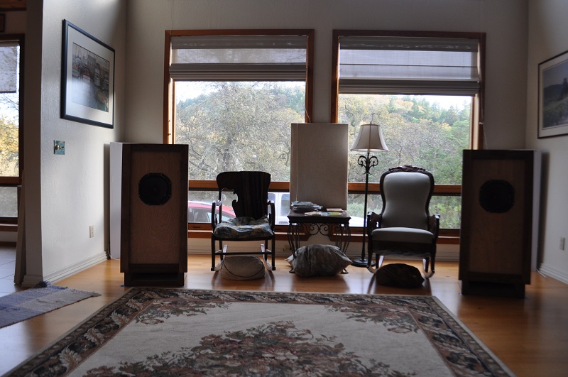

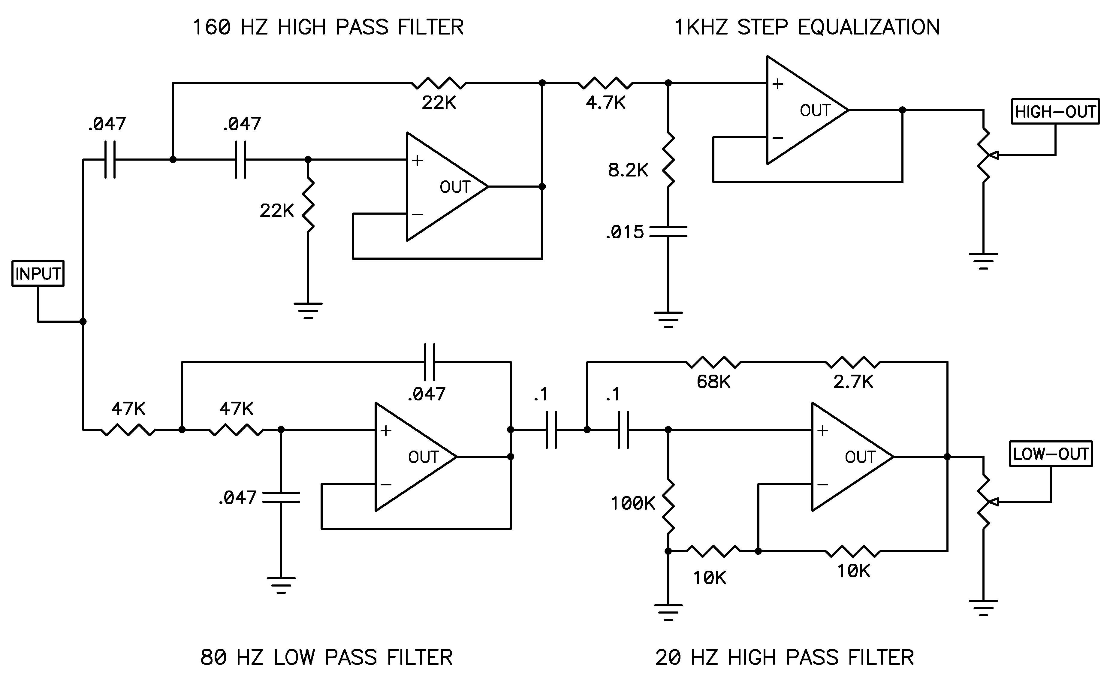

^^^^^^I'm headed that way also and just so happens I have the resistor module to cross these @ 100Hz and doing it now. You guys are great.
Depends what you're listening to. Just Imagine. Curtains drawn, fridge off, power @ 121v, no street lights for 5 miles, no other occupied dwellings within 1.7 miles. Damn quite around here, perfect for analog reproduction. And the listening chairs are out front of the baffles 11.764'
