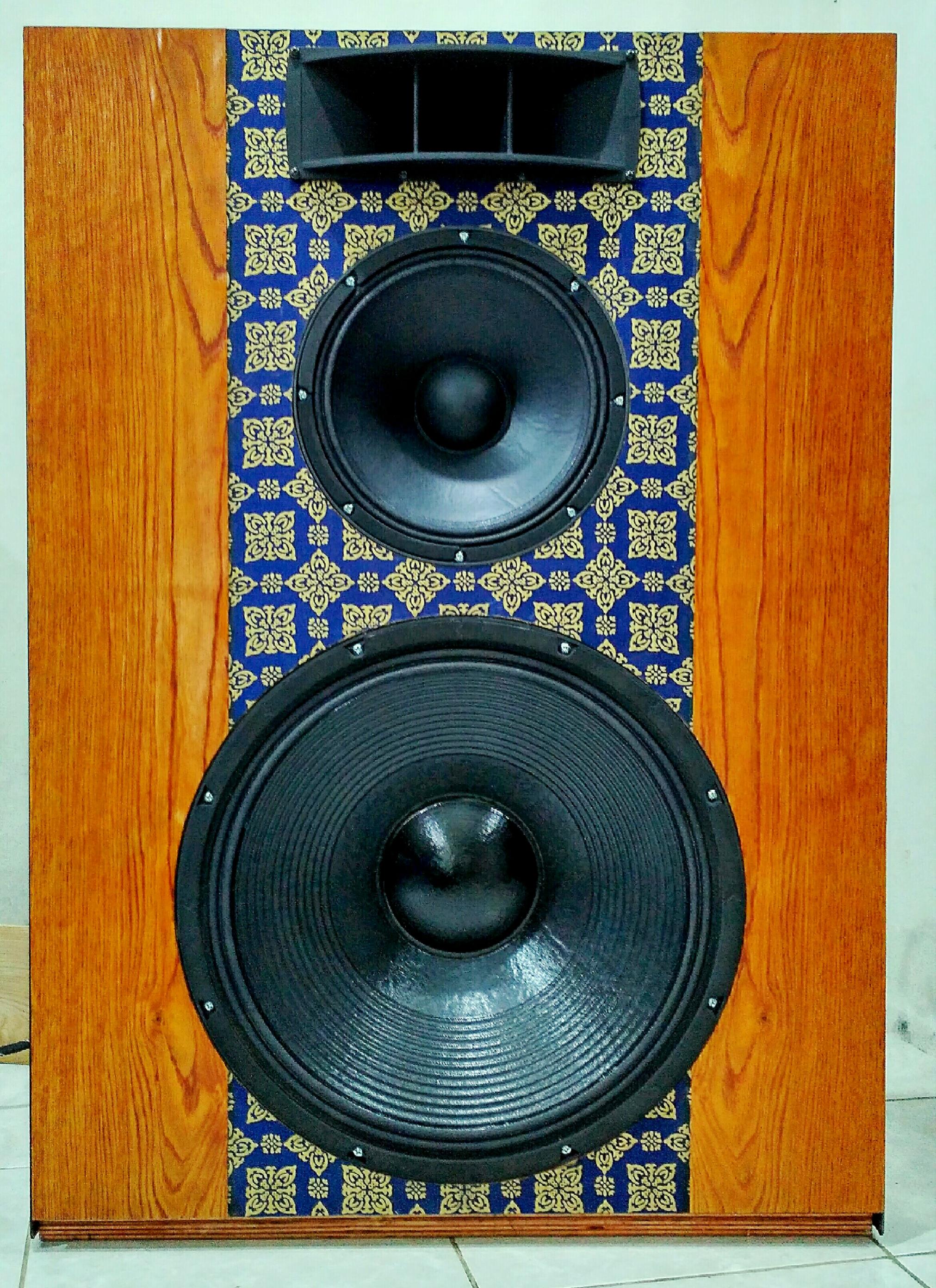

I have read several post for woofer OB selection and I'm not sure whether I understand it or not. Looking at ae dipole 18 which is regarded as high quality woofer for OB but still has a weak motor like eminence alpha. while my 21" subwoofer has twice mms but thrice BL. What i believe is that the bigger is always better for OB to produce low bass. since i will use active xo and bass boost anyway for the subwoofer, i dont worry too much now.

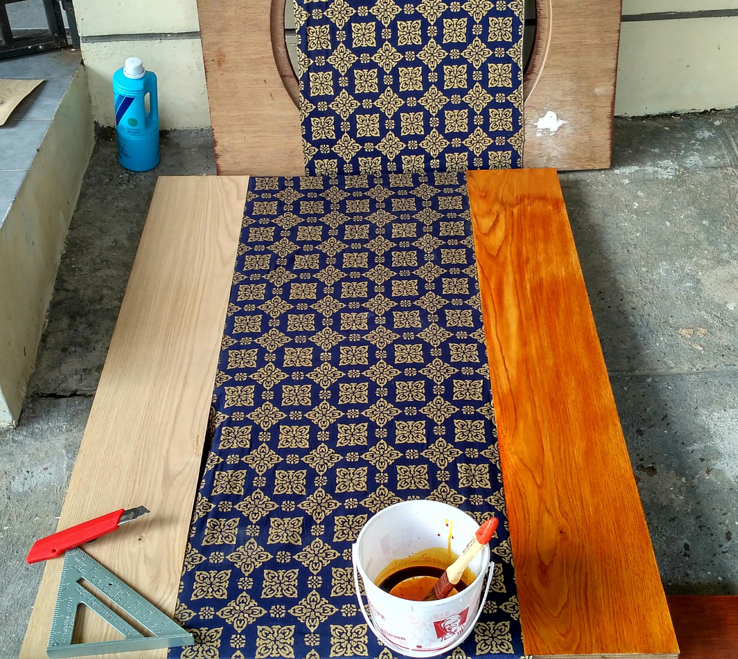

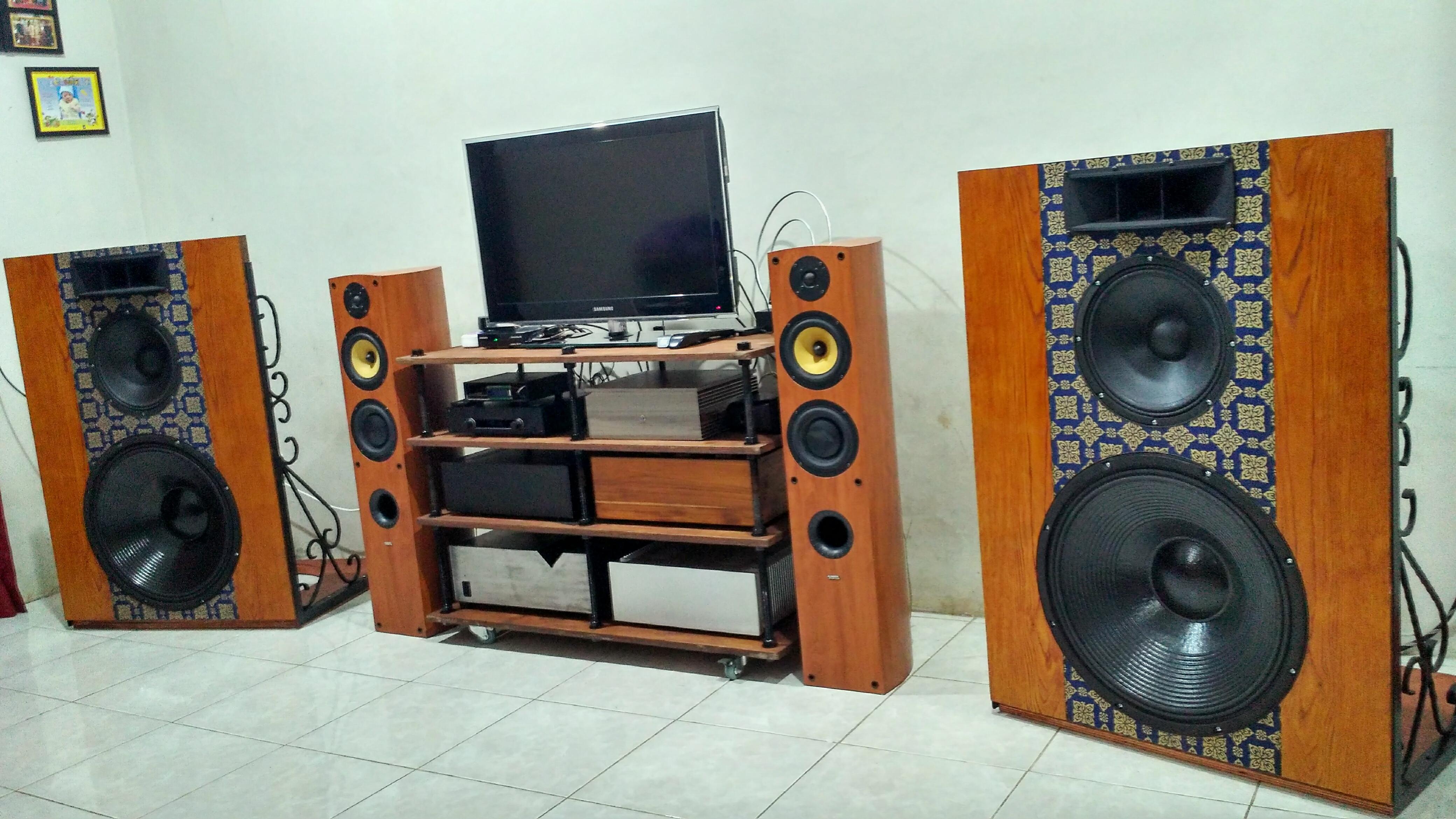

some progress, 2 baffles already cut and cleaned, 2 x 3/4" meranti plywood with 20kg each baffle. centre area is covered with Batik textile and oak veneer on both side. however plain oak + teak oil looks pale, i want contrast colour. I got inspiration from ak47 wood stain using Iodine, then i apply it on those oak veneer. 2 layers already give vibrant colour, i'll try until 5 layers.

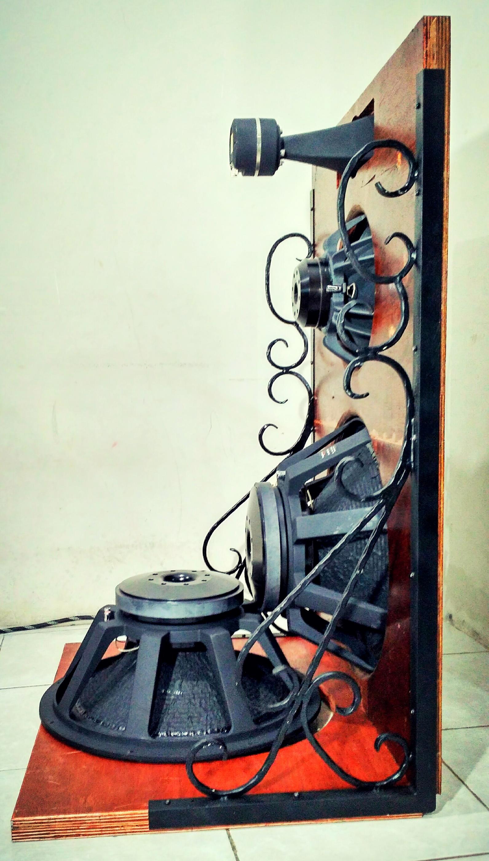

finally front baffle completed, but i forgot to consider subwoofer depth for slot loaded baffle, the magnet block each other. it seems i have to add another 6" to the back panel in order to separate them.
in 3x5m living room, i put audio video chain on 5m side, not ideal at all but that what i have.

Very nice work, Gadut.

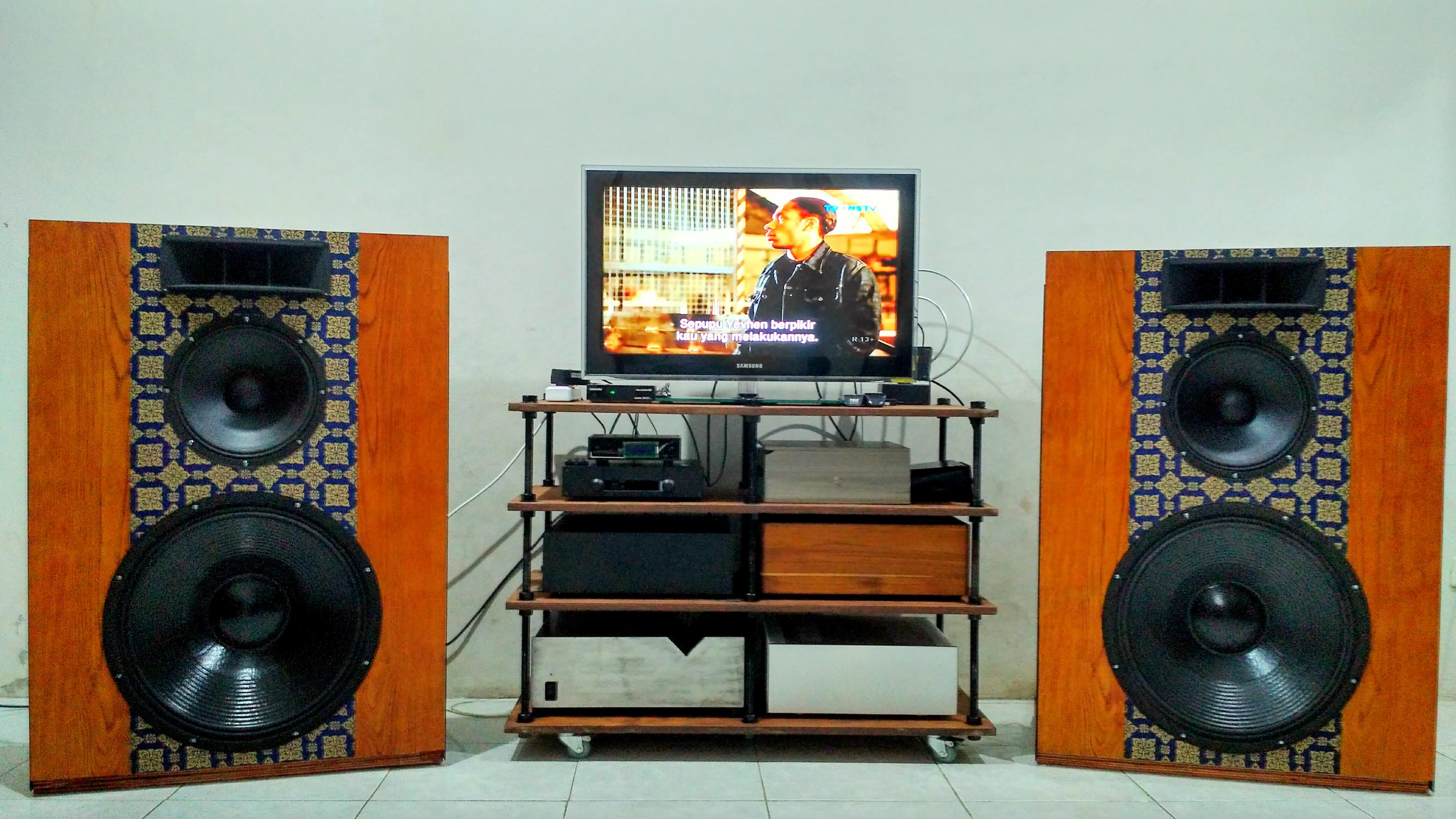

Many of us also have constraints. We do our best with what we got.
But I think you will need a bigger TV ! It looks so small between to the open baffles! 🙂
this kind of rubber feet already in my choice list, beside using thick carpet. but i'll have to hunt heavy duty rubber feet, with dual 21", in total each side will be more than 80kgWhat you think about mechanical vibration isolation from the floor contact ?

yeaa that 32" tv looks tiny now, 55" curve tv is already on my waiting list but this will be after i get another pair of 21" for slot loaded.Many of us also have constraints. We do our best with what we got.
When i was a child, i liked to play with the big drum which is always available on every mosque. The bigger will give me more fun to play with 🙂 the sound can be heard in the range of 500m - 1km.
How about some Volvo 240 engine mounts😉? Used to be cheap and should be easy to apply as feet.

i'll have to find the right one someday 😉How about some Volvo 240 engine mounts😉? Used to be cheap and should be easy to apply as feet.

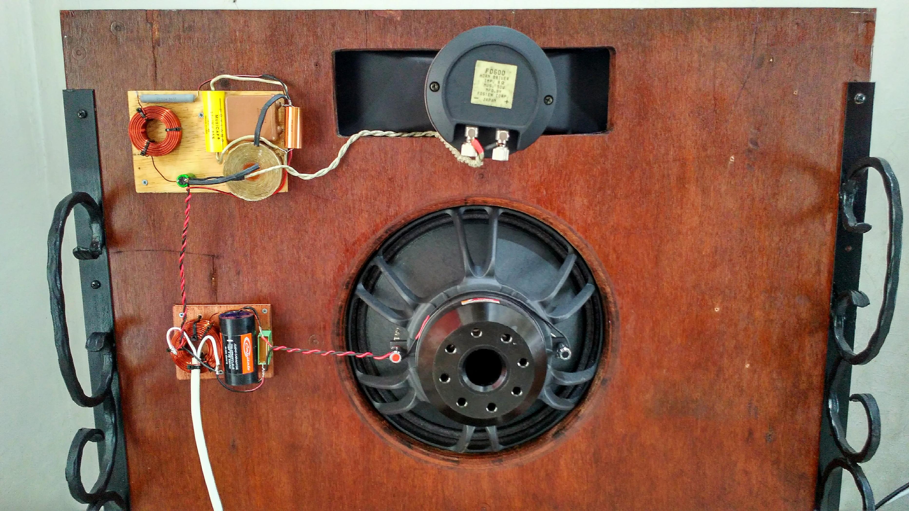

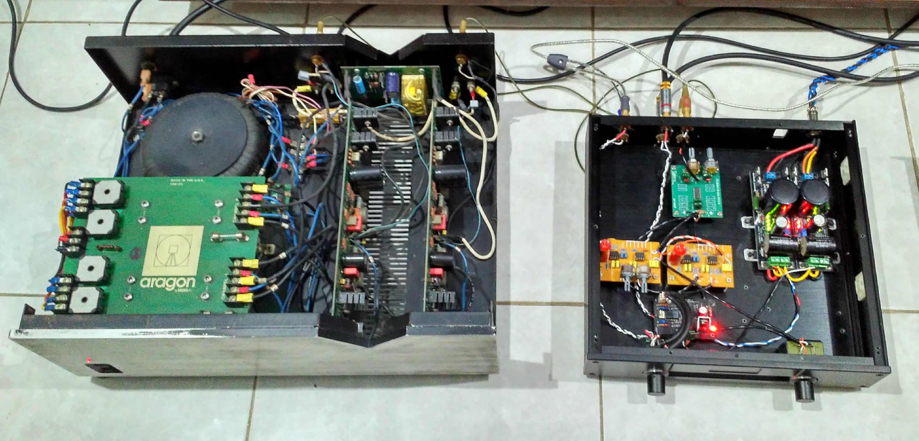

completed active xo opamp+bass boost for sub low, both of them have potentiometer to adjust cutoff freq (set to lowest around 60Hz) and 20Hz gain is set to maximum. the output is sent to aragon2004 to drive 21".
for 12" mid and horn, I'm using 12dB passive xo LPF 1.1kHz and HPF 2.2kHz.
Already listen for 2 days on good audiophile recording and I'm blown away when they are pushed to play very loud but no sign of stressed sound. and yes with thick carpet on bottom OB, I can feel that the floor is shaking on deep bass.
But when I listen to standard pop album (Celine Dion -
Let's Talk About Love) is a sample of good singer but recorded badly. the biggest issue is the dullness, where previously i always use EQ on foobar for last 4 octave.
Then I reminded on jbl gto 19T 3ohm car tweeter that i used previously to accompany alpair 10p, it has a crisp treble that i really like but lower sensitivity 93db compared to my 104db horn. I can't hear anything coming out from the jbl when connected in paralel to horn.
I can feel the benefit of having multiple amplifier now, with J2 clone 20dB gain that power mid+horn, i have mauro penasa gainclone 32dB gain that will match horn and jbl level with 3.3uf caps filter. Now i do not miss any high treble anymore 😀
